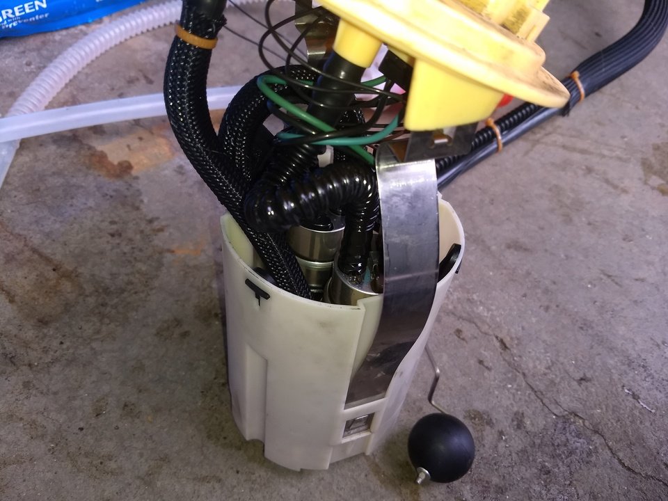

    Gas vapors are not explosive, they still need oxidizing agent, which you can't find in a normally operating gas tank. Otherwise you'd bee seeing a spectacular action movie-grade blow ups on the roads very often :)
    Fuel pump needs some gasoline. It has a container where it is fully submerged in fuel even when the fuel level is generally low in tank. The problem with cooling starts to materialize when the pump can't have enough fuel to suck into the container, which commonly happens when vehicle accelerates/brakes/turns or moves on the slope.

    I'm genuinely curious, does it actually endure more or less wear with this method? I mean it is enduring wear during each trip to and away from the pump and those minutes of run time have to be taken into account somehow. Pretty silly I know! But technically speaking and depending on several factors, it could be counterproductive and your truck's pump may not always have serious affection for your behavior.:rofl::rofl:jk! :thumbsup: FWIW, I try to avoid completely filling mine up with hopes to avoid the fairly common check valve or rollover safety valve problem that seems like a major, but easily avoidable PITA to deal with.:crapstorm:

    So if we are speculating a little bit, from speaking with other more knowledgeable folks on the matter, I’ve surmised two real failure modes from pumps when they are run low. Though, they are kinda the same failure, but one is over time and one is more sudden. They both involve excess heat.
    The first failure is excessive wear over time from spending too much time in the hot zone. This happens when the tank is always or often run low and there isn’t enough fuel to adequately cool the pump. The pump doesn’t fail immediately, but since materials have a tendency to expand with heat, the tolerances change, parts move a little, and they wear in ways they shouldn’t because they self clearance as they heat up. Cycle this enough and eventually the tolerances on the pump grow enough to not provide enough pressure or to simply jamb when hot.
    As anecdotal evidence, I’ve had fuel pumps that worked fine in the morning when cold but would cause hard starts when warm. Fuel lines had pressure, but inadequate pressure to run the vehicle. Let it sit a few hours until it cooled off outside and it would start up and drive for 10 or 15 minutes before dying.
    The second failure mode is sudden, catastrophic failure - also due to excess heat. But this time, instead of inadequate cooling from low fluid level, it is simply unable to cool the pump. The pump parts expand too much, too rapidly, jamb or create excess tolerance, and die an ignominious death either on the spot or the next time you try to start it.
    Also more anecdotal evidence - I’ve had a fuel pump die suddenly on a hot summers day when I ran too far past E; it got me to where I was headed, but wouldn’t restart after sitting for an hour so it didn’t get me home. Pump was 100% inoperable. Took a ride on the back of a tow truck.
    I’d be curious to know if my theory is correct. Or complete bladerdash.

    I mostly agree, but I also believe there are human and manufacturing factors to be considered along with fuel chemistry and temps. Personally I like to avoid towing and or inconvenient repairs, so I generally keep some fuel in the tank and replace fuel pumps at about 125k. Don't remember ever being stranded from a failed fuel pump either. Where or how one chooses to aquire fuel is a whole entire other rabbit hole too!

    I would disagree that those failures are common, and would love to see any evidence that they are caused by overfilling the tank, much less just filling the tank. And you really preemptively replace the fuel pump at 125k?

    Okay, I will rephrase-too common for my liking. Yes, about 125k they hit my to do list and within the next 5-10k they are replaced because I don't wanna dick around when the weather might not be favorable, it might be dark, I might be traveling a substantial distance, etc. Cheap insurance IMO, also nice to know that I have a working unit on the shelf after it has been replaced.:thumbsup:

    You are the first and only person I have ever heard of doing that. I have never replaced a fuel pump in any of the vehicles I have owned over the last 45+ years of driving. Starters-yep. Alternators-yep. But never a fuel pump.
    Now that might also be an anomaly, but it certainly is not evidence that would make me adopt your approach. Curious if there other items that you do this with. Like the starter, alternator, AIS...? Seems like a complete waste of time, effort and money. In the end, it is your truck so do what you think is best.
