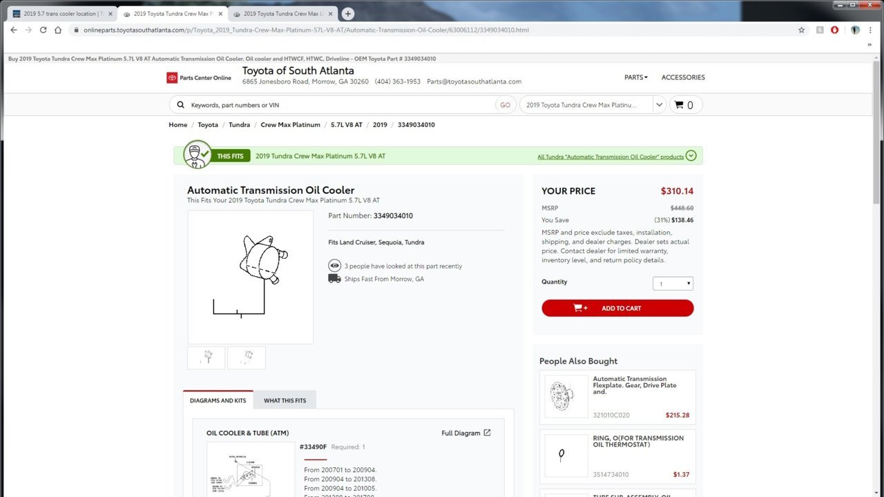

    Is this what you guys are looking for?

    This is the one we no longer have

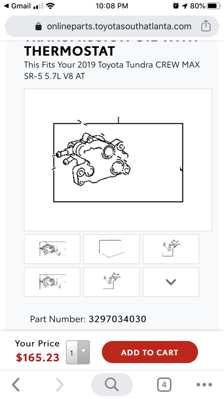

    240 at the pan. I havent checked TIS to confirm specifically about Tundras but on tacos/4runners and FJs the AT high temp light comes on at 300F. I have a few oil analysis reports on WS and Maxlife ATF from my 08 tundra and FJ and WS is nothing special with just average numbers. I contacted Valvoline via email about temps and they stated:
    “Thank you for your question. If the temperature of the transmission fluid reaches 280*F for a long period of time, the life of the fluid would decrease quickly, within a few thousand miles. The Valvoline MaxLife Dex/Merc ATF is a full synthetic fluid that will with stand temperatures above 280*F, but the life expectancy of the fluid would decrease slower than a conventional fluid.”
    So if WS is no better than Max(from multiple analysis reports from Blackstone) then 280 is where I will get worried, but I have my doubts about towing regularly and getting 100k out of this trans. And with no external atf lines, DIY flushes are a thing of the past. You will have to take it to a shop or do a pan drain and fill of 4 qts out of the 12 in the trans. Which just contaminates the fresh 4 qts.

    And their own parts system shows it fits a 19. But just not equiped. I have mine sitting on my bench and will go on my trans after warranty, sooner if need be.
