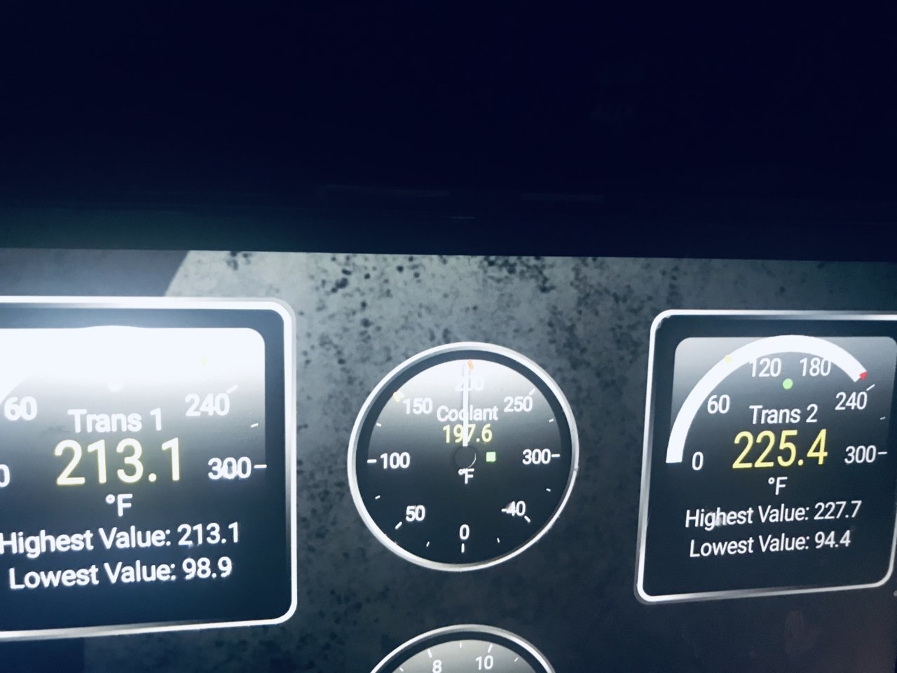

    Now back to some data feed , I am seeing the below temp driving with outside temp at 60 , let us say I wasn't quite gentle on the paddle but nothing crazy either
    Eric32444 likes this.

    And that is without towing , when I tow my TT 4200 pounds , I see 215-217 average on pan and same on torque , I tow on S4 and tow haul on , these are mainly flat and also going up some Vermont hills
