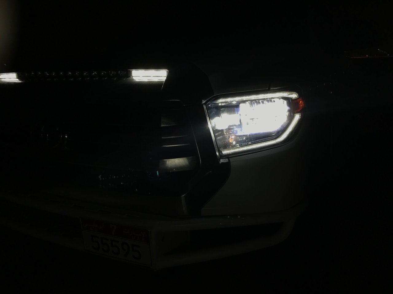

    hi guys ,
    At first I would like to thank @Roman for his effort and help us provide the headlights
    And also I want to thank @thomasbus337 for wiring harnes diagram :hattip:

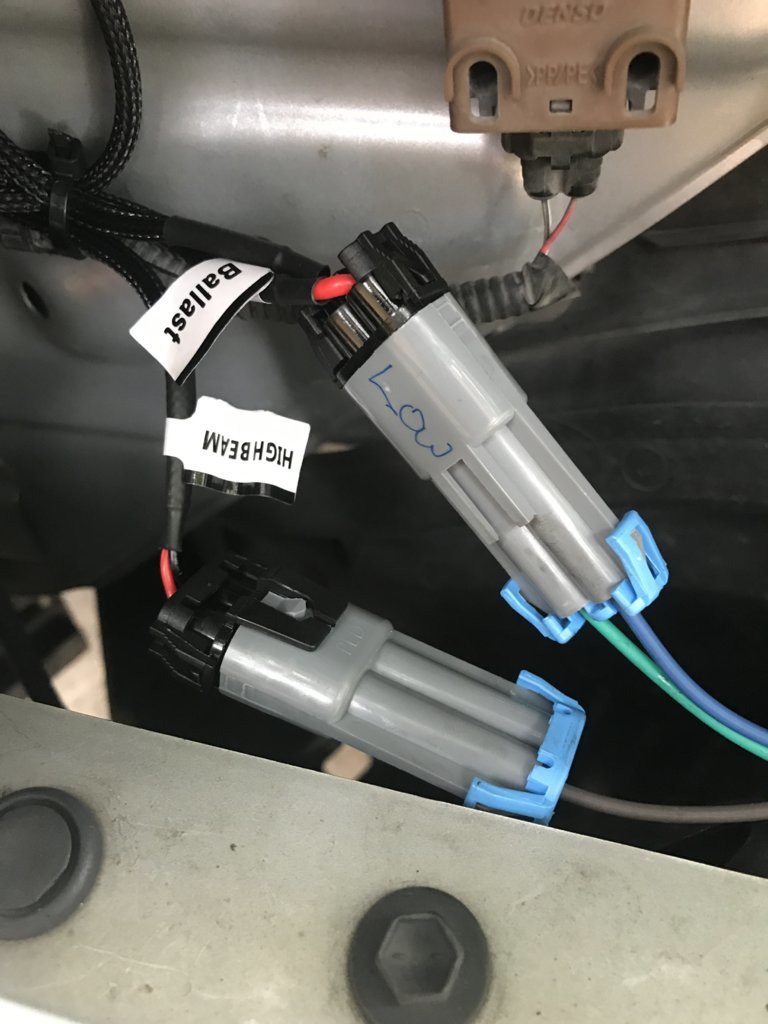

    image.jpg IMG_2260.jpg IMG_2258.jpg IMG_2258.jpg IMG_2258.jpg So I'm trying to install my harness but it's not working.
    1. My fog lights work, blinkers and side lights. No headlight high low or daytime lights.
    Any idea what it could be?

    Not sure if this is a possibility but are your grey connectors plugged into the wrong ends of the high / low connects off the marimoto? Did you try flipping your grey connectors to plug into the marimoto. The grey connector with 1 wire should connect to the "high" connector of the marimoto from what I understand about these harnesses
    From Blue Bottle
    "Only thing to make sure of is that the polarity of those grey connectors are correct. You can line them up with the Motocontrol toverify. Red is + and Black is -"

    @BlueBottle does this look right?

    The brown female plug from the tundra plugs into the Morimoto on the driver side, but nothing plugs into the passenger side brown plug. Correct?

    I believe there's only one of those brown connectors. Can you unplug your grey connectors and try variations of fliping them around (still on the same marimoto connectors, but literally 180*) to check polarity. Sometimes on HID harnesses for example the polarity is reversed so I've had to flip the connectors so the top side is now the bottom if that makes sense

    The Frey connectors only go in one way. The only thing I could do is flip the hi and lo. Tried it and nothing
