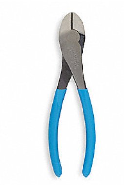

    I did this but opposite had the wife push with the screwdriver while I cut it.

    Is the easiest way, I did the same

    Good tips. I’m getting ready to do this again and cutting the nipple was the hardest part for me (harder than depinning the harness because I bought the depin tools iHacker recommends in the DIY post). I’ll have a helper push a screwdriver from inside the truck. Any tips on the cutting device used that made it easier? I used a raw razor blade but again, I had a heck of a time getting the nipple cut.

    The screw driver did this trick for me I use a long phillips screw driver from inside to the hood until the nipple breaks.

    I just used a utility knife.

    Ah ok nice, so just puncture the nipple with the Philips screwdriver...nice, thanks!
    Yea I struggles to get access. I did it, but it took me longer that I would have liked lol
    Good point. I have a small pair of diagnol cutters that will fit down there. Between this and pushing the screwdriver through, it’ll be easier this time.
