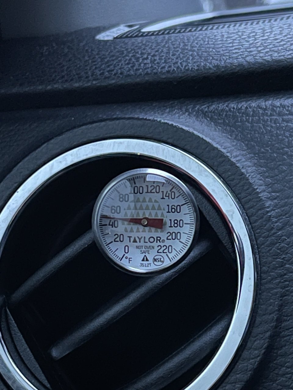

    This is my 2020 double cab after a 10 mile 65mph highway drive to work. Max AC, 50% fan speed, recirculate on, no sunlight, 75 degrees and high humidity outside.
    My 2010 crewmax, even with an auxiliary trans cooler in front of the condenser blows noticeably colder. I can’t drive all the way to work with the AC on the whole time without becoming an ice cube. Vent temp for the 2010 is usually about 40 degrees even on hot 90+ degree humid Florida days.
    I’m going to have the 2020 evacuated and recharged within the next couple weeks, and see if that makes any difference.

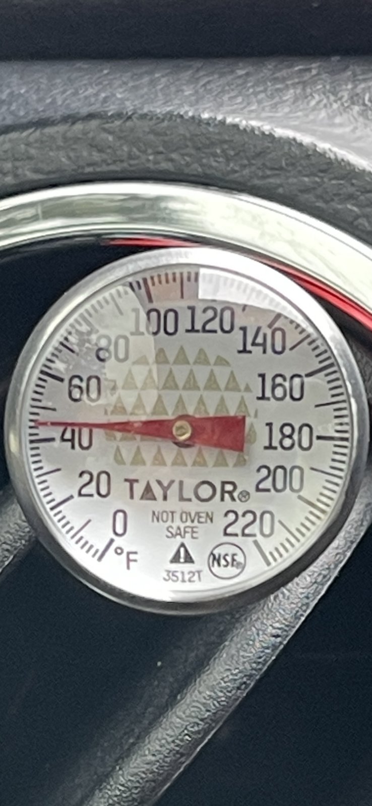

    So I was able to get my truck in the shop this last weekend to have the AC recharged to the proper amount.
    The machine recovered 476g of refrigerant, and 0.4 ounces of oil. The truck supposedly calls for 650g of refrigerant, and no specified amount of oil. But either way, it was pretty low. It held vacuum for 30 minutes and didn’t give any warning that the system has a leak. So I don’t know if it’s been low since the factory, or if someone has tampered with the system.
    So after adding about 3oz of 1234yf oil, and 650g of 1234yf Freon; the vent temperature decreased by a noticeable amount.
    Outside temp was 80 degrees, overcast, and high humidity, very similar to my previous post when the vent temp measured around 50 degrees.
