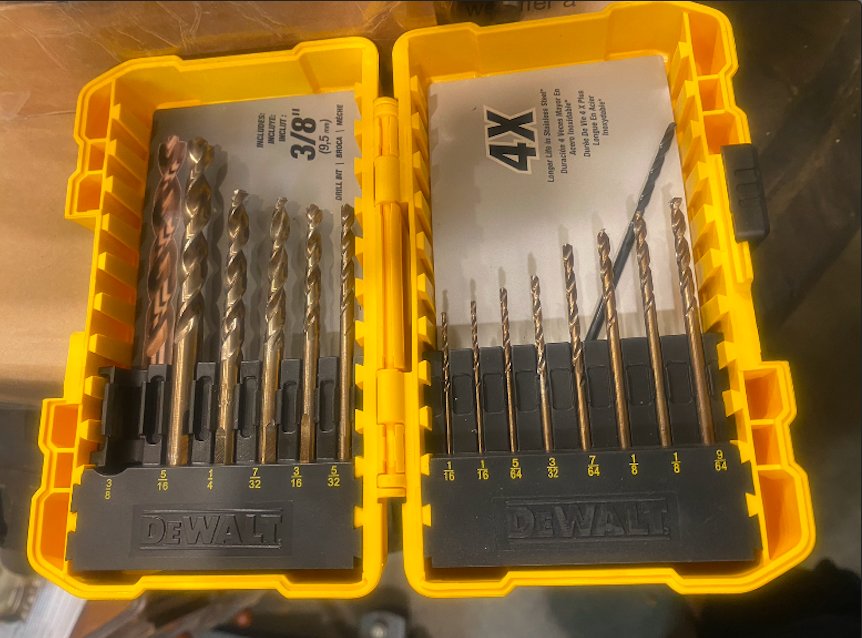

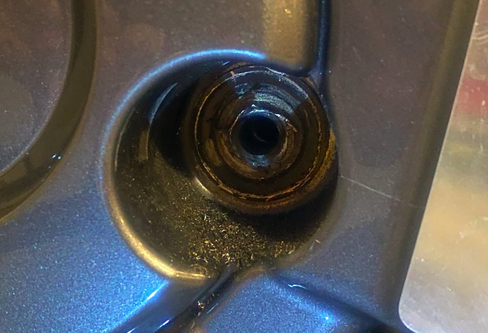

    Had a lug break off.
    Smaller sizes went through like butter, 3/8th seems to be doing nothing.
    I got the 3/8th through most of the way.
    I ordered a cobalt 1/2
    [​IMG] Amazon
    And this
    DEWALT 20V MAX XR Hammer Drill, Brushless, 3-Speed, Tool Only (DCD996B)
    [​IMG] Amazon
    My 14 year old 19.2 V Ingersoll Rands are just so long in the tooth.

    Drill and bit came, it's slow going.

    If you're looking for ideas...sometimes stepping up in drill bit size with the smallest increments possible is the easiest. 32nds or 64ths bits. Looks like you don't have drill deep, just get wider and wider until the washer part of the lug can be knocked off the remaining threaded part of the lug nut. Only need to go maybe 3/16" deep (whatever the thickness of the washer portion is). The bulk of the remaining lug nut can stay on the lug stud and the wheel will still slide off. Then go for heat and a vice grips once the washer portion, and subsequently wheel, can be removed.

    You can’t punch that out from the other side of the wheel?!? Maybe I’m confused………

    I went from 3/16th to 3/8th and just got this 1/2.
    I'm hoping to save the stud first off and I'm sure the stud would be harder to drill.

    Oh. It was hard to gauge what the strategy was. Appeared like a deeper drilled hole and I thought you had already reached and been drilling into the stud.

    It is actually drilled through. The top of the stud is somewhere below the end of the lug. I'm hoping to get the 1/2in all the way in.

    Got another 1/2" bit & oil, seems like it is going to take forever!

    Smells like VICTORY!
    Unfortunately I killed the stud.

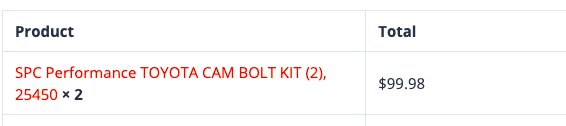

  16. Sep 9, 2021 at 6:55 PM
    #256
    farnsrocket
    farnsrocket New Member
    Feb 14, 2021
    #59103
    362
    Do those camber bolts give you more camber than stock? Are they #25450??
  17. Sep 9, 2021 at 7:15 PM
    #257
    e30cabrio
    e30cabrio [OP] I'm e30cabrio, I'm a modaholic
    Oct 20, 2017
    #10410
    6,674
    West Valley, Phoenix, Az.
    Boosted 2013 Sequoia TRD FAUX
    That is my hope.
    RCA garage had the best price & they are in stock/shipped immediately.
    farnsrocket likes this.
