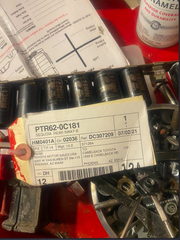

    Do you recall the part numbers for the rear sway bar? I’m in the same boat. Much appreciated
  2. Aug 12, 2021 at 9:20 AM
    #212
    e30cabrio
    e30cabrio [OP] I'm e30cabrio, I'm a modaholic
    Oct 20, 2017
    #10410
    6,674
    West Valley, Phoenix, Az.
    Boosted 2013 Sequoia TRD FAUX
    That is from the sway. ptr62-0c181

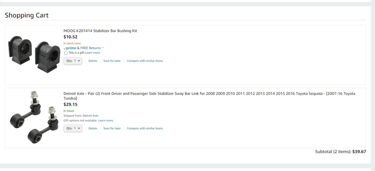

    My Apologies. I meant the part number(s) for the bushings/hardware for the Rear Sway Bar.
    Also from your experience, we have a Platinum. I know that you have a Limited, do you foresee any issues with the Rear Sway Bar?
  4. Aug 12, 2021 at 9:43 AM
    #214
    e30cabrio
    Oct 20, 2017
    #10410
    6,674
    Bushings & end links are standard items, I got them from Amazon. Moog bushings & Detroit Locker end links.
    I specifically didn't want the air suspension but don' think there is a difference in the sway between Limited & Platinum but I have no experience with Platinum.

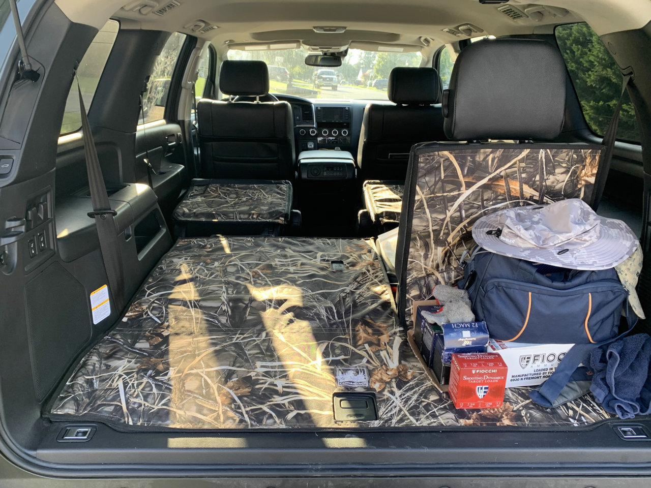

    Floors cost too much.
