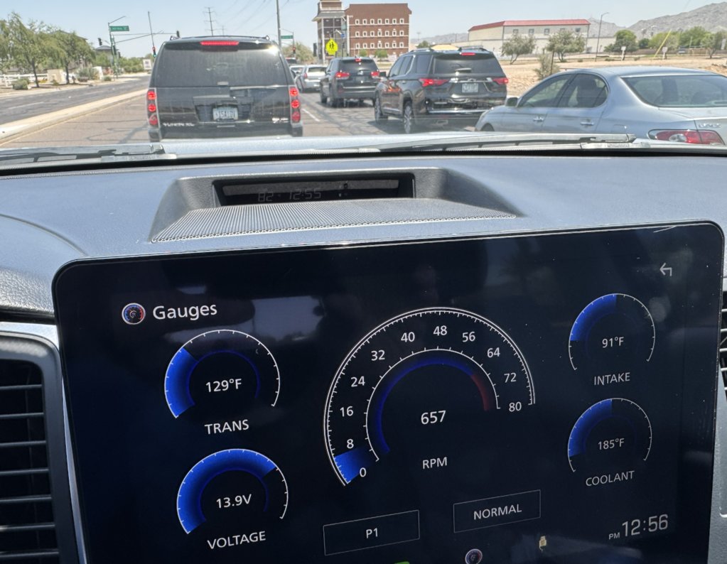

    That's a pretty high delta, where is your temp sensor located? Before or after the intercooler?
    M3Tundra-JK likes this.
  20. May 18, 2025 at 10:06 AM
    #1760
    e30cabrio
    e30cabrio [OP] I'm e30cabrio, I'm a modaholic
    Oct 20, 2017
    #10410
    6,614
    West Valley, Phoenix, Az.
    Boosted 2013 Sequoia TRD FAUX

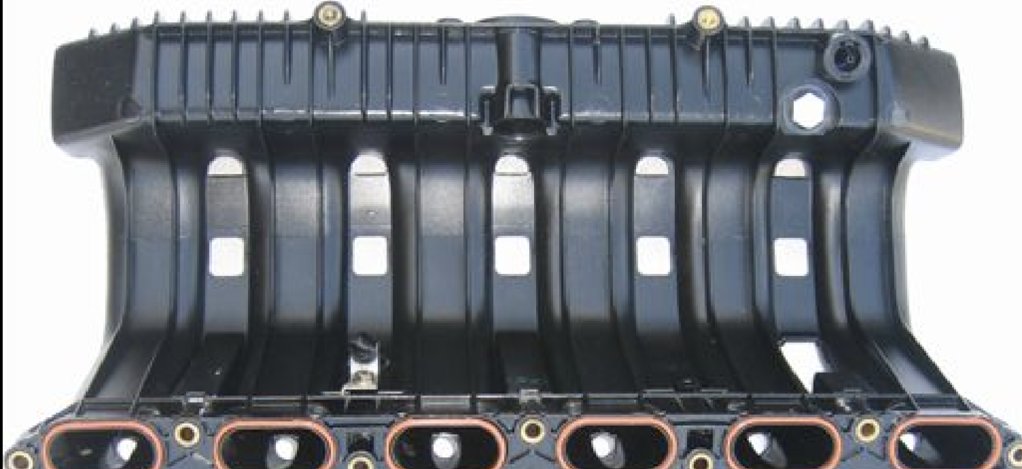

    It is in the back of the intake manifold, upper right hand corner where the nut is.
    That's down from over 160! I still need to install the AEM Water/meth kit & get e85, the station I planned on getting it from under 5 miles away no longer has it, next closest is 18 miles away.
    Also, no intercooler, no room, that's why I went e85 & meth.
    It is an earlier version with bigger runners, full explanation here:
    https://m50manifold.com/

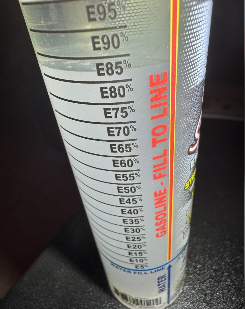

    Got just over 12 gallons of e85 7.7 miles from home.

    The e85 I got tested well.
    Because the standalone is doing the e85 for the BMW, I got the harness to use the kit I got for the Sequoia.
    armyoffoo and Mdl[QUOTED] like this.
