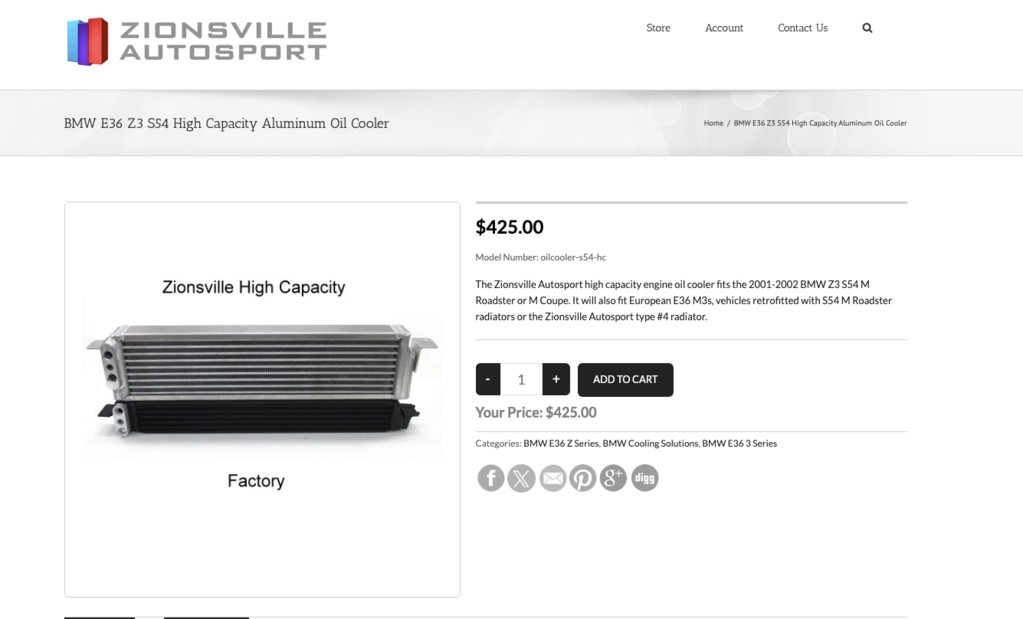

    I do recommend the oil cooler though! It's twice as large as the original, and it did bring my engine temp down a little. Also had the radiator replaced with a new OEM. These years are notorious for running hot. Not surprising with an 8k rpm redline

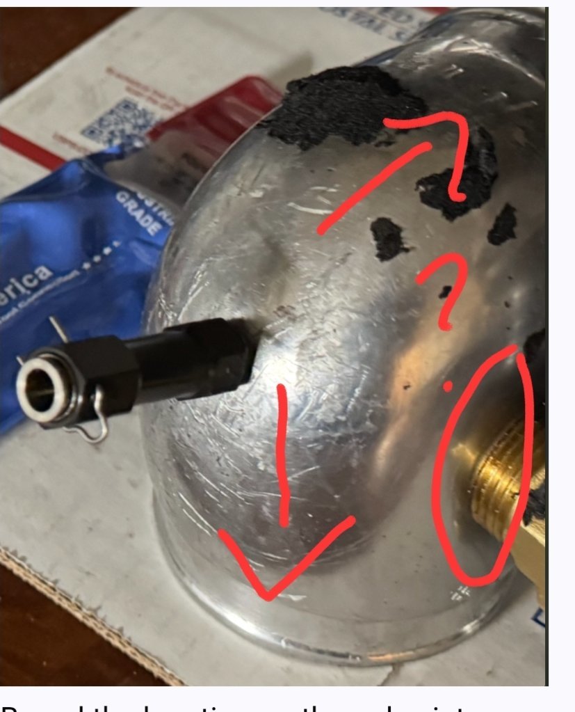

    Head will be ready tomorrow, block Monday or Tuesday, I got lucky, he found one for 350.
    Water and methanol starting to go in.
    Tapped the intake elbow for the injection nozzle.
    Based the location on the only picture from the elbow's perspective I had.
    Test fit the pump & reservoir.

    One thing to think about...what is the brass fitting, iat temp? Depending on direction of flow the W/M can cool the probe and give a false reading. But either direction it looks close and could skew readings.

    The brass fitting routes vacuum to the ICV (IDLE control valve) it's a stupid ancient OBD1 POS that the car needed to idle properly, I need to ask the tuner of the MAP sensor based stand alone needs it I'd love to get rid of it.
    Due to under hood clearances, that was the only place/angle to put the nozzle and have it facing into the TB which the tuner said was critical.
    armyoffoo likes this.

    I'm sure it's all good. I just wanted to point out that w/m can give false temps if sprayed on a iat sensor.

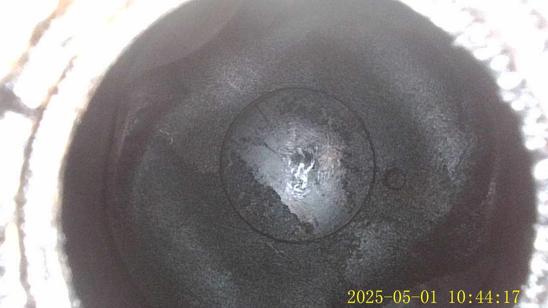

    The old Sequoia motor apparently had a ton of oil blowing through piston 2, the clean one is 1.

    What's the part with the engraved numbers on it?

    I think it is a valve, I can't get the piston to go much lower, I have the upper left side bolt through the starter gear ring as I could not get it lined up. I plan to pick it up off the stand & move it.

    Apparently, it is the piston.
    Got the piston to the bottom of the bore, outside the messy oil, I don't really see a culprit.

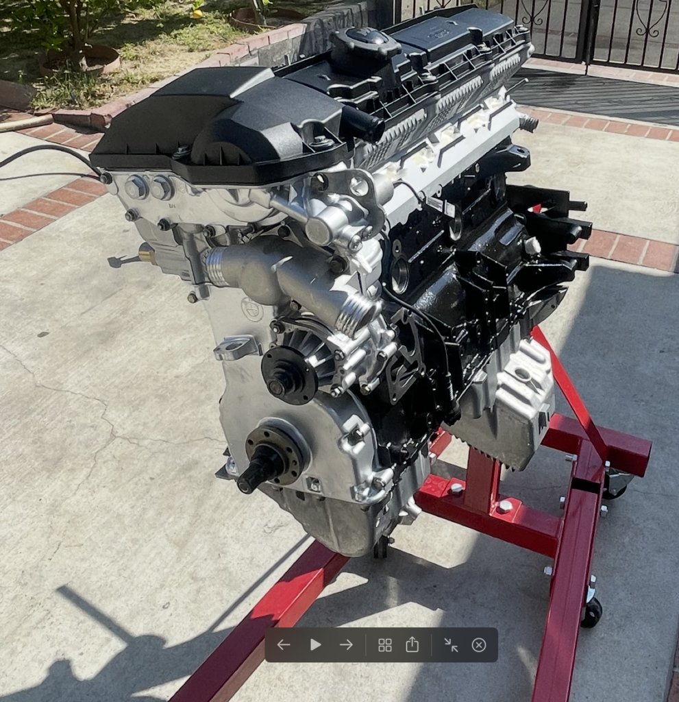

    Forgot to hit post yesterday :p
    It's home.

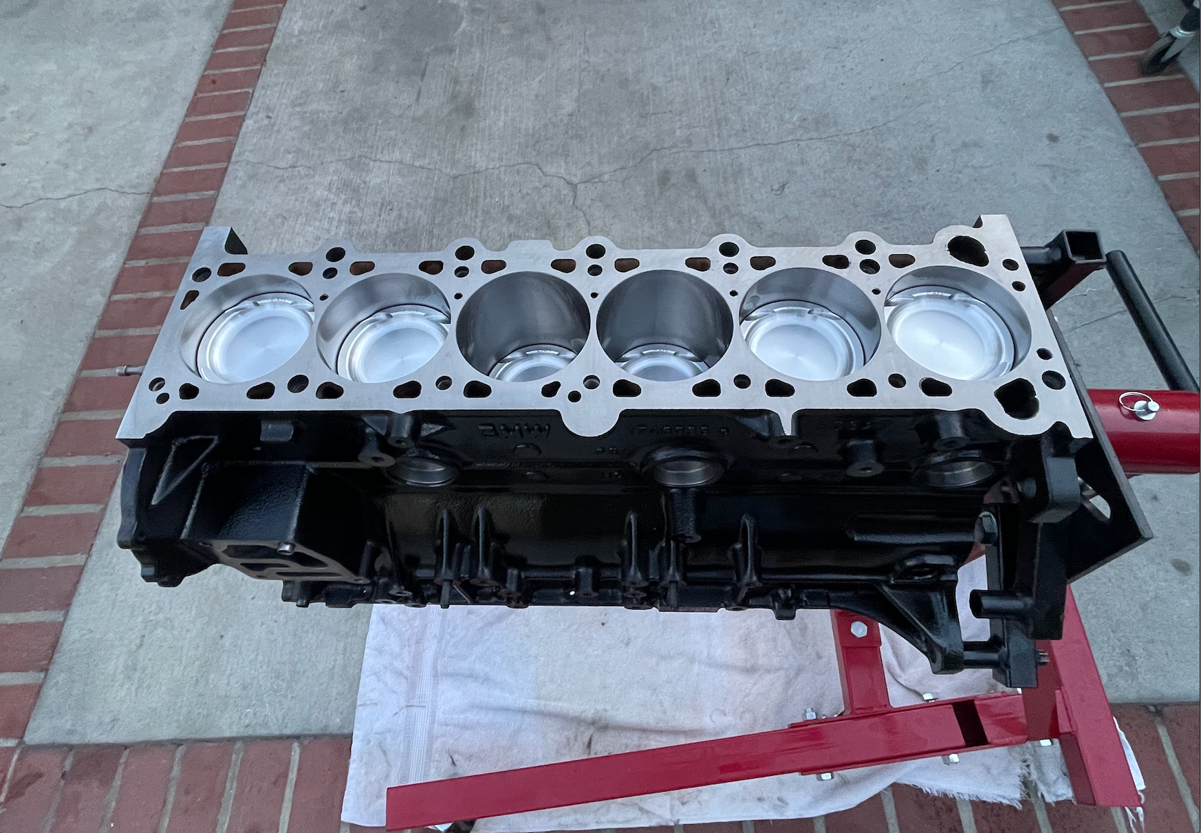

    Anyone want a lightly used forged pencil holder?
    Here is one of the JE 9.01's in it's burrow.
