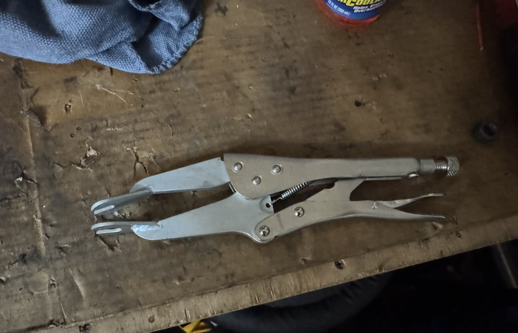

    https://vimeo.com/1064078656?share=copyI accidentally got the clutch master. Trying to put the pedal back together, the spring was impossible, looking for a write up I found one saying to delete it.
    https://www.bimmerforums.com/forum/showthread.php?1956868-New-mod-clutch-spring-delete
    Everything from 8-13. tried it with no spring & it seems to work but feels very loose.
    Maybe because the slave needs te be bled?

    When putting those little springs back on the drum brakes I've done, the solution I found online said to use some cutting pliers. squeezing enough to get a grip on it and pull, but not enough to cut it

    I tried that, nope, the issue is I'm working under the dash, behind the clutch pedal with no room on either side because brake pedal & wires/the side of the car.
    I got these which I swore came with an ounce silver ingot because 127.00 WTF???
    Still no. I'm going to see how it feels without it.

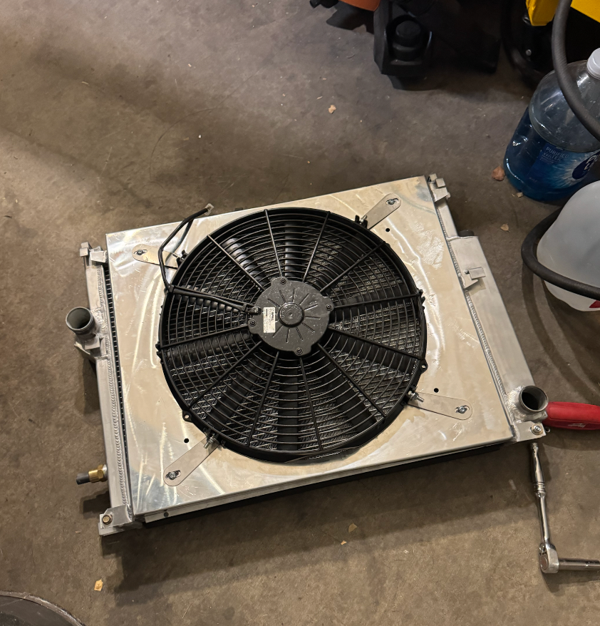

    Upper & lower hoses, expansion tank & it's mount, powersteering hoses & fluid & bleed the clutch are all that is left.
    Put the radiator in, of course the widest part where the wire is landed near the water pump.
    Pushed the shroud in & rotated teh fan.

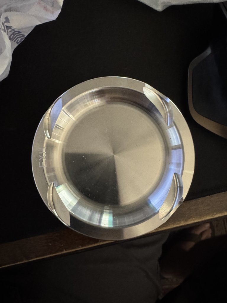

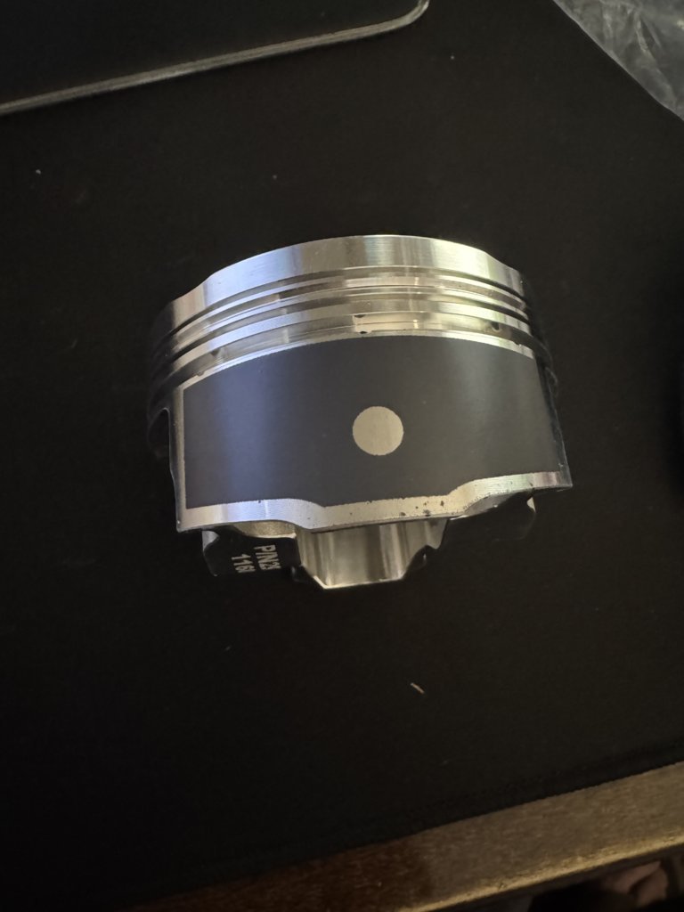

    I melted a forged piston in the BMW.
    9.0.1 JEs going in, I have a guy coming Thursday to pull the motor.

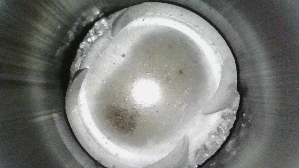

    I took the BMW motor to the builder, I melted somewhat every piston & a piece of a valve!!!

    Wow, that's some carnage...looks like a lot of heat. The valve reliefs on the piston are sharp edges and sharp edges become hot spots, which is probably why the damage is starting there...that valve probably came into contact and broke, I'd be surprised if the valve's not bent.
