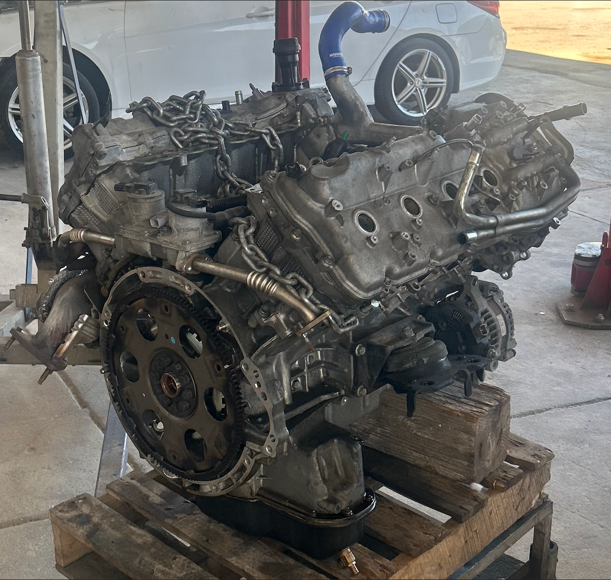

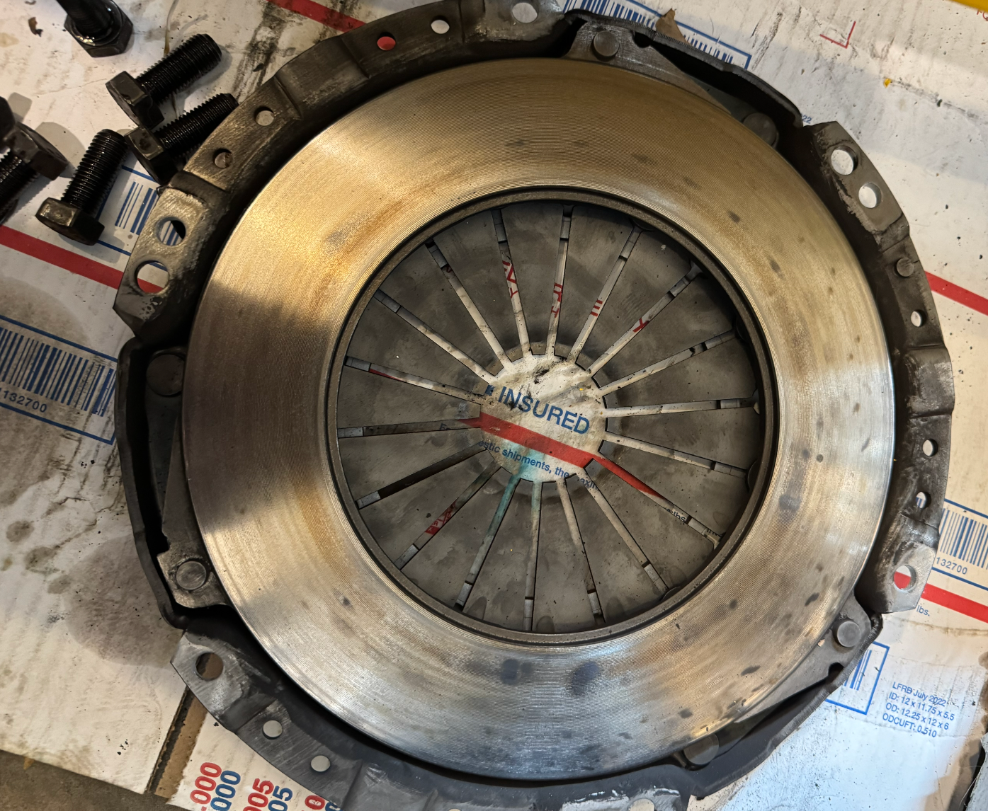

    Thoughs? Odd stuff on the flywheel.

    Not sure. I had a shop swap out the clutch and flywheel on my M3 probably 6-7 years ago. Never saw.whaybit looked like

    I'm no expert, but it looks like hot spots from slipping

    I forget what seal it is, but there's a notorious leaker in my M3 that I also had replaced at the same time. Should check and see ifnit affects you model

    That's my thinking. I never felt slipping. I'm thinking there was too much torque for the pressure plate. I ordered Level 2 HD Sachs clutch and PP & an Act aluminum flywheel.

    Hot spots but it is at weird places? Sounds like you have what might have been a potential problem well taken care of though!:)

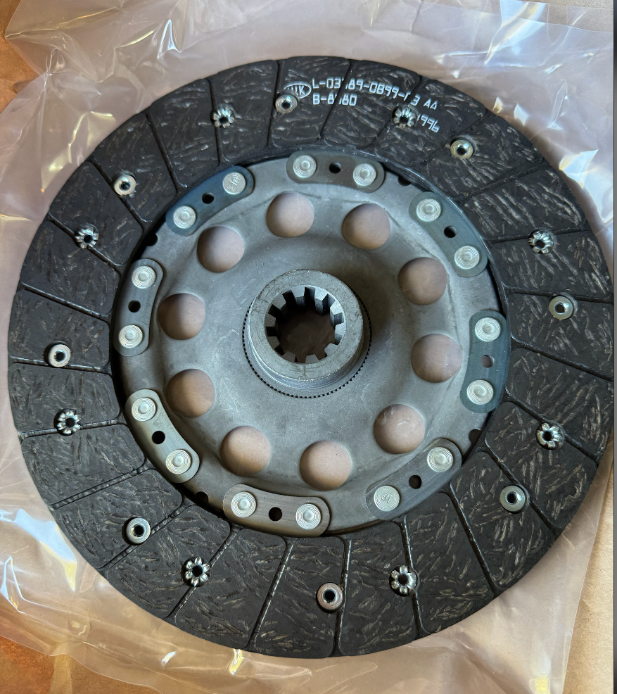

    Agreed, I ordered a new HD Sachs disk & pressure plate & a Spec aluminum 11lb flywheel.

    M3 clutch is here. Mechanic says Sequoia will be ready Friday 1/24, BMW motor will be ready to pick up 1/25!

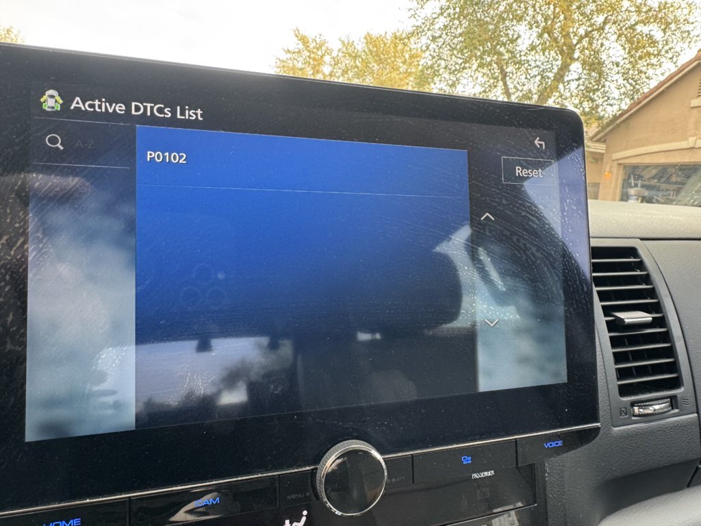

    I had no throttle & the codes won't clear.
    Erased the memory & ran relearn, got the throttle back but it stalls and the code comes back
    Going back to the shop.

    Boosted 2013 Sequoia TRD FAUX
    Shockingly, it was the damn accelerator sensor (that is the entire pedal) as a hail mary, I got one & it's fixed! WTF?

    Not the pedal, apparently the MAF/Throttle/bank 1 02 sensor bundle of wires are damaged & sporadically are not transmitting their data.
    It's going back for the third time today. Frustrated is not strong enough to explain my feelings.

    Still have not gotten the Sequoia back, the shop has ruled out a wire issue, think it is injectors in 1 & 3 which has lots of missing. I am getting PS 750s & hopefully that will solve it.

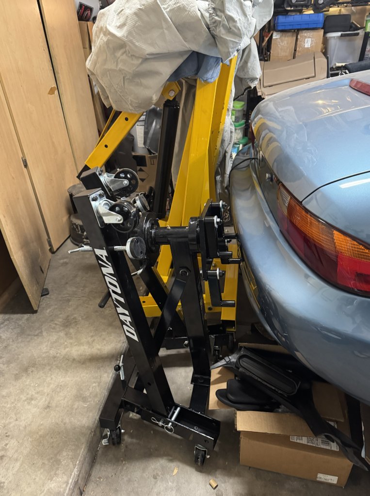

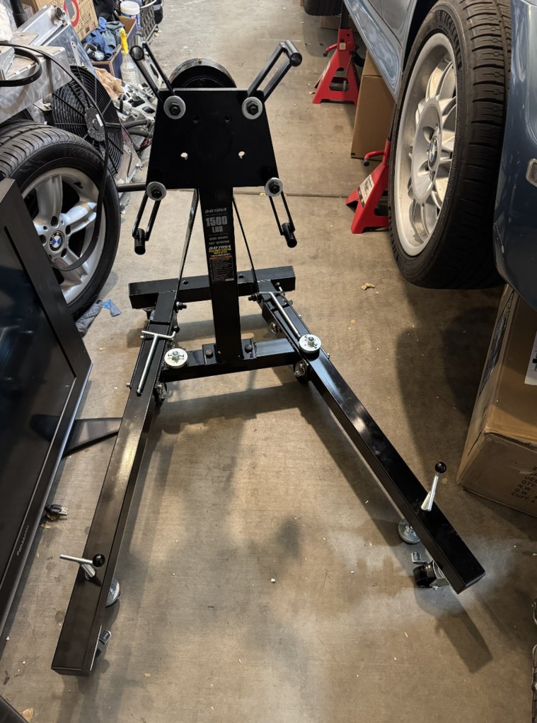

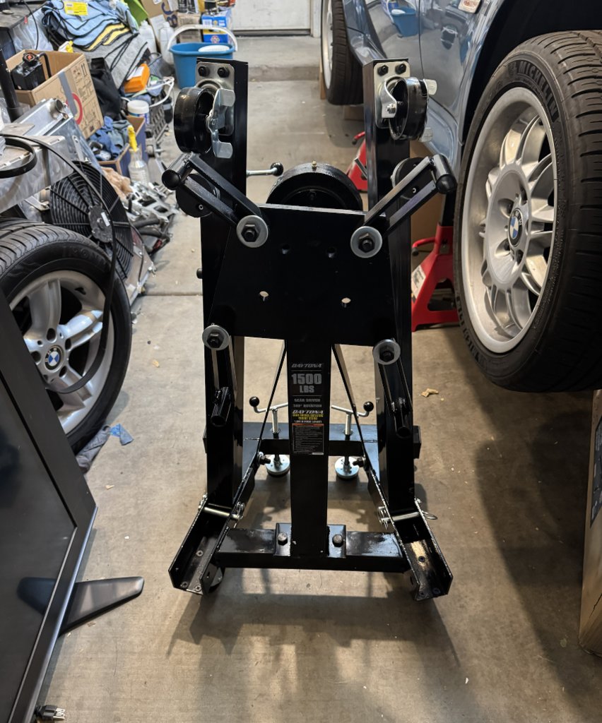

    I got a HF rotating stand for the Sequoia motor.
    The quality is good compared to the cheaper one, All of these I have seen online had the Daytona branding on the inside leg, I guess they just didn't care/want to "advertise"?
    Zerks on the stand were pretty bad, one ripped off when I removed the gun. The one on the rotating assembly was impossible to get the gun on so I replaced them all.

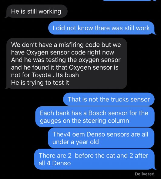

    Seriously losing patience & faith in these guys, how can you mistake the Innovate Bosch wideband sensors for the OEM O2s?
    I asked at 4 having not heard anything from them if I can pick it up.
    The worst part is Sniv & TK have looked at my logs & said no communication from bank 1 O2 & they keep saying it is fine. I told them the Bosch sensors are for the gauges several times before yesterday.

    Got it back, it feels good, have not gone all out, want to get logs to Sniv & then see whats what.
    The O2 code is the heater, P0031 I suppose it is possible it happened to die now but all 4 are about 8 months old, ordered an NGK from NAPA, should be at the store at 4. So happy to have it in the driveway!
