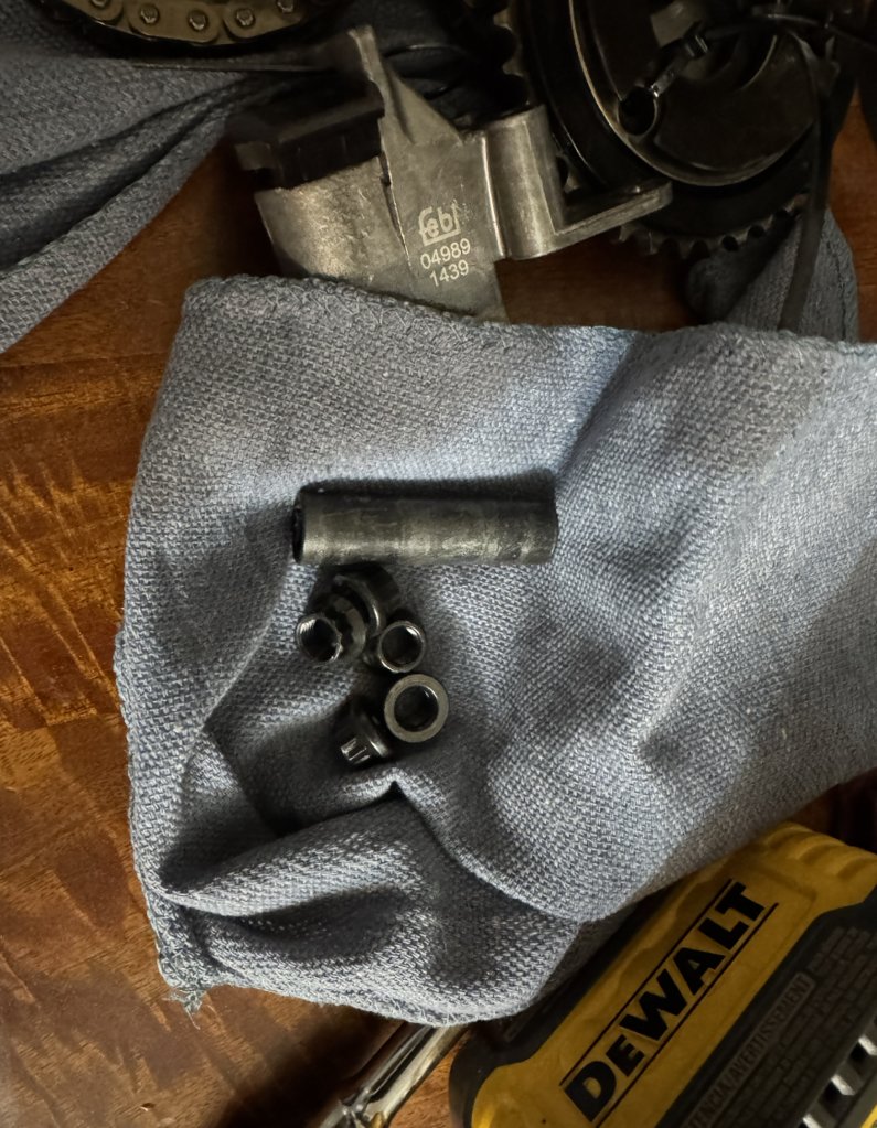

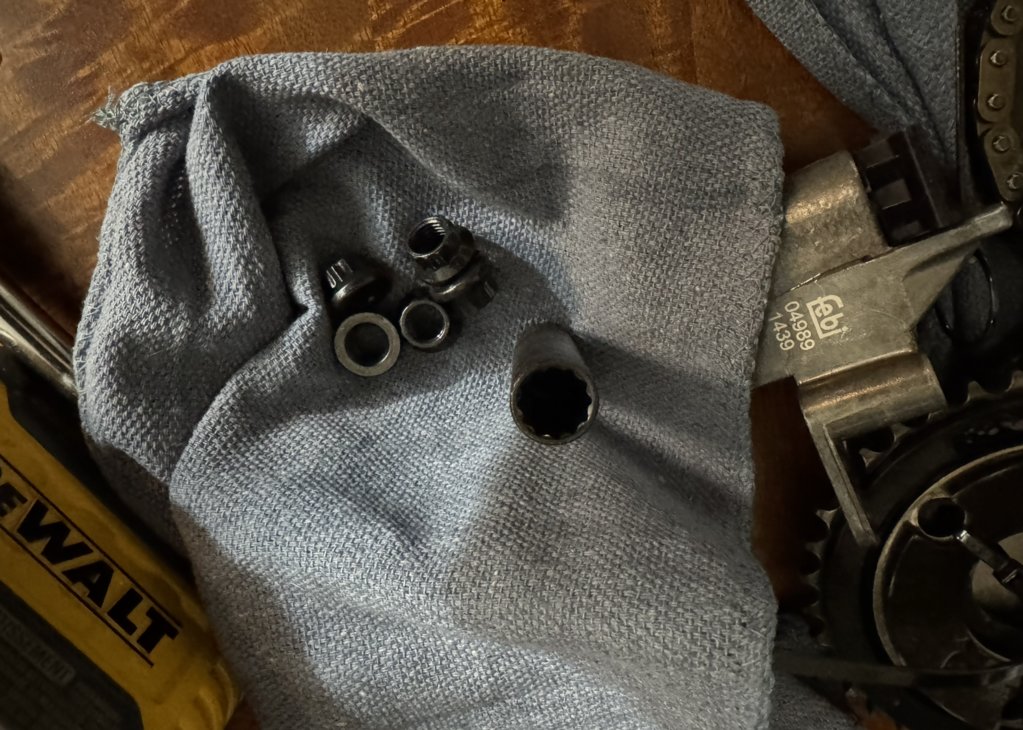

    I had alot of difficulty getting the necessary thin wall deep socket, I went to pick up one at Ace I ordered online, went to get it, nope.
    The first socket came & worked! Canceled the rest.
    5 of the 14 are out, the rest will fall out when the head comes out.

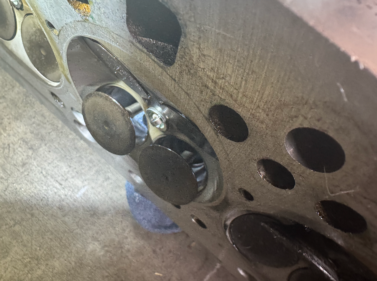

    Good news head is off, Bad news #2 had malice in the combustion palace.
    The valves and combustion chamber feel gritty in #2
    Cylinder in question is luckily open, here are a few of the valves. It's amazing how my dog's hair gets everywhere, he is never in the garage.
