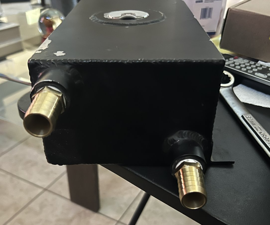

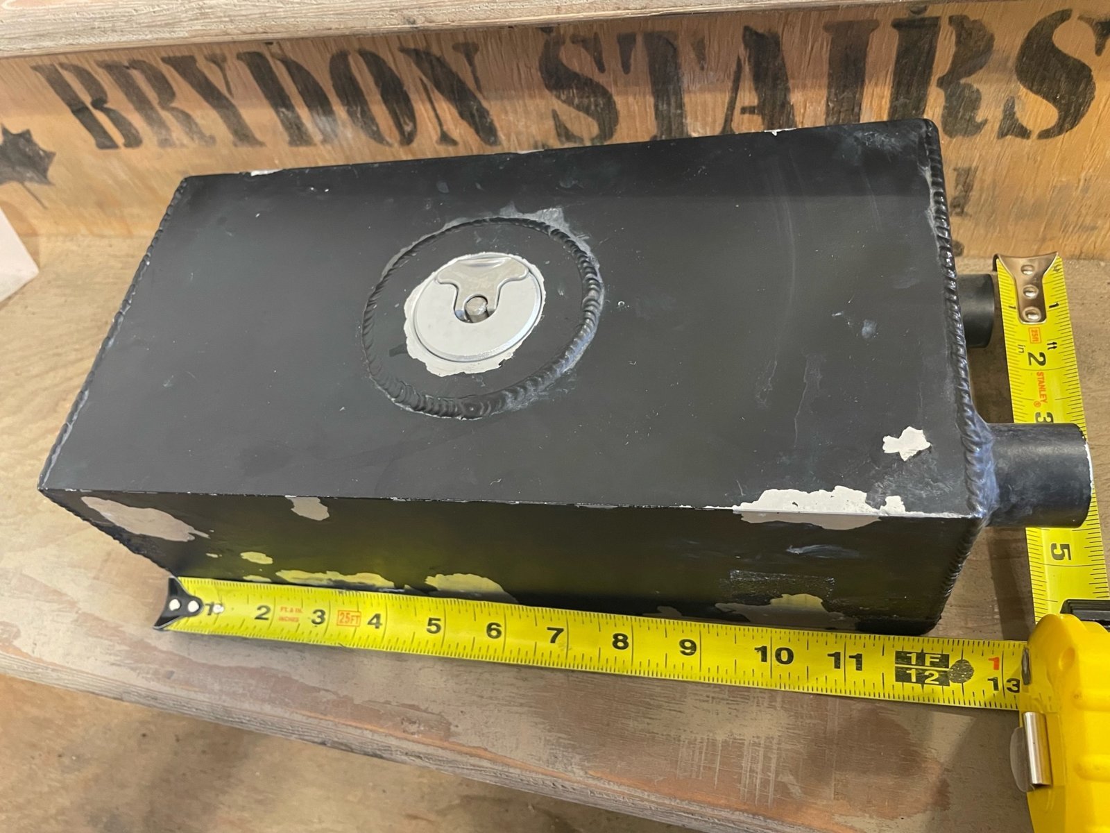

    Thanks, the BMW uses "traction fluid" and it's hoses are that size, the consensus in the SC thread was it is too restrictive. Thanks to Viktor, I got this one:

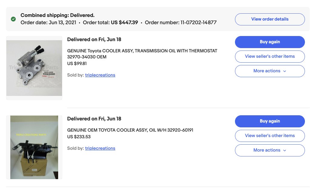

    Here you go!
    Lines I just did hoses, I later got the metal lines from a dealer, they are on a shelf somewhere.

    Fittings came, I need to figure out where to put it.

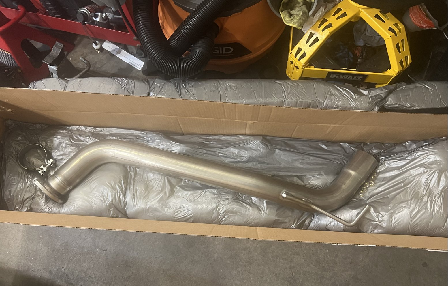

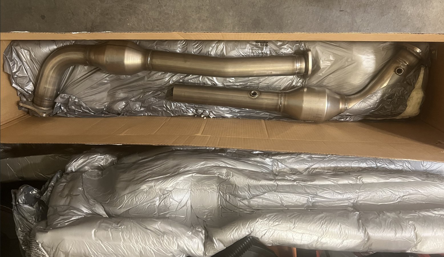

    Downpipes!!!
    Amazingly well packed, they look amazing.

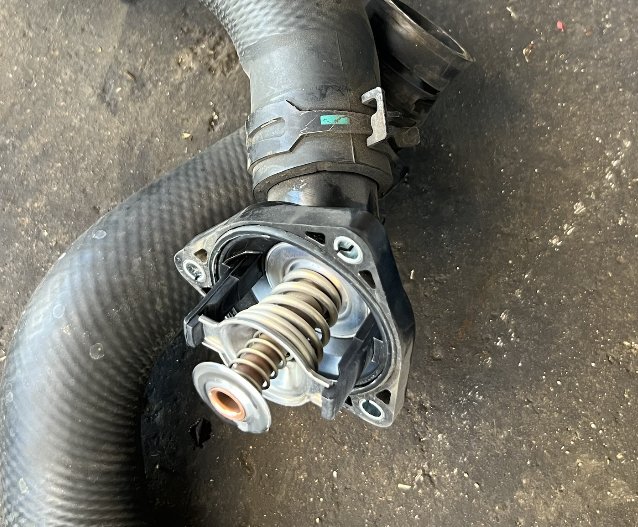

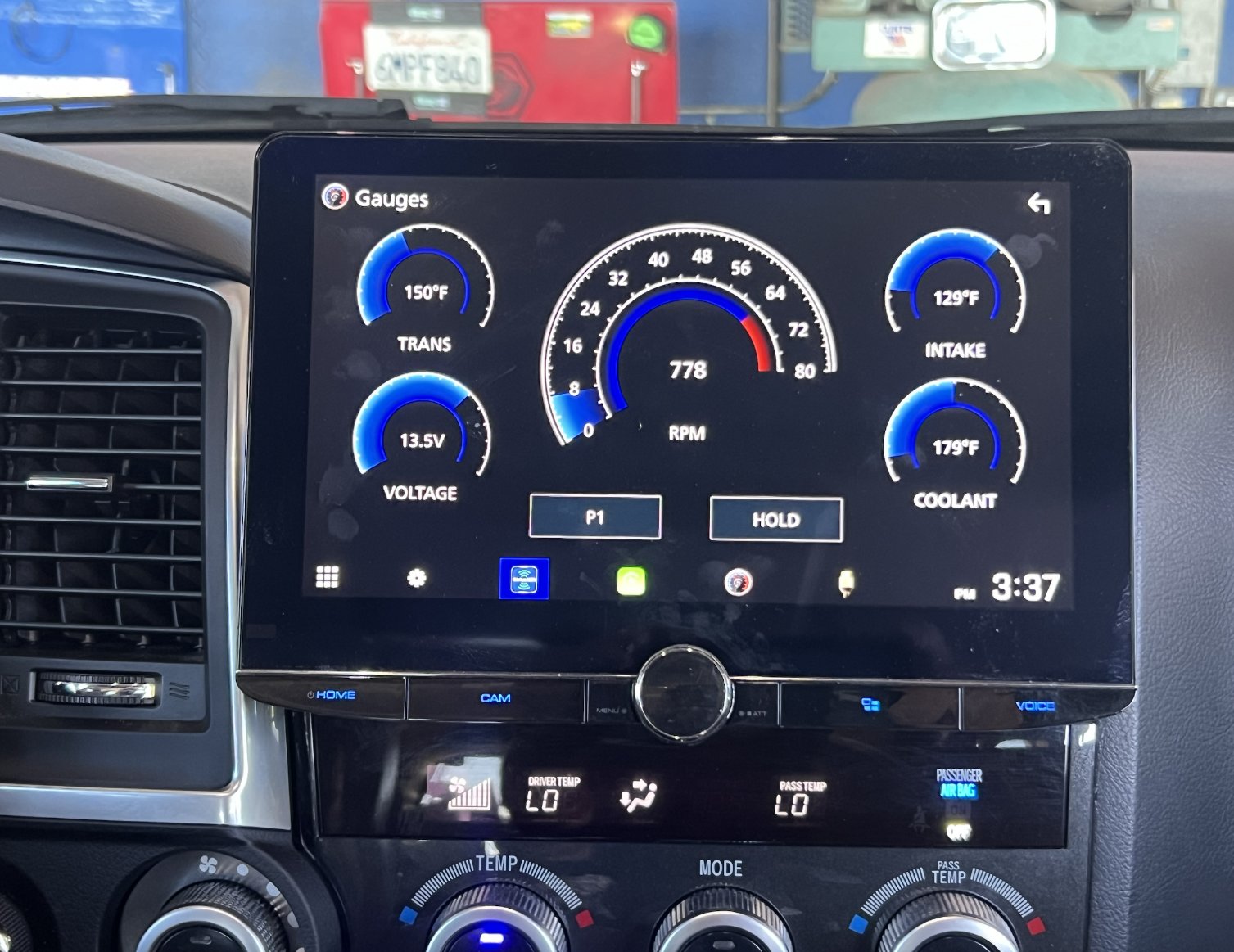

    Got it back, only the radiator & cooling parts in, he had an emergency after wasting an hour not getting the 2.3 pulley off. Said it is too small for the puller I got the original off with & he broke his puller trying.
    I'll bring the truck back Saturday for the cats.
    It was idling for 20 minutes before I left, running almost 20 degrees cooler, the thermostat that was there looked new.

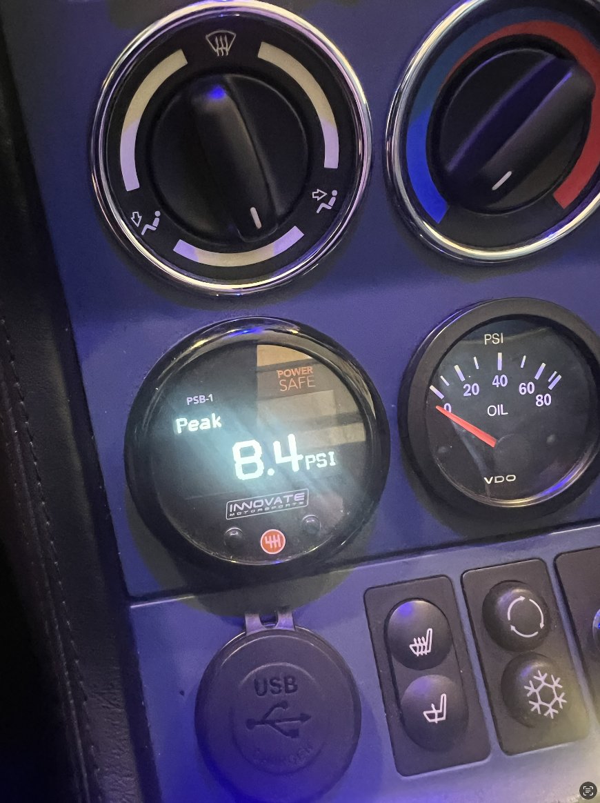

    Cats are in! Moar powa! Sounds rowdy!
    I had never seen north of 9lbs over 90 degrees, it's 111!
    I have 1/4 tank, gassed it turning left, had the starvation & sounded like several M16s! lol

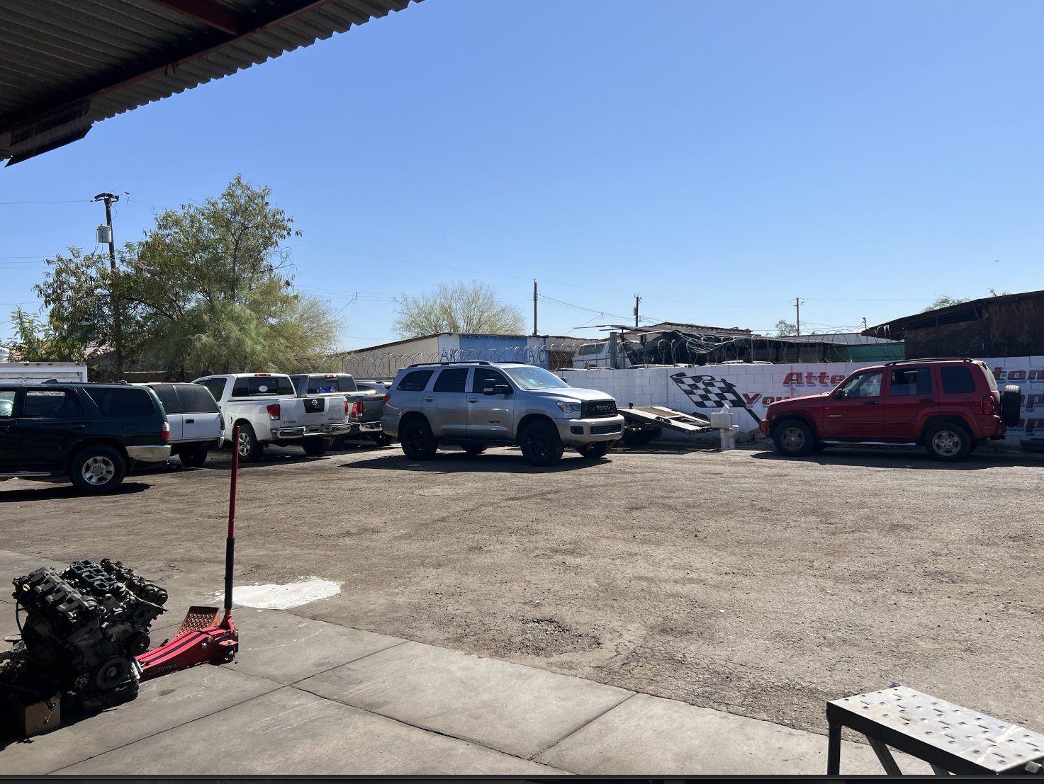

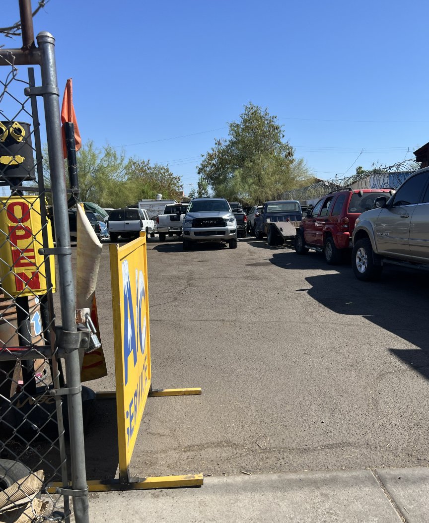

    Picked my Wife up from the airport. On the way the AC stopped blowing cold. Went to the shop, compressor died, 1200 to replace everything :( I can't get a break
  29. Jun 28, 2024 at 5:48 PM
    #1439
    e30cabrio
    e30cabrio [OP] I'm e30cabrio, I'm a modaholic
    Oct 20, 2017
    #10410
    6,672
    West Valley, Phoenix, Az.
    Boosted 2013 Sequoia TRD FAUX
    Went to pick up the tree, paid 1200, drove 1/2 a block air stopped blowing cold, AC light started flashing. Returned, they said the new compressor was seized.
    gaaaaaaa
    Hopefully, I get it back tomorrow.
