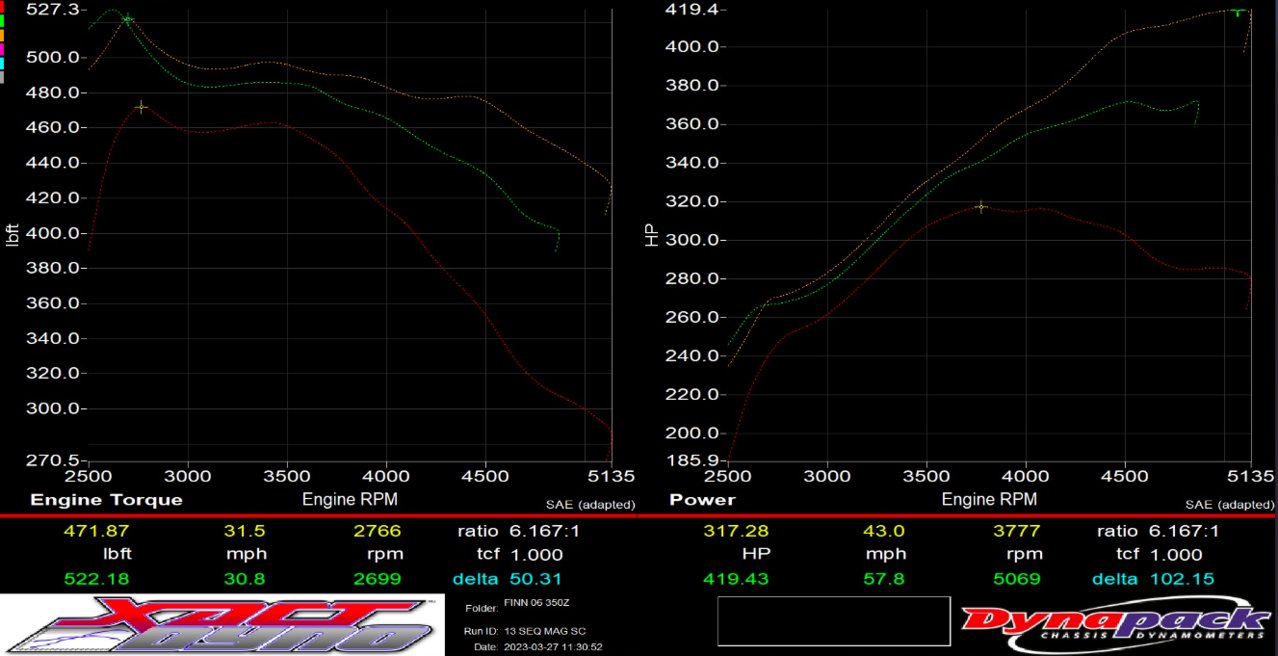

    So good news/bad news.
    Lots of power, but loss of fuel pressure at 5100rpm.

  28. Mar 28, 2023 at 1:13 PM

  29. Mar 28, 2023 at 5:42 PM
    #899
    e30cabrio
    e30cabrio [OP] I'm e30cabrio, I'm a modaholic
    Oct 20, 2017
    #10410
    6,504
    West Valley, Phoenix, Az.
    Boosted 2013 Sequoia TRD FAUX
    Forgot to post the CARB sticker, cause I'm OEM.
    lol
    Fotnot likes this.
  30. Mar 28, 2023 at 5:49 PM
    #900
    sd172
    sd172 New Member
    May 28, 2021
    #63619
    312
    South Dakota
    2021 Sequoia Nightshade
    Not too bad for a 10 year old truck. Are you planning to get any of the timing components serviced while you are getting cam towers re-sealed?
