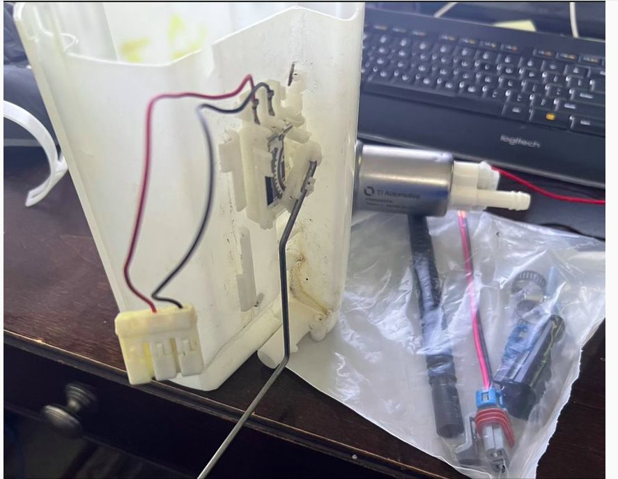

    Boosted 2013 Sequoia TRD FAUX
    Walbro 450.

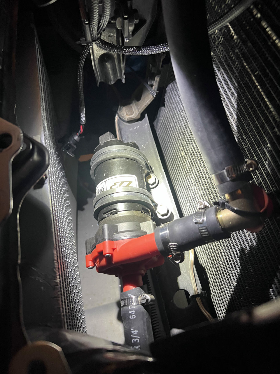

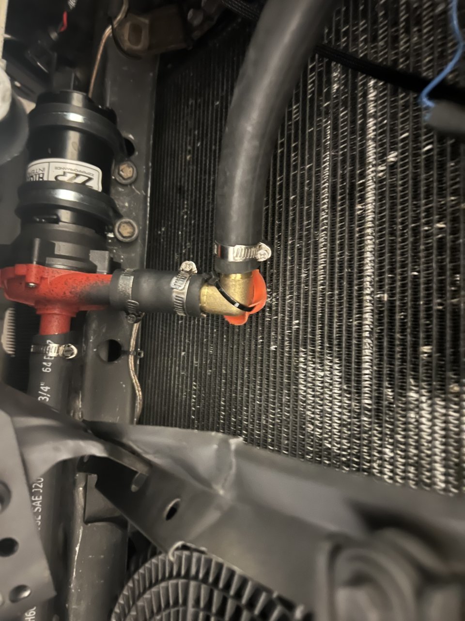

    IC pump installed. Ran the harness, verified function, disconnected the harness so it's not running. Waiting for the O rings to do the injectors & running the gas out before I can do the pump.

    Finished the IC hose routing. Waiting to do the reservoir until the SC is on, hoping the rest of the parts I'm missing come early in the week.

    Damn that's a tough break!
    Is the walbro in and running? Does it whine like the old walbro 255's? I ran them in my 240sx's, I always hated the noise of the walbro 255's. I ran a deastchwerks in my 4r and it was dead silent with plenty of flow.
    The pump isn't in yet, it's not that loud in my hand, I doubt I'll hear it installed.

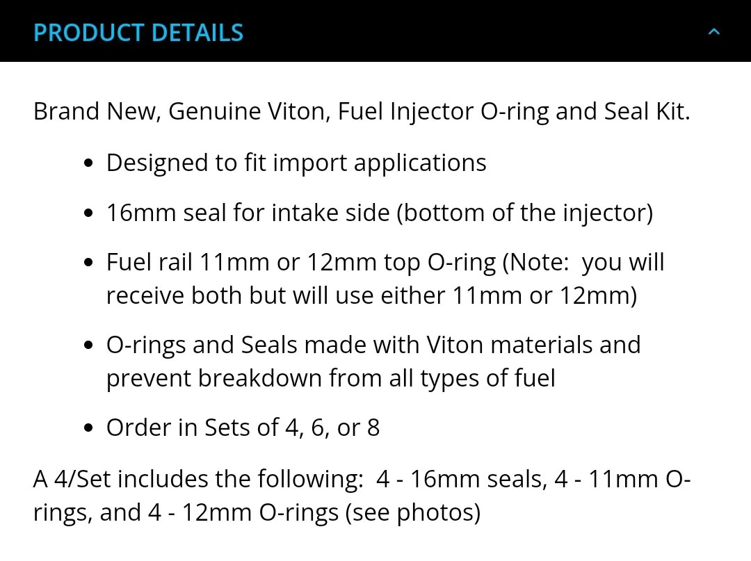

    I got the O rings from FIVE O, there are different ones than what I have & an extra. I asked 5-O without response, which do I use to replace the orange one I have on the injectors & where does the other one go?

    Stock as a rock
    After looking at their site. I wonder if it's just o-rings for different motors since those injectors will "fit" the 4.6 and both flex/non-flex 5.7's?

    Stock as a rock
    I looked up their o-ring kit, they are just different sizes for different applications since it's a universal o ring kit.
    https://www.fiveomotorsport.com/fuel-injector-import-oring-kit/
    He said the extra was to be sure I had the best one. The black seems best to me.

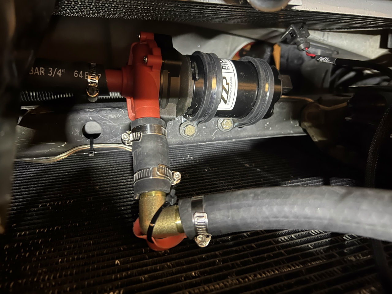

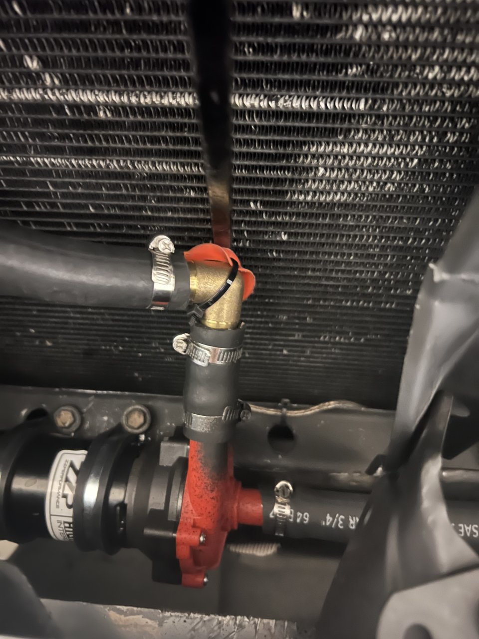

    Harrop supercharger, TRD Pro Fox suspension, CB +1 shackles, 295/70-18 Toyo ATIII, TRD Pro forged rims
    Can the pump be clocked so the output is more vertical? That brass 90 with the rubber isolator will wear out and damage the rad or the pipe over time.
    e30cabrio[OP] likes this.
  18. Mar 12, 2023 at 8:45 AM
    #858
    e30cabrio
    e30cabrio [OP] I'm e30cabrio, I'm a modaholic
    Oct 20, 2017
    #10410
    6,504
    West Valley, Phoenix, Az.
    It's an optical illusion, the directions called for a 15 degree angle is why it's not verticle. There is space, here are different angles & one with my pry bar in there.

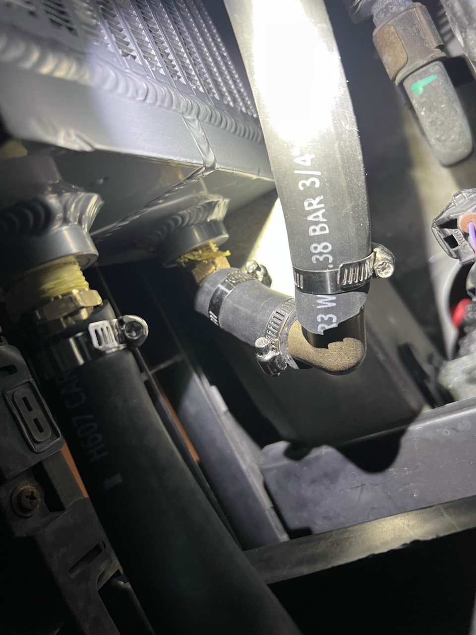

    The reservoir was backwards, the Vacuum hose needed to be tightened down, PVC needs to go to the catch can.
