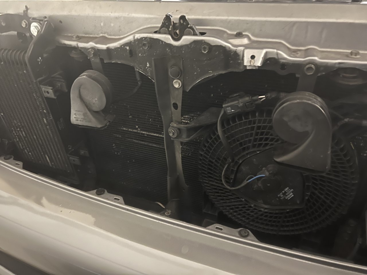

    Test fit the IC, not going where M3's is. I have a condenser fan. Going to have to go under the fan.

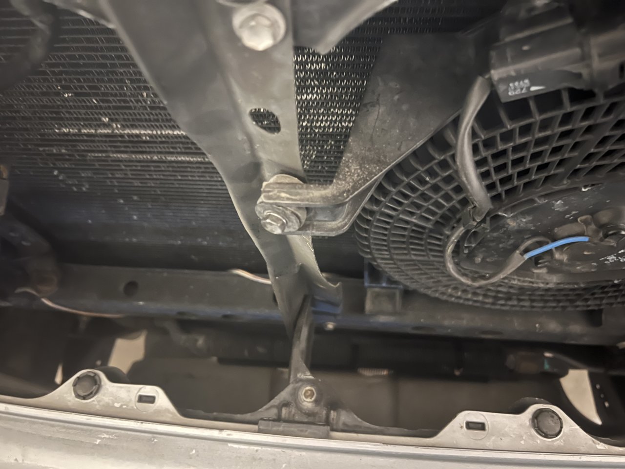

    Intercooler is in. Need to run the hoses that I have to pick up at Autozone. Pretty happy it fit there under the fan, less restriction up top to the radiator, condenser & engine bay& fully open to air!

    I left the fittings out to squeeze the IC in. Upper was worse, ordered a 22mm ratcheting pivoting wrench to get it in the rest of the way.

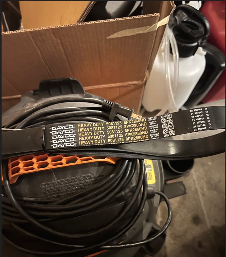

    Second time is the charm!
    The beauty of Amazon is just create a return & use their label & $ comes back. The wrong belt $ is already back in my account.
