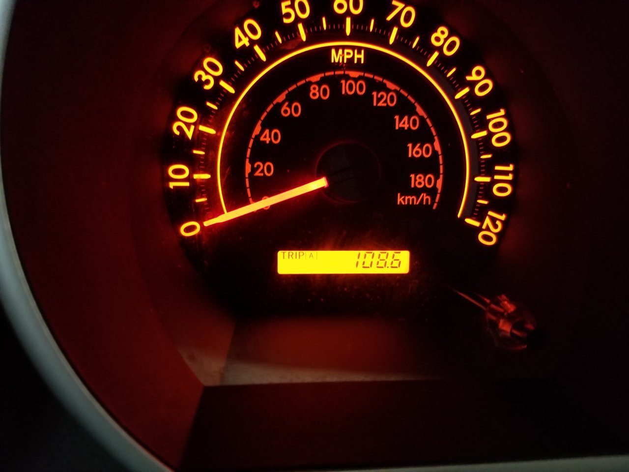

    Would this trip have reset to zero when I disconnected the battery for an hour??? I was trying to reset the ECU. This is the amount I just put in 2 days ago and topped off 4 gallons tonight and reset all to zero. Lets see what happens. Funny how it says 341 mile range slap full and I got less than 200 miles out of my first tank. Hmmmmm

    It always does that when you disconnect the battery. It will go down.

    Also, if you just reset the computer, it almost always shows worse Average MPGS than you actually get. I would run a few tanks through it then check it or manually calculate it.

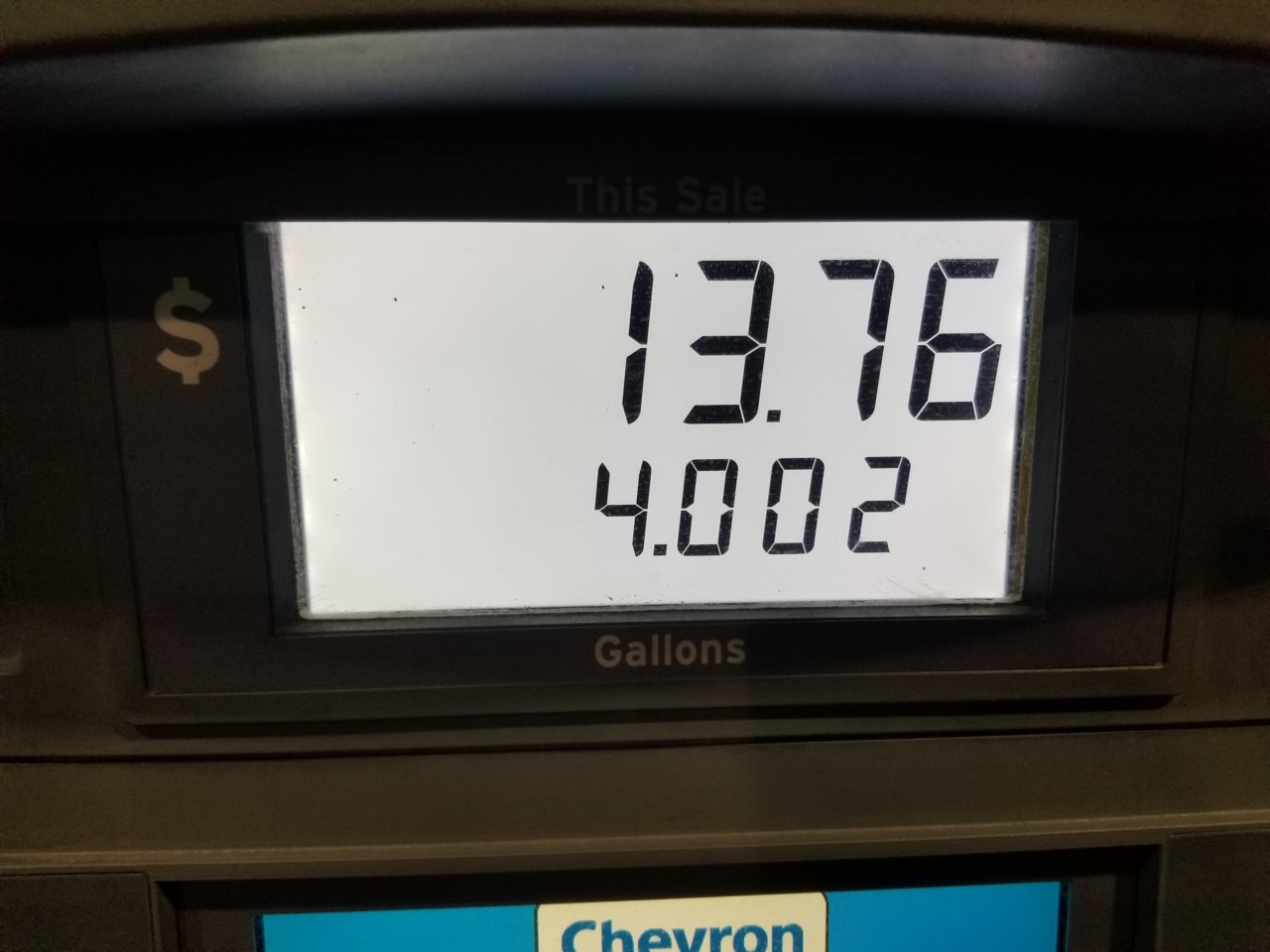

    Update guys: First of all than you all for the input. I am grateful. I cleaned the throttle body some more and put 3/4 of a can combustion cleaner down the throat and let it sit. I have never used 87 or 89. I have always used 93 octane. Now I know this will stir a serious debate but I stay true to my proven 93oct at my shop.
    That being said. I checked every vacuum line by removal and bend with a flashlight ,i even submerged them and water tested with compressed air and zero leaks. I looked everywhere in my immaculate engine bay for any signs of wire chewing and zero. Did a serious Corrosion X HD aviation Grade treatment on my battery posts and Pos & Neg wires to the battery, tire pressure, alignment, brake inspection, 2 tank treatments, filled it to the top with 93 , added Klotz, reset everything to zero and 8 hit the Turnpike at 4 am.
    My girlfriend and I drove from West Orlando Fl down south to Port St. Lucie Fl to get my daughter. I was stunned to see I did over 287 miles averaging 75-80 mph there and back and still had a 1/4 tank to spare when I got back to my shop. 16.2 MPG was the best it did for the short trip.

    Honestly I dont have a definitive answer. I just went through doing what I do ensuring everything is 100% . I also got every bit of shit 87 gas out and swapped all 93 in with Klotz. Over time the 93 will clean the filthy valves from 87 oct all its life. When my Klotz engine oil gets here I can slap that in with the TRD high flow oil filter and I will be golden! TRD Exhaust next!
    Update #2 Just made a run across the state last night topped off to full and I literally made it here and burned only a 1/4 tank this time not a half a tank like the day I drove it home from the dealership!!!!!!! Wooooooooooo

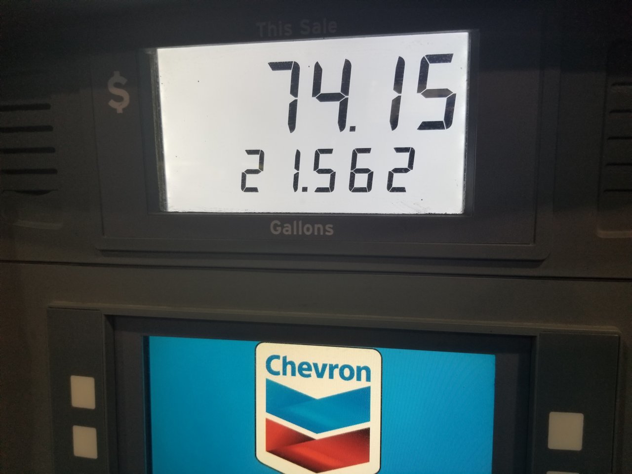

    Update #3 Truck is running amazing! Just went from the west coast of Florida to the east coast and back to the middle of rhe state and still had more than a 1/4 tank left! Hell yeah!!!! So I stopped at the Toyota dealership and picked up my TRD Cat Back Exhaust. Super stoked. Rims and Tires going on by Friday too.

    Update #4 finally stopping for fuel up with 93 octane again. I still had more gas to burn but I was headed across the state east bound and want about to use a crappy old gas station off the beaten path of hwy 50. Im blown away at the difference. I probably could have made it to 375 miles or more on this 1 tank.
