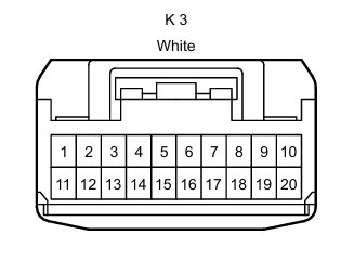

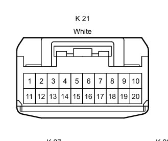

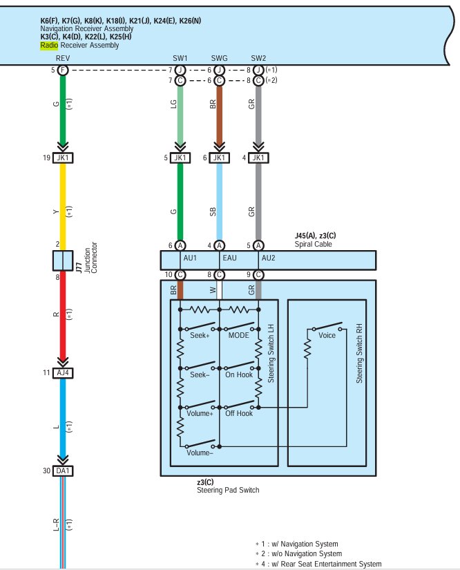

    These are the wires to the steering wheel controls.
    Pin 7 - lime green wire SW1
    Pin 6 - brown wire SWG
    Pin 8 - grey wire SW2
    If your Tundra has navigation, it is the K21 connector pins 6,7,8
    If it does not, connector K3 pins 6,7,8
    Although the connectors look the same..

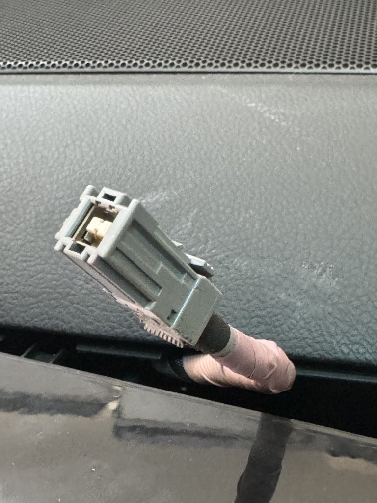

    Hey man hows it going. So the harness should've come with a steering wheel female plug... it should of came with 2, plug it into which ever one fits. I had to manually tap into the camera lines my self (which on the car harness side the steering wheel plug and camera wires are together)
    *edit* now that i see you have the same exact head unit as me please re-read the whole thread. We were pretty clear on what i had an issue with. you will have to cut the truck harness 4 wires and splice into the Dasaita unit (remember to plug in the camera accessory harness onto the head unit)
