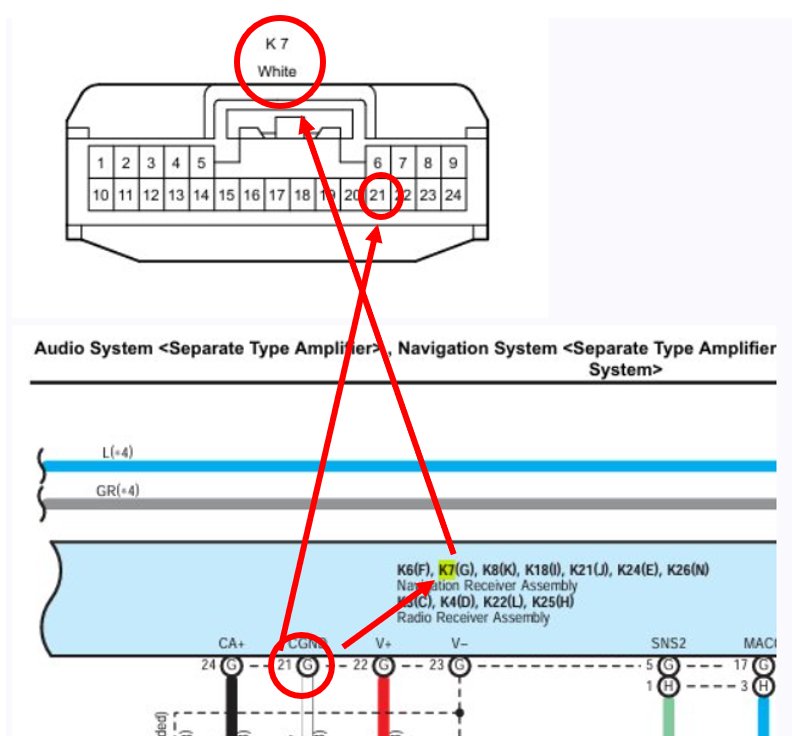

    There seem to be 2 different connectors for the old OEM HU for the camera.
    Depends if you have the external amp or not.
    Do either of these connectors look like they fit the old radio?
    The letter in the circle where the wiring connects to the HU represents the connector used.
    The number next to the circle designates which pin it is in the connector.
    For the separate amp, that connector is G - K7
    For the built in amplifier that connector is M - K23
  18. Jan 28, 2025 at 12:22 PM

  21. Jan 28, 2025 at 1:16 PM
    Snert
    Snert New Member
    Jan 31, 2024
    #111218
    718
    2021 SR5
    To expand/clarify on @1lowlife's example:
    1) You're first looking at the 21 (G), ignoring the 21 for now and just focusing on the G circled in red.
    2) Looking up at the connectors list, you'll see (G) corresponds to connector "K7", circled in purple.
    3) In the EWD right after the color wiring pages you'll find the connectors drawings, like at the top there in black and white. You'd scroll around until you find K7.
    4) Going back to the 21 before the (G) in step one, that corresponds to the pin number in connector K7 above.
    1lowlife likes this.

    Wow. yep, its connector K23.
    Looks like the steering wheel buttons and camera is integrated into the 20 pin.
    Now, lets see if my earlier thoughts worked - one of the 5 pin connectors is the reverse.

    Ding ding ding! It hurt cutting the factory harness but whatever. Woohoo!
