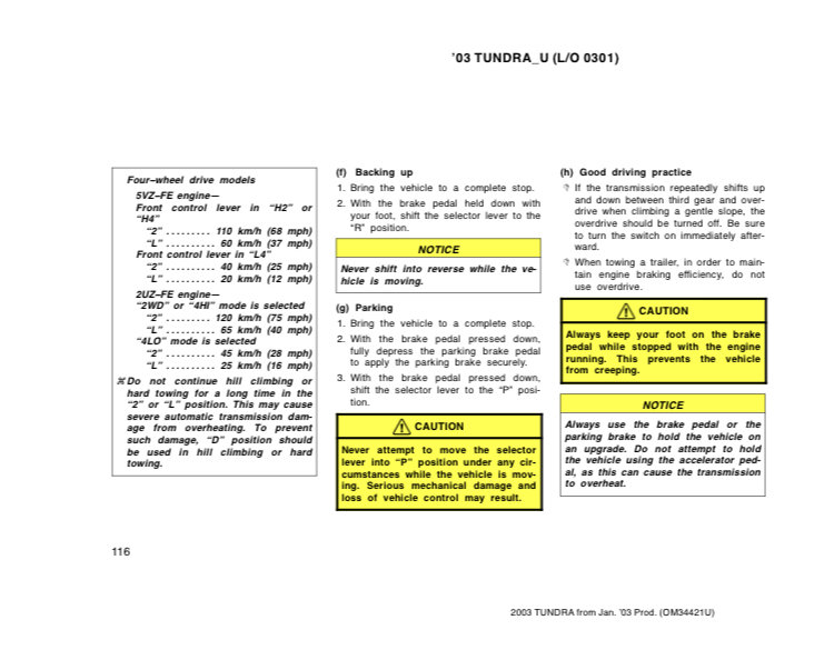

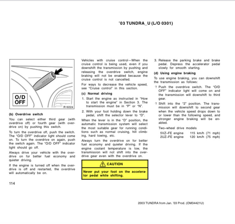

    The trans needs to be taken out of overdrive manually by pushing the button. It will downshift in OD but then it will upshift as soon as it gets a chance so it will shift up and down. Push the button and it won't go into OD. Yes, downshift manually to increase rpms both climbing and when descending to use engine braking.
    As mentioned, reading the manual is helpful. If you don't have a hardcopy register your truck with the Toyota driver app and it will show your manual.
    From the '03 owners manual:
