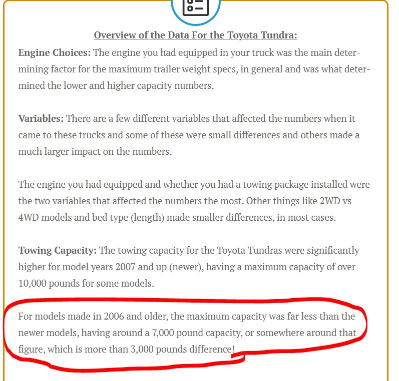

    Tow the trailer to a truck stop, loaded just like you would for camping, and put it on the scales. You need to know what it actually weighs as you tow it.
    A trailer with a 5K pound listed weight is the dry weight. That is before any trailer addons from the dealer, before batteries, propane, camping gear, water in the tanks, etc. You could easily have another 1000-2000 lbs of stuff in there.
    Some quick googling I found this info. The yellow one ONLY shows 2wd trucks, so if you have a 4x4 you would likely have less towing capacity. You are easily near, at, or even over what your truck is rated to tow.

    Folks, thanks for all the input. My truck is rated at 7,000. I did not realize the trailer tongue was NOT counted in trailer's weight. Unfortunately, a new truck is not in the cards. I asked a mechanic about putting the larger engine in and he said it would be cheaper to buy a new truck... not sure how that math works. I am having the trailer safety inspected next week at an RV place to make sure there is nothing going on causing the difficulties from the camper side of things.
