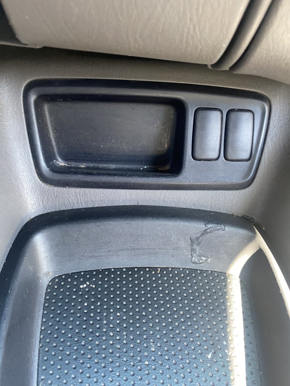

    That picture is what my center console looks like, I'm looking for something to go in there that I can fit my Kenwood USB to.
    I don't want to convert the cig lighter, just looking for the part that has 2 USB in it that fits that.

    How do I remove the little blank spots for the usb port? Exacto knife? Or do they just like pop out?
    Thanks in advance
  11. Jul 18, 2024 at 6:04 PM
    artsr2002
    artsr2002 2005 Tundra DC SR5
    #35520
    2,108
    'Yonder
    Flat head screwdriver to pop the whole cover out and then pop the button blanks out from the backside. Easy peasy.

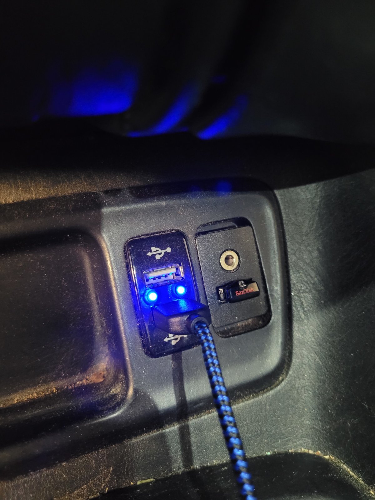

    Here's what I used. The plastic is shiny instead of mat but it popped right in. Ignore the ill-fitting one on the right. That's USB and Aux input for aftermarket stereo. Spliced power from the cigarette lighter.
    MNJ Motor Dual USB Charger Ports Compatible with Toyota, 12V Car Charger USB Power Socket Adapter 2.1A for Smart Phone PDA iPad iPhone https://www.amazon.com/dp/B07K1ZG5F2
