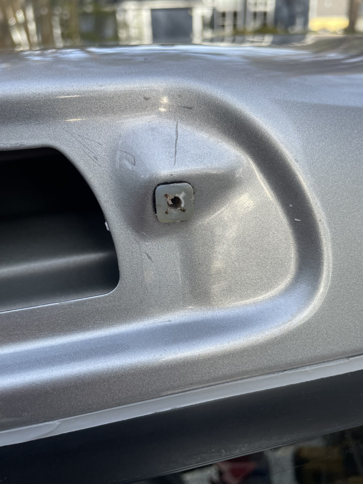

    I striped the plastic clip that the screw threads into for the third brake light
    Anyone know the part number to order new ones?

    Try 90189-04035

    Stuff a zip tie end in it, and then rescrew

    Lowe's has some similar items that may fit the bill.

    I think I’m more concerned about the lack of seal - do the double cabs not have the same foam seal around the perimeter as the access/regular cabs?

    When I looked up the part number, the exploded diagram did not show a foam seal. I specifically looked at 2006 DC.

    That was going to be my other suggestion, or a piece of narrow gauge wire. The local ACE HARDWARE might be a good option too. They have a plethora of weird fasteners/hardware.

    Thank you all! Yes hopefully will come with a seal too, because Im having a hard time fixing a third break light leak. If it doesn't have a seal I will just silicone it.
