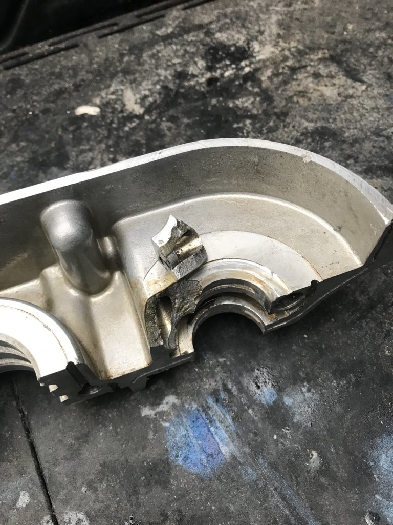

    Bought this a couple weeks ago. Has 236k miles and I got it for 2600 bucks. Had some valvetrain noise. First thing I did was pull the cams out and found they didn’t clock the sub gear with the service bolt. Also found a broken cam cap that was epoxied together.
    Anyway, I bought another cam cap that luckily had the same alignment and bore size (literally within a thousandth), replaced cam seal, put an aisin timing belt kit on, and a new serpentine belt with tensioner. Oh. and I put on a new crankshaft seal. Runs great and looks great with my tundra.
    Has this stupid clunk sound that sounds like it’s from the center rear. Looked underneath and seems stout. Any ideas?
