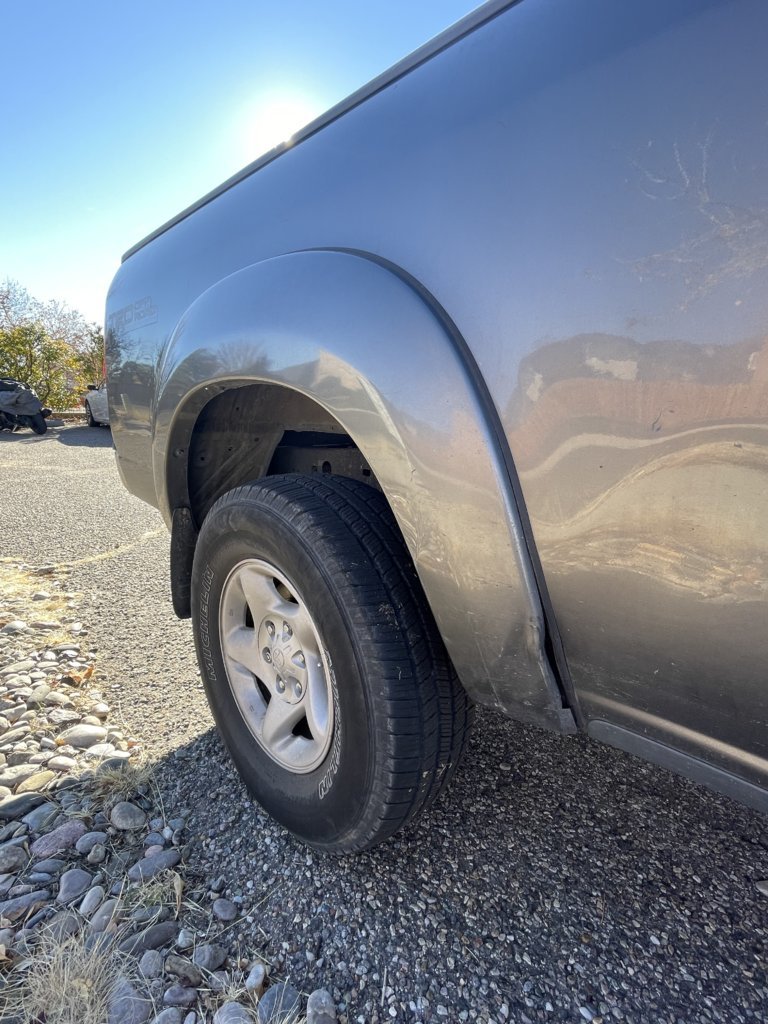

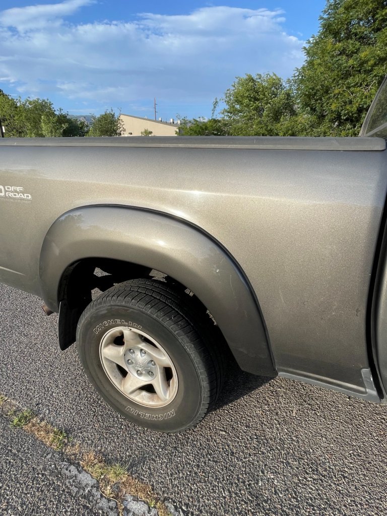

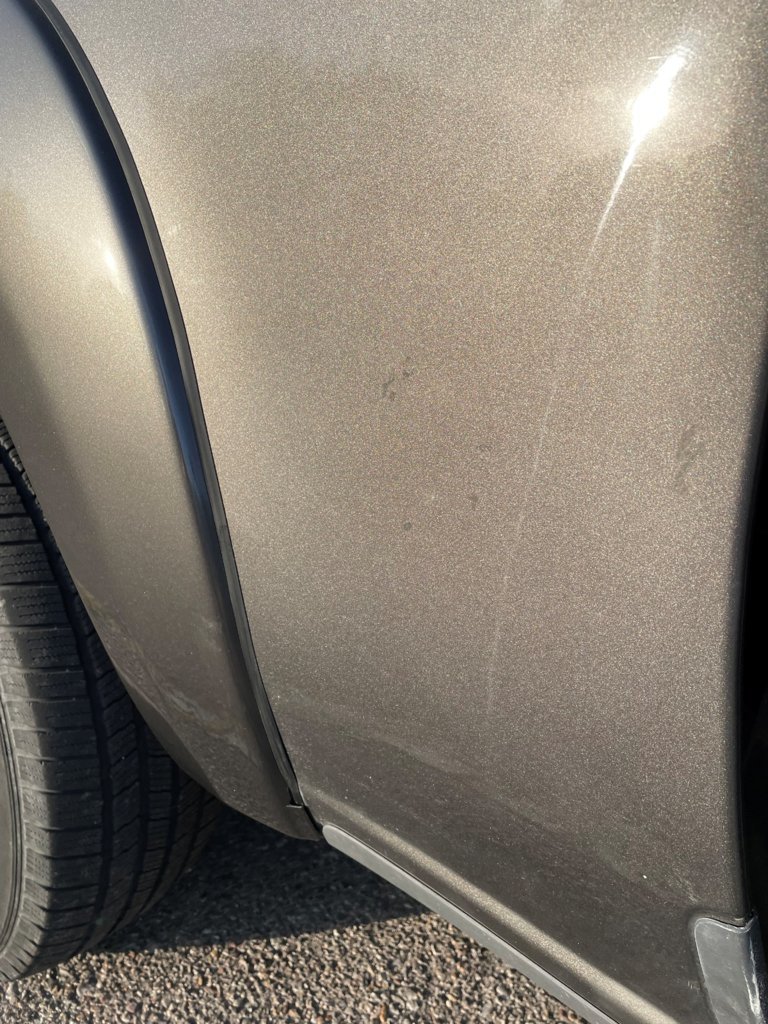

    Hi Richard-
    Is this what you're dealing with? I will be shortly too...genius here clipped my buddy's wife's Audi in the street. Pulled it loose from the fastener and bent it a bit. Likely will require some painting....
  4. Dec 29, 2024 at 2:21 PM
    bfunke
    bfunke Tundra Curmudgeon
    Oct 13, 2019
    #37321
    2,516
    South Carolina
    2018 SR-5 CM 5.7, 2000 SR-5 AC 4.7L
    IIRC those wide fender flares have attachment holes drill through the fender unlike the smaller ones.
  5. Dec 29, 2024 at 5:11 PM
    bing5
    bing5 New Member
    Oct 23, 2024
    #124729
    156
    New Mexico
    2004 Double Cab. 260k+

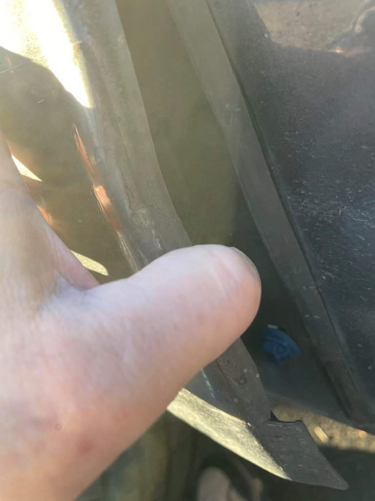

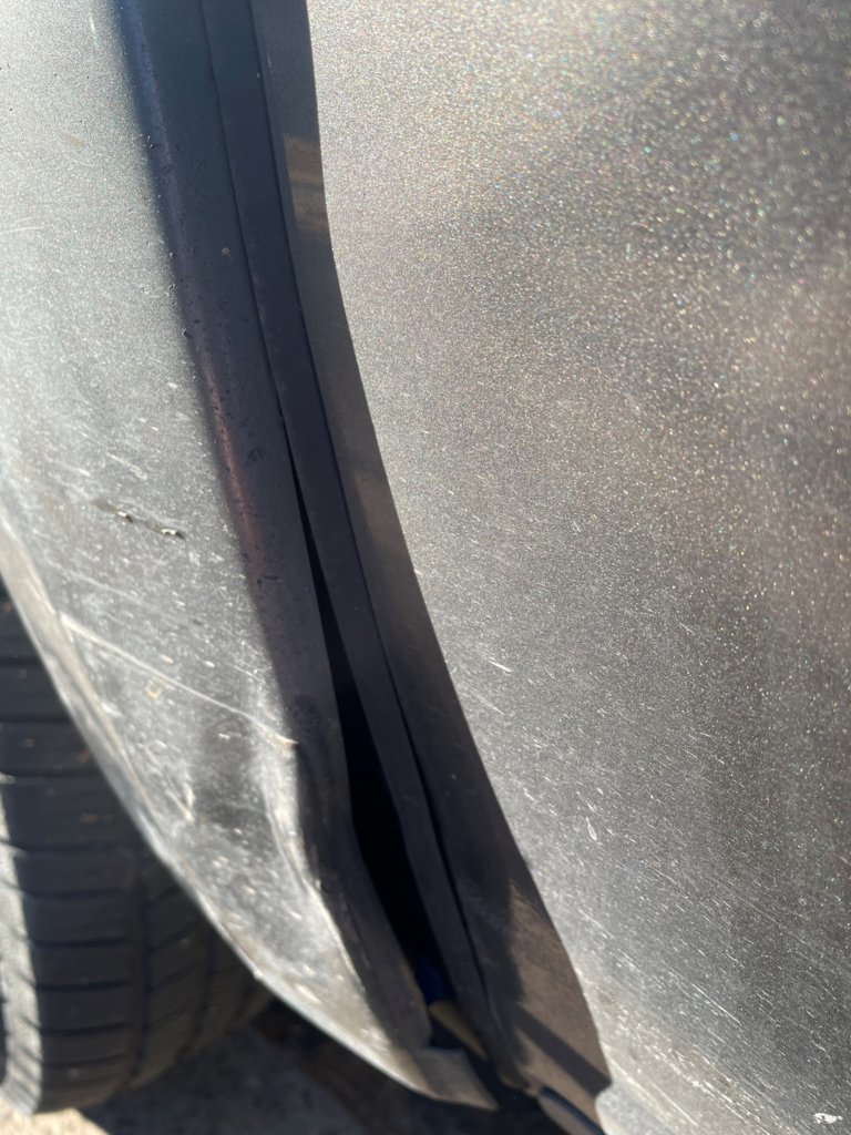

    Correct. Seeing as it took only a low-speed, glancing blow, I thought I might be able to get it back into shape with a heat gun. Suspect I am kidding myself however, and will likely shell out the $250 for the Toyota replacement and paint it. Toyota part number for passenger side on a DC looks to be 75873-0C901. Whether or not I will try to paint it myself remains to be seen. Suspect shifty put some info about that idea in the monster thread.....

    If a heat gun won't work, seriously, junkyard/parts truck. That seems to be the most popular DC color out there, and the DCs without fender flares are hen's teeth. As long as it's not an X-SP truck (or similar one-off custom regional package), it should fit!

    I was too lazy to take Shifty's advice and go to the junkyard (probably a big mistake) and purchased the fender flare new from Toyota. Can I paint this thing myself, or should I have a paint and body shop do it?

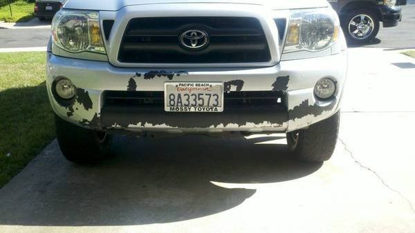

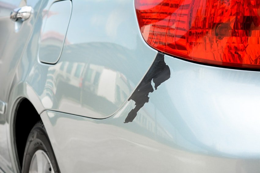

    Here's the thing, and @Dakillacore can potentially speak better to this than me. Unlike the Sports Grill painting I just linked, fender flares are flexible plastic. Typically with flexbile parts like our fender flares, bumper skins, and other things that may see some flex or torsion, you really need to be careful about keeping your part surfaces clean, and more importantly, use a good adhesion promotor. If you don't, the paint will ultimately crack when things flex from wind or body torsion, and you'll see stuff like this happen - you may've seen other people's cars like this also. This can either be caused by improperly cleaning panels before paint and failure to use adhesion to promoter, I believe.

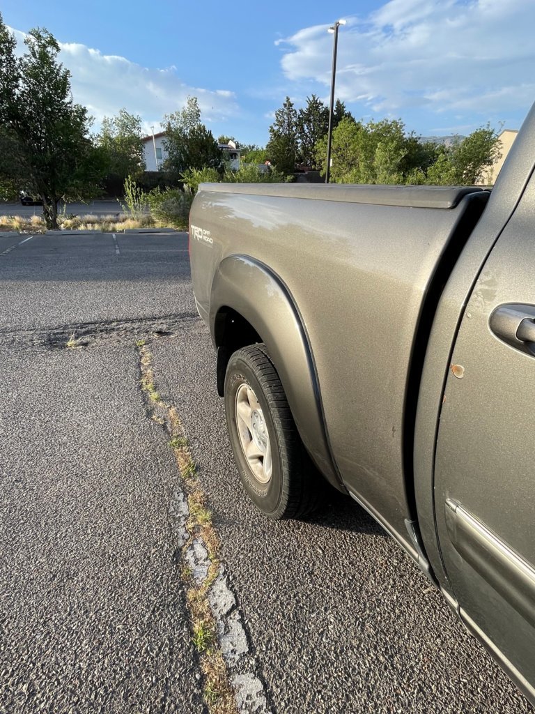

    Missed out on the hanta, but got the flare done. Called a few junkyards and no luck. So....took it to a local body shop. They did a bit of paintless dent repair around the front of the flare, painted it, and installed it. Quite pleased. Don't ask what it cost. New back passenger door is next. Flare5.jpg Flare6.jpg Flare7.jpg
