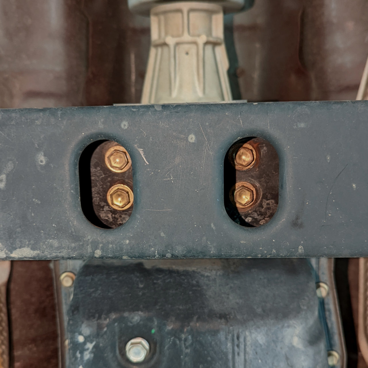

    Here's a better pic. These are the bolts in question.

    I got to them and they were slightly loose. I'm going to drive it around and see if the clunk is there

    If the clunk is gone go back and put some blue loctite on them.

    Well it looks like I tightened the screws the wrong way and the whole mount fell off...........
    Jk.
    The thud seems to have been reduced dramatically but there is a still a slight acceptable thud. It definitely feels like a normal gear change, maybe.
    I'm not ready to close the book on this one. I plan to drive it for a whole tomorrow to see if I notice the same thud as before.

    Did you inspect the crossmember closely for cracks in the steel? The replacement crossmember isn't exactly inexpensive, but if yours is cracked, you will want to replace. It may just be that the thing is cracked, and giving a little bit of play on shifts. It's holding quite a bit of weight, if x-member is cracked, you'd still get a tiny bit of movement.

    I did inspect it. it looked good.

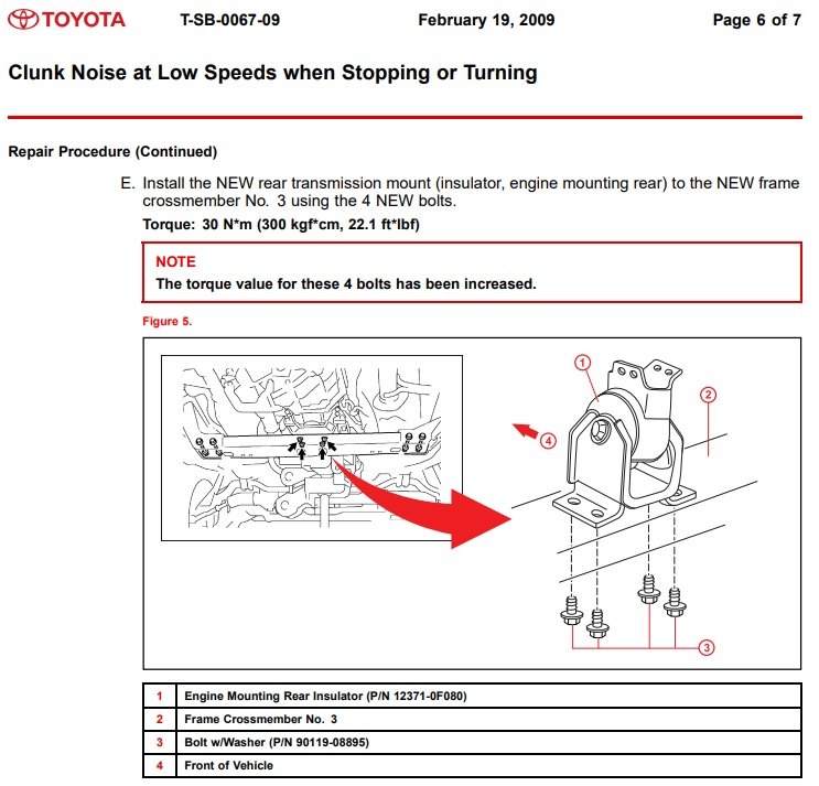

    OP, have you had any issues after this? I have a similar situation going on in my 2003 2WD.
    Does anyone happen to know the torque spec for these bolts?

    Look at post 25 above. It has a link to a thread about this. Follow that link an look at post 17, it has a PDF of the TSB about this problem. Torque specs for all the fasteners are included in that.

    @sugar pants actually ... to both their points, read the friggin TSB document. Seriously. There's a lot more than torque specs you need to know inside that doc.
    And don't hesitate to check out our community 1st gen info thread for more TSBs and other common issues. We assembled it for folks just like you who need quick access to important info and warnings on our trucks. There's also links to the cracks and stuff you'll need to be looking out for if those bolts are loose. If the crossmember is cracked, they're just going to loosen up again.

    Thank you all! I read through the document. I found two of the four bolts slightly loose and tightened them up. And there was no visible cracking or other issues in the general area.
    Sadly, this didn’t fix the issue for me. And, as I have a 2WD, there are no grease fittings to lubricate on my propeller shaft. I’m long overdue on new drum brakes (estimated 282k miles on original set). I’m hoping that a brake refresh, new brake fluid, and a transmission & differential drain & fill will make the issue will go away. Otherwise I’ll have to look at swapping in a new shaft down the road.
