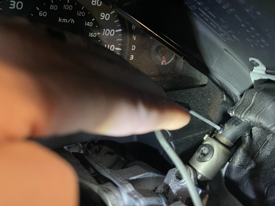

    I was having some sporadic issues with some fantom O/D button problems. Sometimes I’d start it and the O/D button would be on, sometimes it would just come on while driving. It never happened while traveling any too quickly so, it was never a problem. Just a bit annoying. Read the problem could be from the warn ground wire that runs down the shifter. Here’s how I fixed my problem:
    Remove these three screws and remove the steering column housing.
    The top cover can’t totally be removed because it’s got the shifter going through it. Just fold it up. The black wire coming out of the shifter is the culprit.
    You can see where it’s worn through the insulation.
    Fixed.

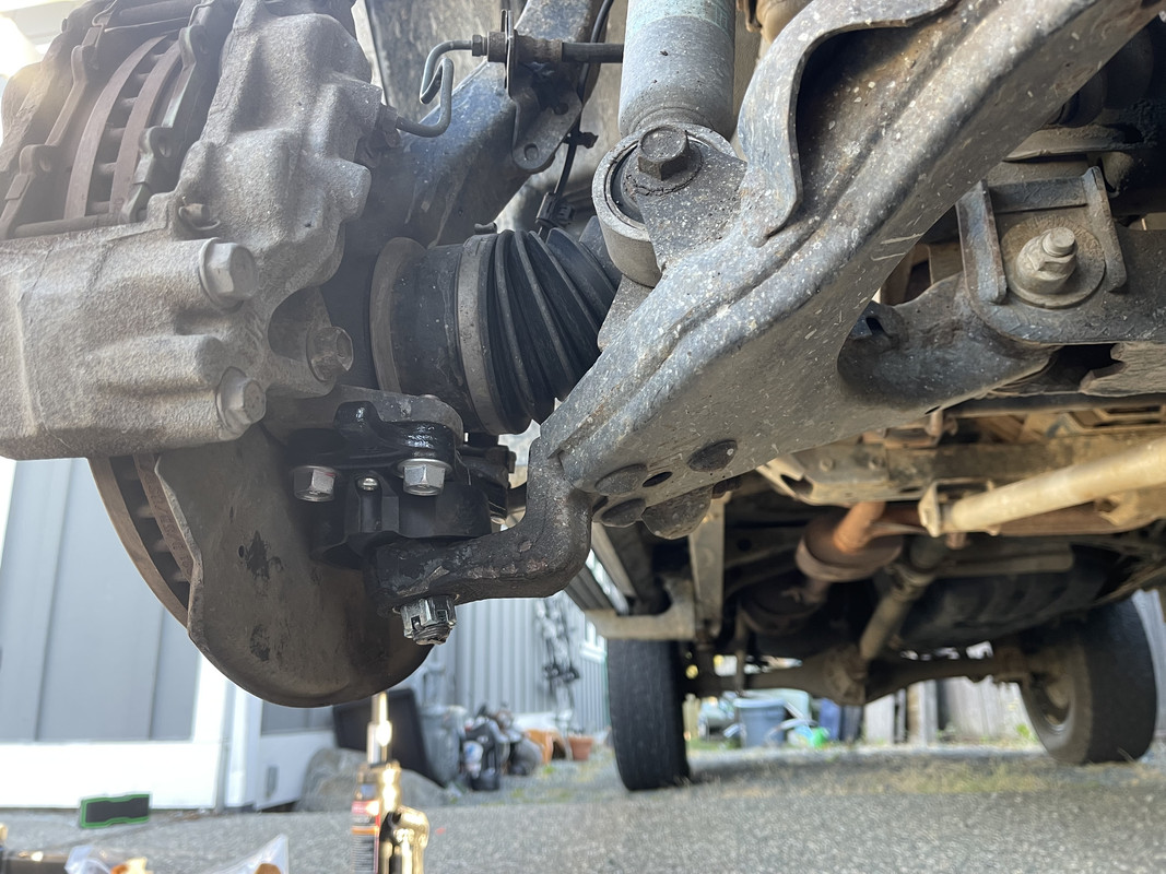

  26. Jul 7, 2025 at 11:33 PM
    #86
    Baller
    Baller [OP] New Member
    Jul 22, 2018
    #17275
    837
    '05 Tundra SR5 DC

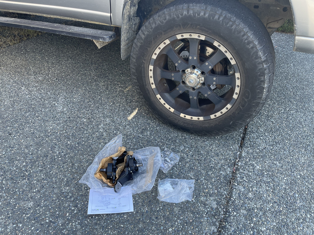

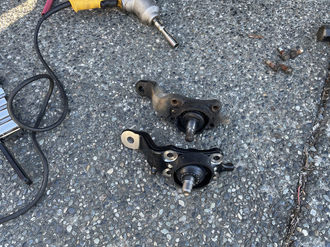

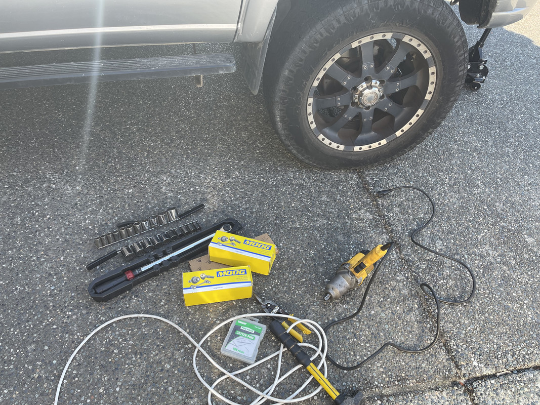

    I’ve got a trip planned to Flagstaff (2800mi round trip) at the end of the month. I replaced the unknown age and mileage OEM LBJs pretty shortly after I bought the Tundra. I replaced them with a set of 10yr warranty Detroit Axle LBJs. They’ve been solid, but the fact that everyone always recommends nothing but OEM has always been in the back of my mind. With the lengthy trip planned I pulled the trigger on a set of OEM. Pulled off the Detroit units and replaced everything tonight. I didn’t take too many pictures as I got a bit of a late start and knew it would get late quickly.
    All the parts needed.
    Out with the old, in with the new.
    Passenger side getting buttoned back up.
    Everything torqued down and back on the ground.
    A few things to note. The old LBJs were still very solid. I’ll save them for emergencies. Getting all four ball joints took a harder beating to crack them loose than I had anticipated. I don’t do much of this stuff and it always seems to need a bigger beating than I think. Once separated, everything was very easy to put back together. Really a pretty easy job. Both boots on my steering rack are shot. Gonna have to address that sooner than later. I also need a new set of sway bar end links. Post up what’s out there.
    KNABORES and The Black Mamba like this.

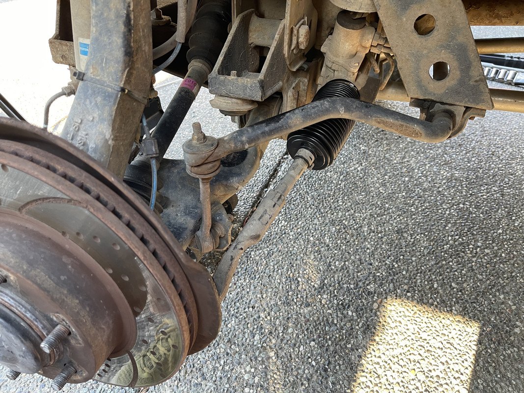

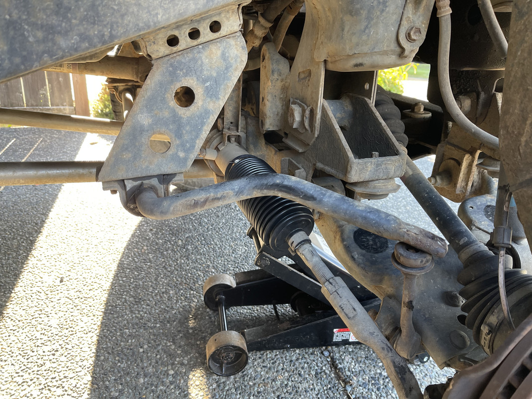

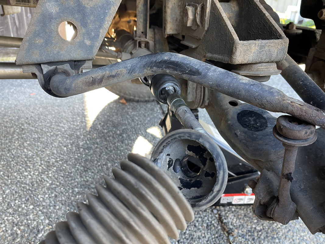

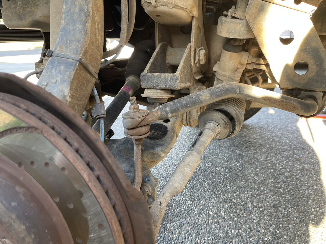

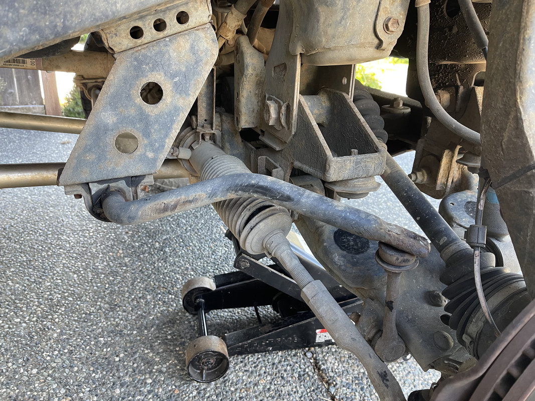

  28. Jul 10, 2025 at 8:04 PM
    #88
    Baller
    Jul 22, 2018
    #17275
    837
    '05 Tundra SR5 DC

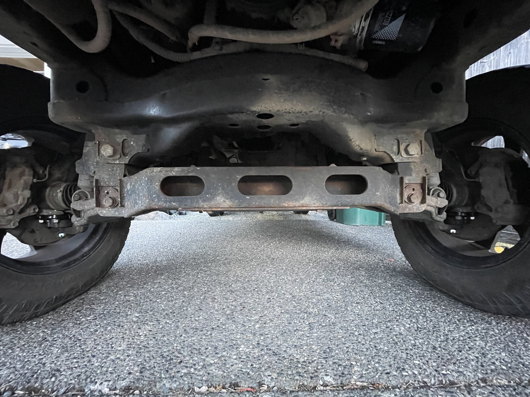

    While I was doing the LBJs I got a good view and realized the steering rack bellows were shot. Ordered up some Moog boots and got to work. I had to do the job quickly because I’ve got an alignment scheduled for tomorrow.
    Got everything back out.
    Not looking good.
    Really not good.
    Cleaned it up, regressed the joint and threw the new boot on.
    Same story on the drivers side.
    Same story regreasing the joint and replacing the boot.
    I know, I know. The sway bar links are already on their way. They shipped a little slower than the boots.
    The Black Mamba likes this.

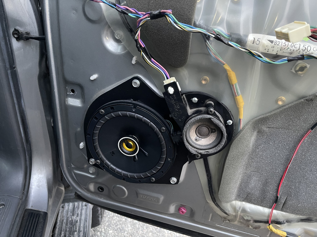

    Upgraded all the door speakers to Kicker CS series. Install was smooth with all the right parts. Sounds much better.
    Kicker speaker install
    The Black Mamba and Kimosabe like this.

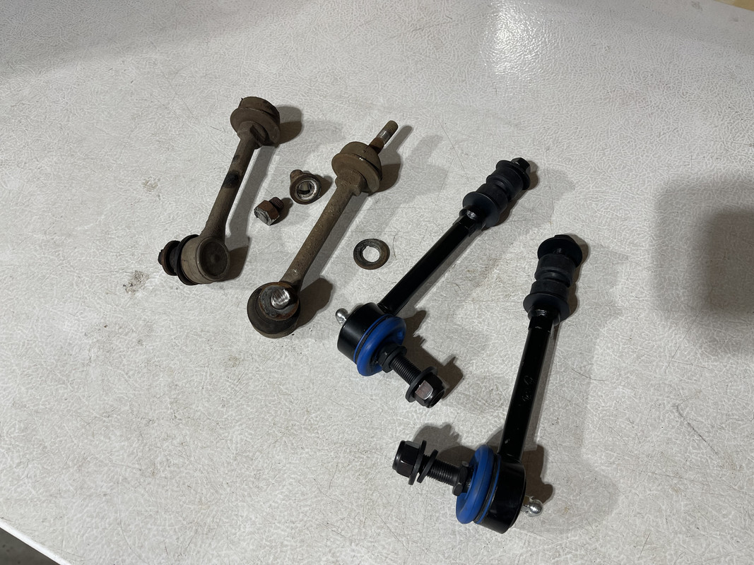

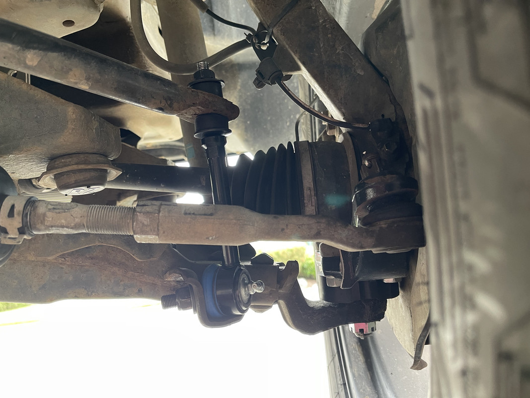

    My sway bar links were LONG past replacing. The top broke off one and both lower bolts had some solid rust. I just ended up cutting them off. Was a quick job that was, sadly, overdue.
    Out with old, in with the new.
    Greased the ball joints, installed them and they were happy as can be.
