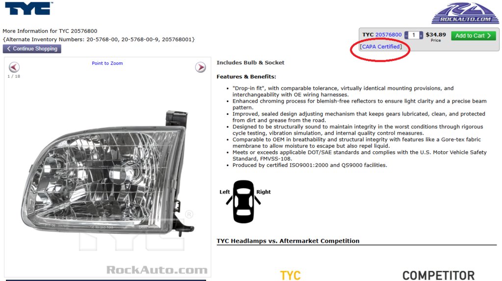

    When you're in the inventory section, note the dropdown, giving you options of regular vs. CAPA. Be very careful on the left, to make note of the cab type. You can't use any "Crew cab" or "Double cab" housings with your Access Cab.
    Beyond that, you'll also see this designation under the price when you click the "INFO" button, top right corner.

    Lol...I am obviously a novice using RA. Thanks for the tip. Upon doing this, only the left hand side has the drop down menu to be able to choose CAPA. Seems like I read where someone else encountered this as well. Hmmm....

    I did. I only have one CAPA certified housing. It is what it is. Check Summit Racing, maybe they’ll have something.
