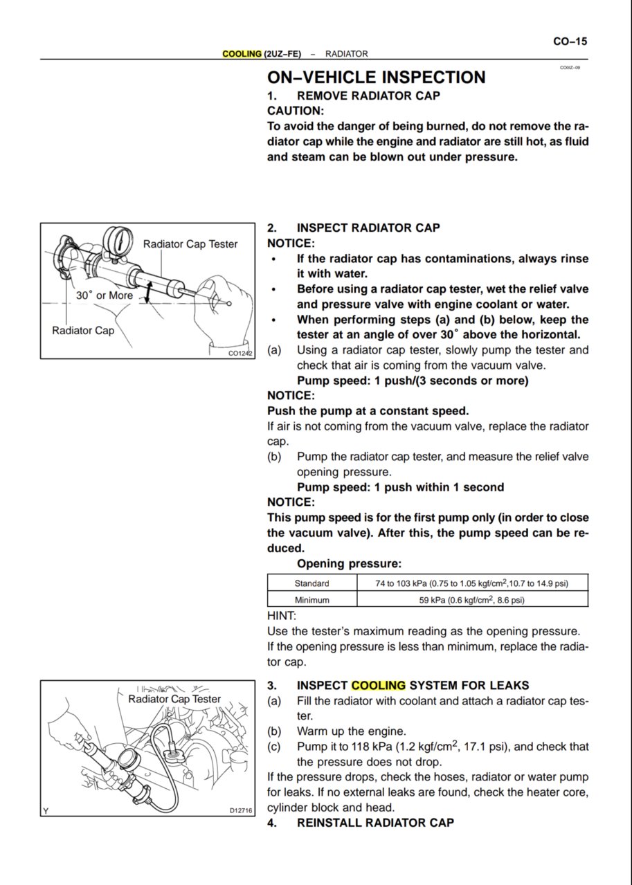

    Yessir.... My experience is sorta leading me to the conclusion I have some sort of issue in the coolant system itself that might be losing coolant as you suggest. Another idea occurred to me that there may be a pin hole on the sucking side of the water pump that does draw small quantities of air and that air accumulates while operating and this causes the problem when it cools and the air finds the same point of collection. When, after restarting, the air reheats it expands and overflows the reservoir. I don't know if that makes sense but there seems to be no running symptom on the combustion side of the equation. As posted before the oil is dry, the coolant not oily. The coolant in the overflow smells of antifreeze rather than petrol or exhaust fumes. The spark plugs are clean, as in normal fuel burn with no sign of oil consumption. The electrodes have no appearance as to being "Steam Cleaned". A mirror held at the tail pipe does not gather condensate... The Truck starts with no thought needed just turn the key... If it turns over once or twice it is running...
    I did replace the Original Radiator cap with an OEM replacement that is listed at 24.1 psi.... Unless that is not the correct value it seems to be working properly.
  27. Apr 8, 2023 at 2:55 PM
    #57
    assassin10000
    assassin10000 New Member
    Oct 27, 2020
    #54157
    2,310
    Andrew
    Northern CA
    '05 SR5 AC 2wd
    Too high. And probably not working correctly.
    Should be way less. Put your original on there or get a denso, koyo or other good brand cap and see what happens.
  28. Apr 8, 2023 at 3:10 PM
    #58
    ALMDawgfan
    ALMDawgfan [OP] New Member
    Mar 29, 2023
    #94611
    45
    2004 Tundra 4WD Access Cab
    !!! Too high? The original had no designation on it at all. The next down is something like 18.1 psi.... I got no problem getting another but the vin search gave me that cap.... Sorry, the 3001 final designation was the thermostat part number... It was in my head but not the cap's part number.
    The original was broken and in two pieces hence this is where the problem began...
  29. Apr 8, 2023 at 3:20 PM
    #59
    assassin10000
    Oct 27, 2020
    #54157
    2,310
    Andrew
    Northern CA
    '05 SR5 AC 2wd
    Should be around .8-.9 bar. 13ish psi give or take a couple psi.
  30. Apr 8, 2023 at 3:27 PM
    #60
    ALMDawgfan
    Mar 29, 2023
    #94611
    45
    I like it. Our local O'Riley's will lend you a tester.... Might see what Harbor Freight has to offer...
