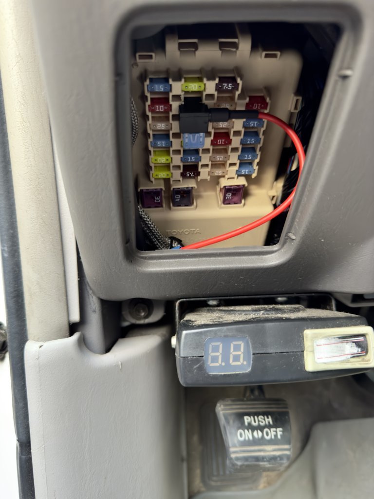

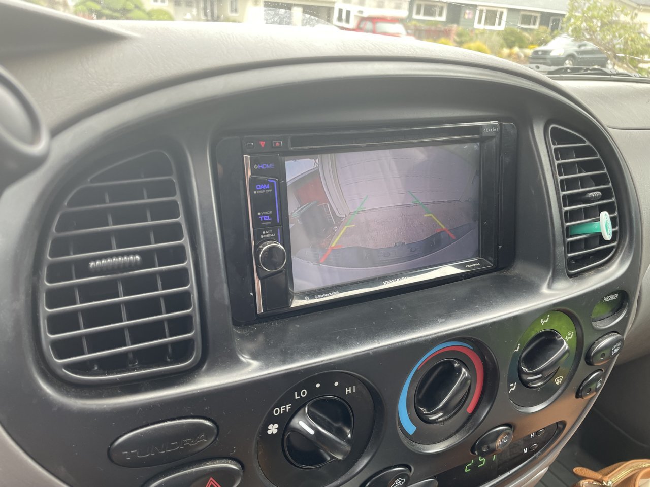

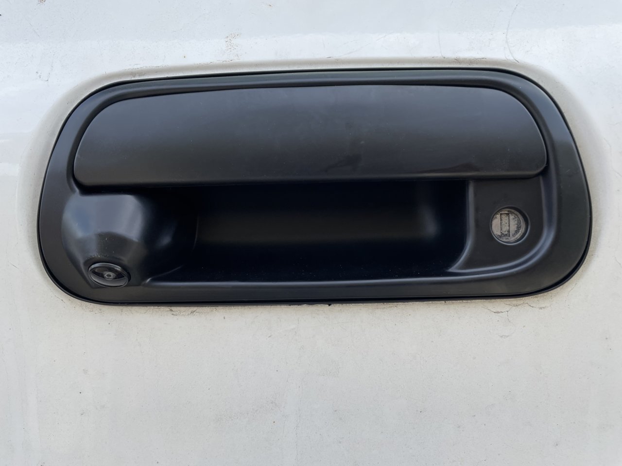

    Installed the master tailgaters back up camera. Pretty straight forward. Spliced into the reverse tail light wire. Handle seems to be decent quality. Video isn’t all thar amazing but I can see which is all I wanted

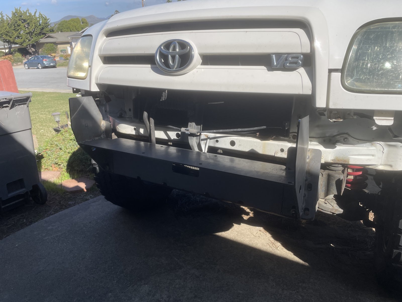

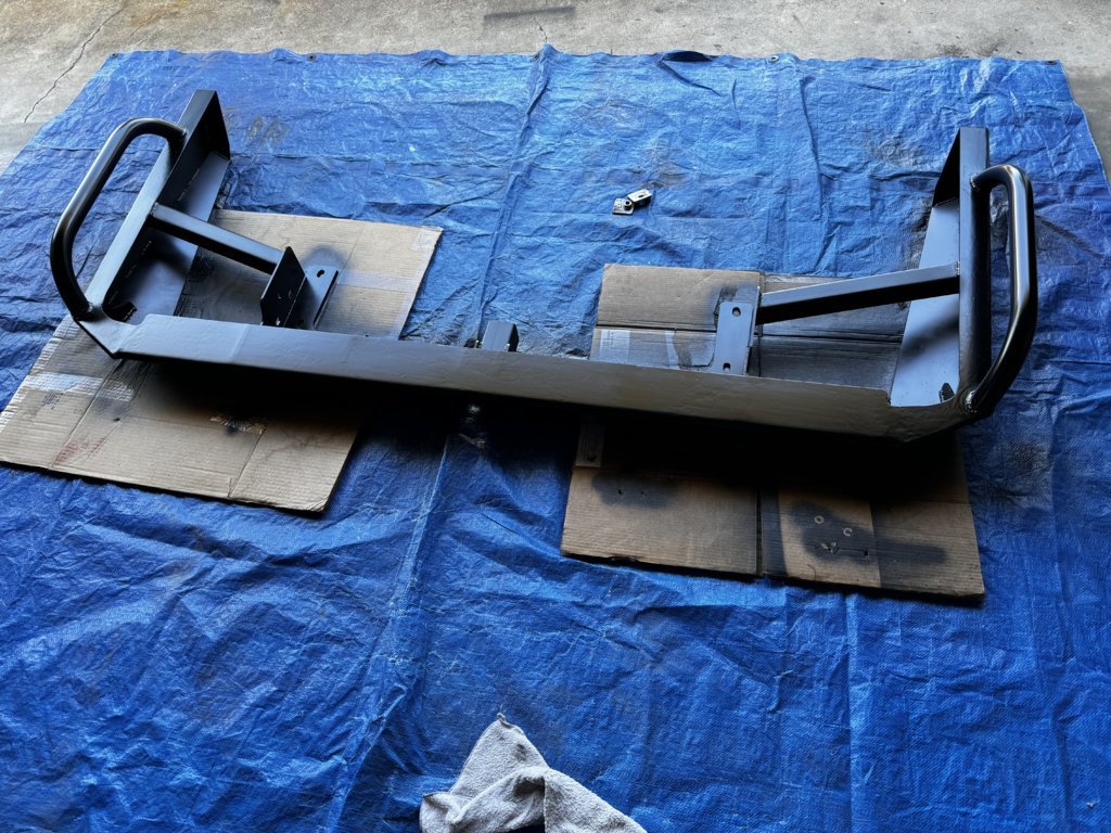

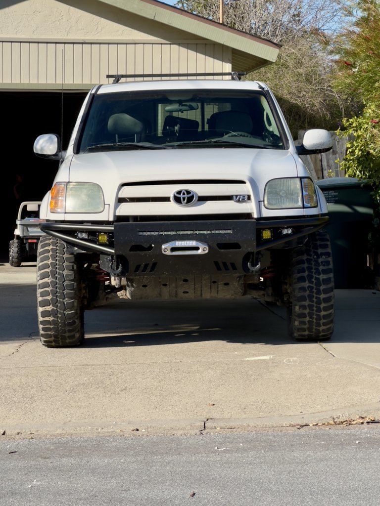

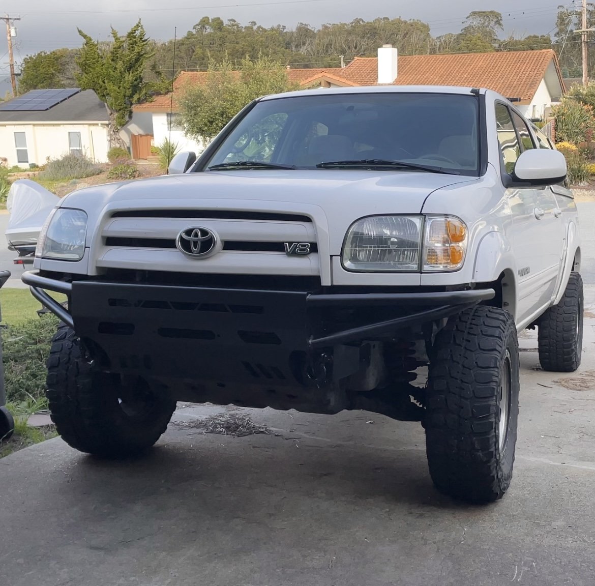

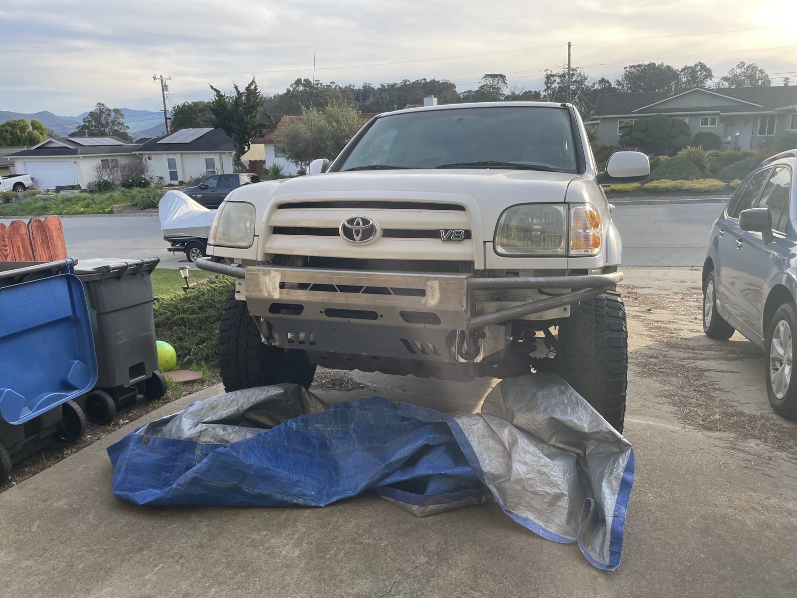

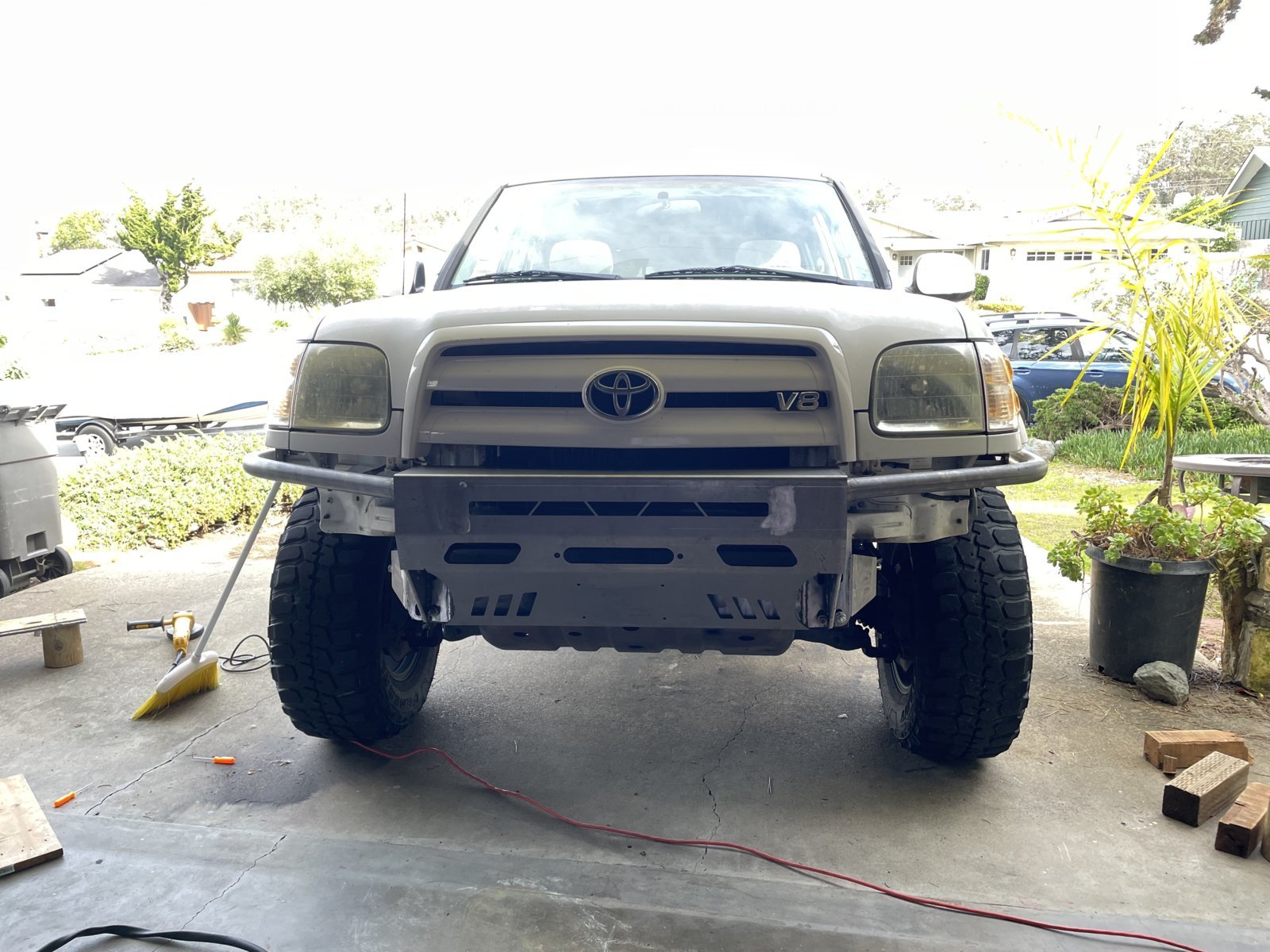

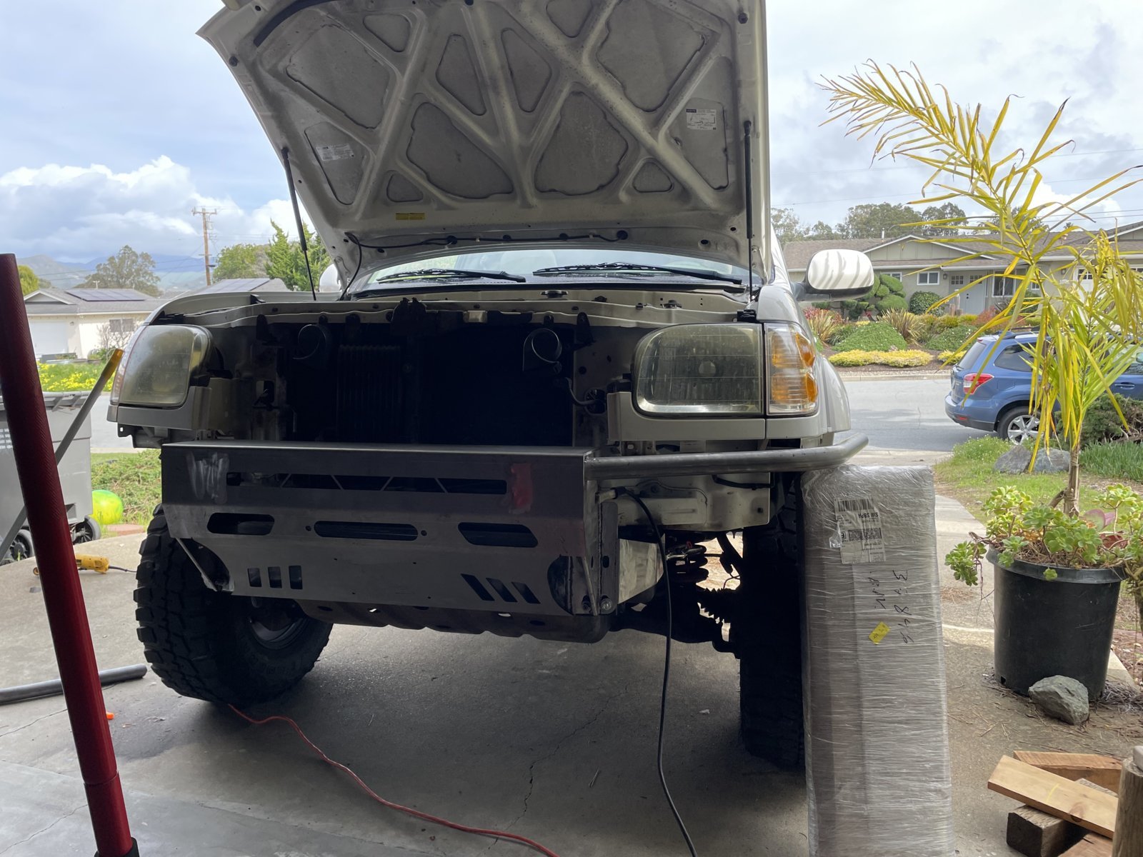

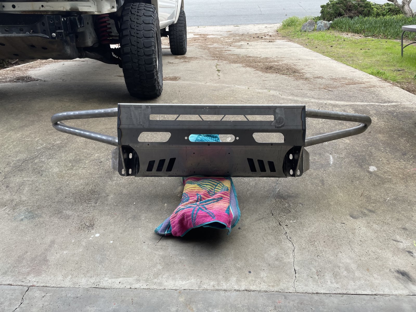

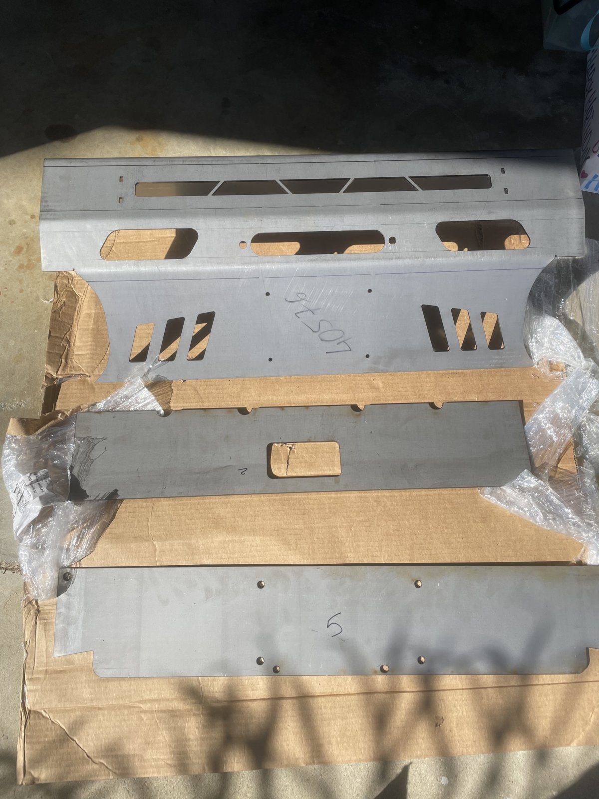

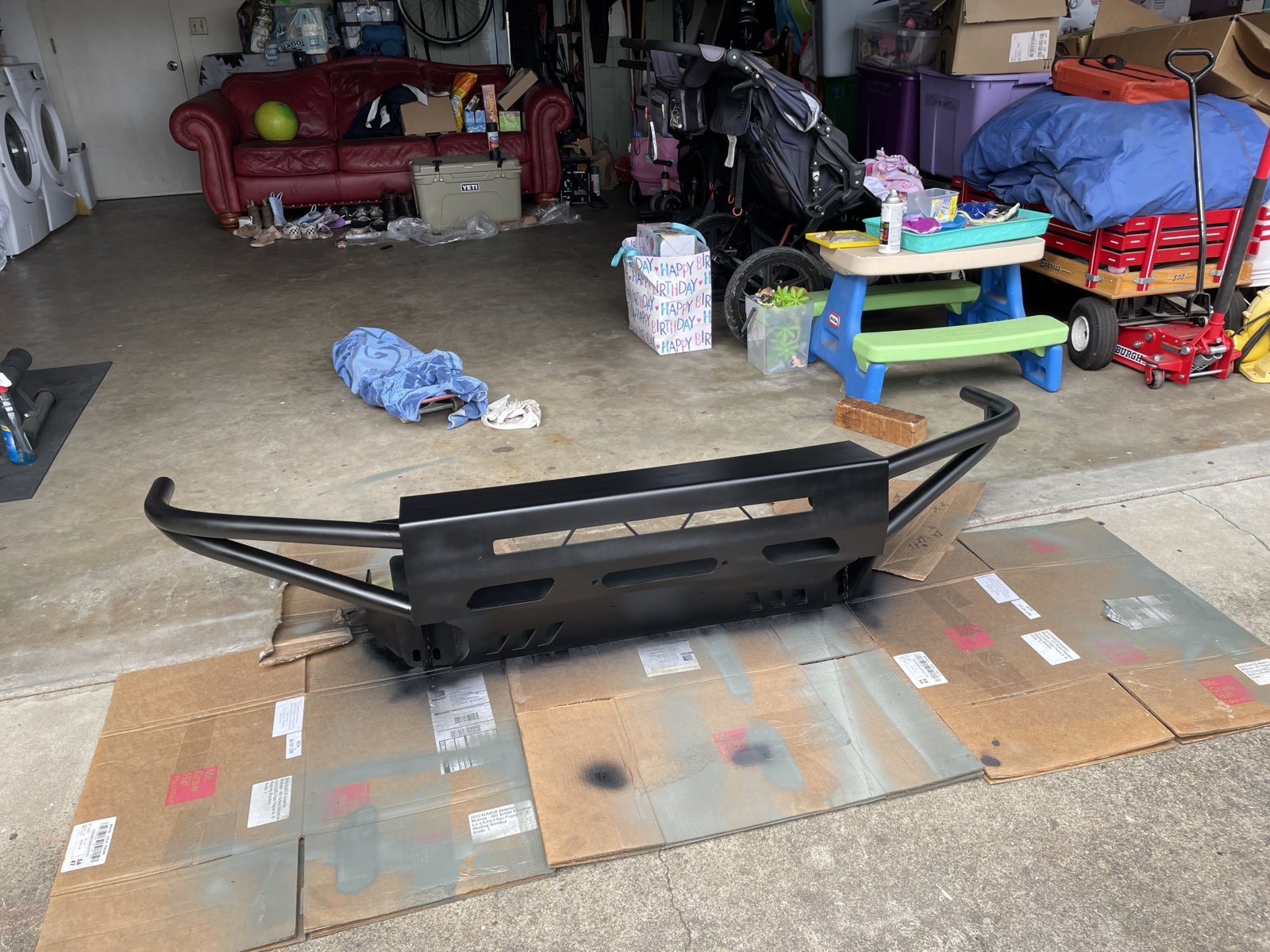

    Custom built Coastal off-road hybrid front bumper:
    ordered just the center section from coastal offroad as well as 4 x 4ft 1.75” .120 wall DOM tubing.
    My first real project fabbing and welding. Overall loved building it
    coastal offroad center section, overall like many have said pretty easy DIY kit. Got everything tacked up pretty quickly.
    The tubing took some time, bending, test fitting, bending, test fitting, etc.

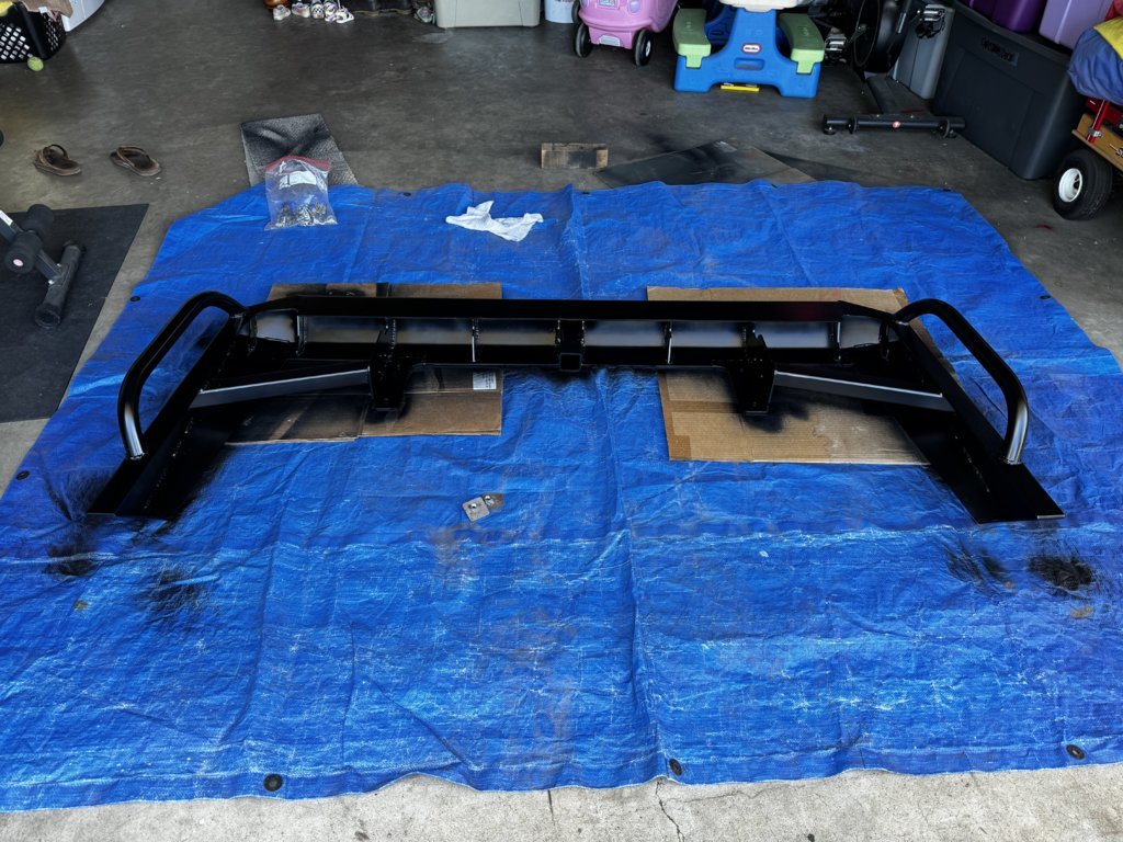

    Plenty of grinding, sanding to make it look good. Some self etching primer and rustoleum rattle can and it was ready to bolt on
    Not perfect but loved how it turned out!

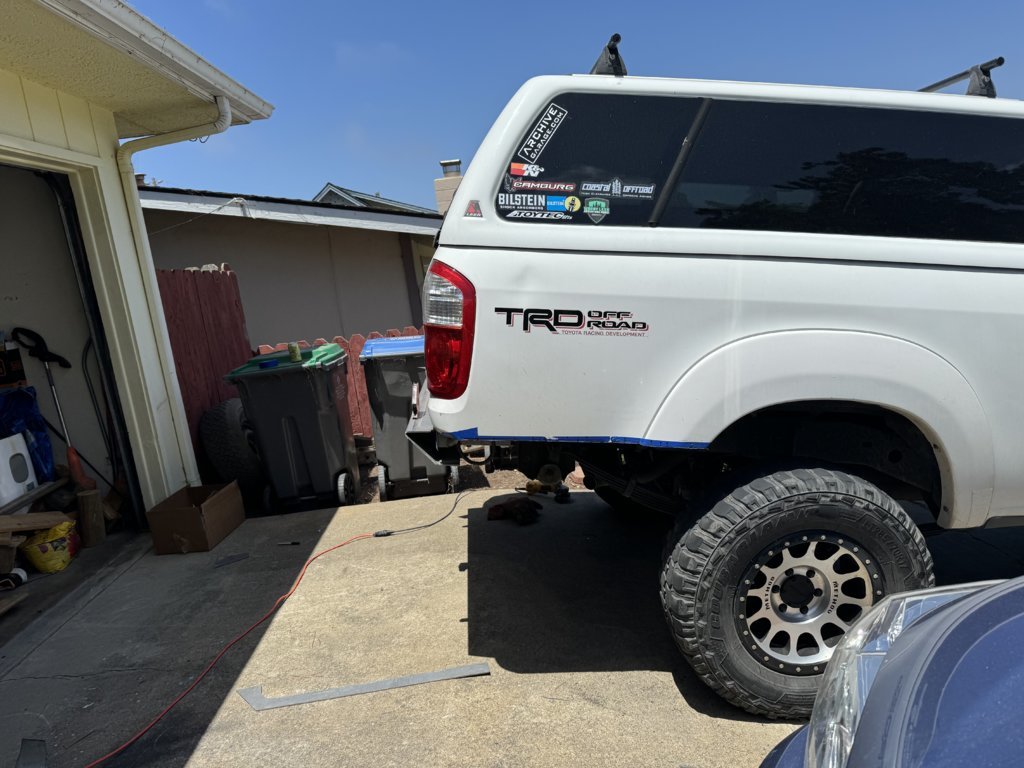

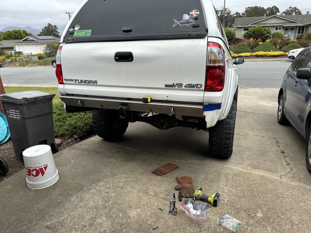

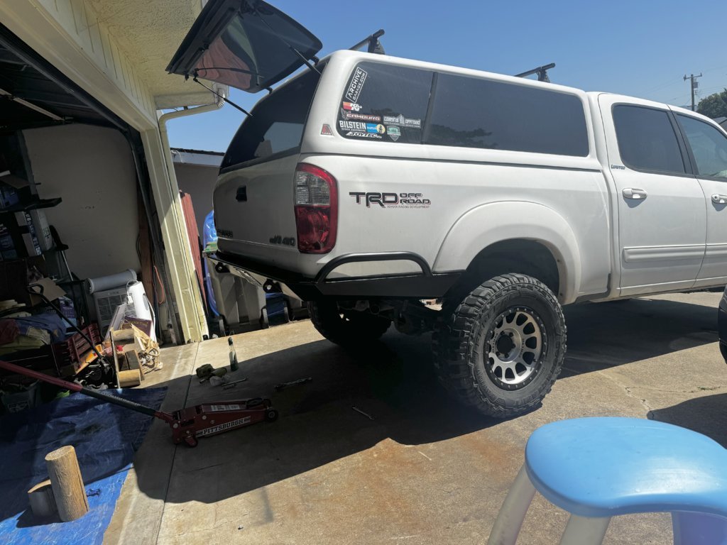

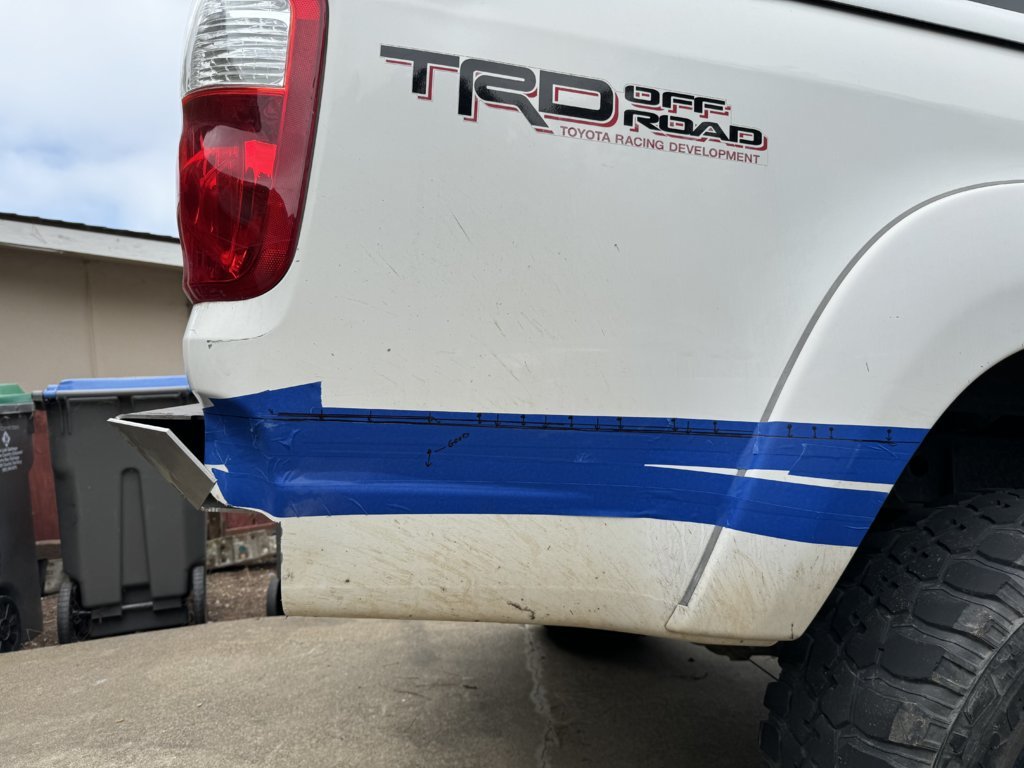

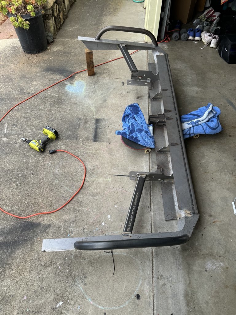

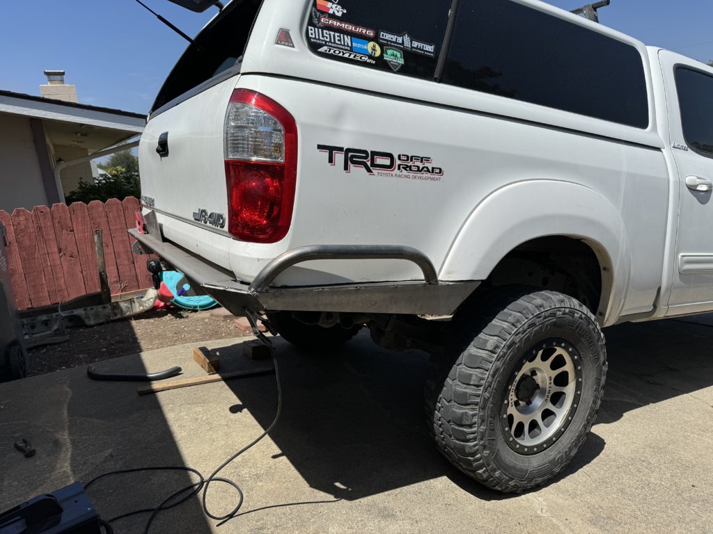

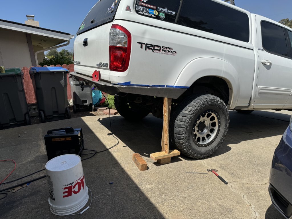

    Built a coastal offroad high clearance rear bumper. Man it was scary trimming the bedside
    after that just continued with the build. Definitely helps if you have a buddy
    after welding and grinding it was time for paint and install

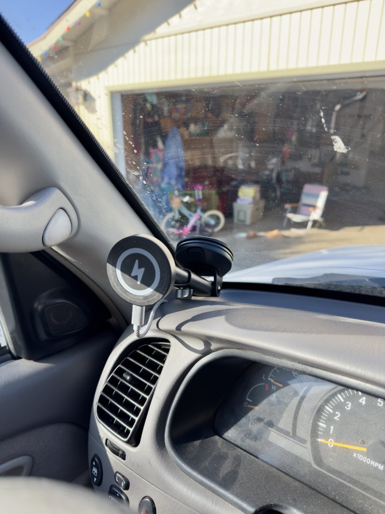

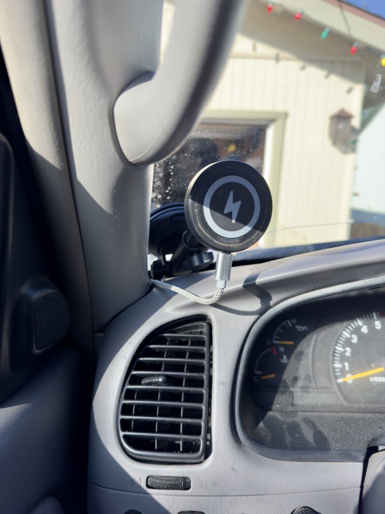

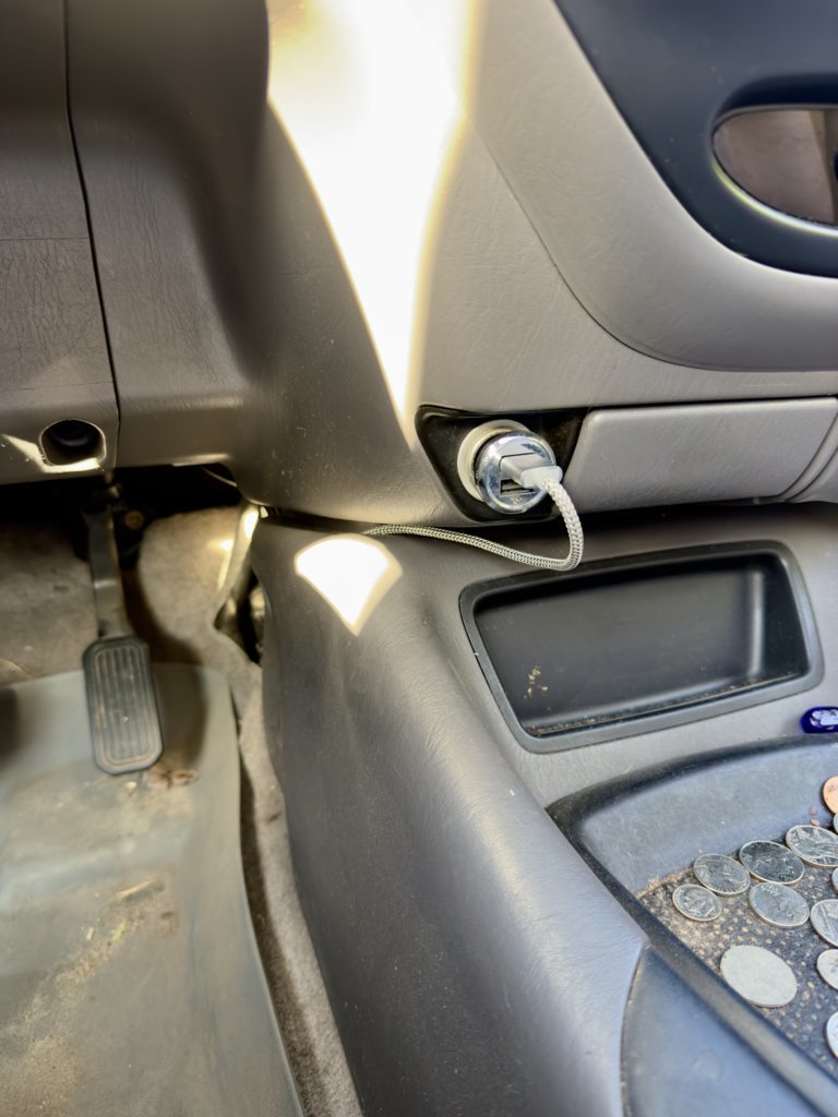

    Installed a phone mount. Ran the charger cable behind the dash

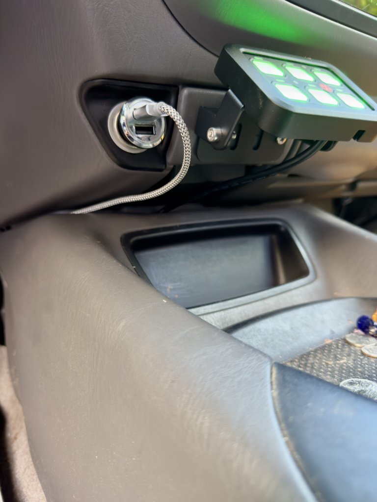

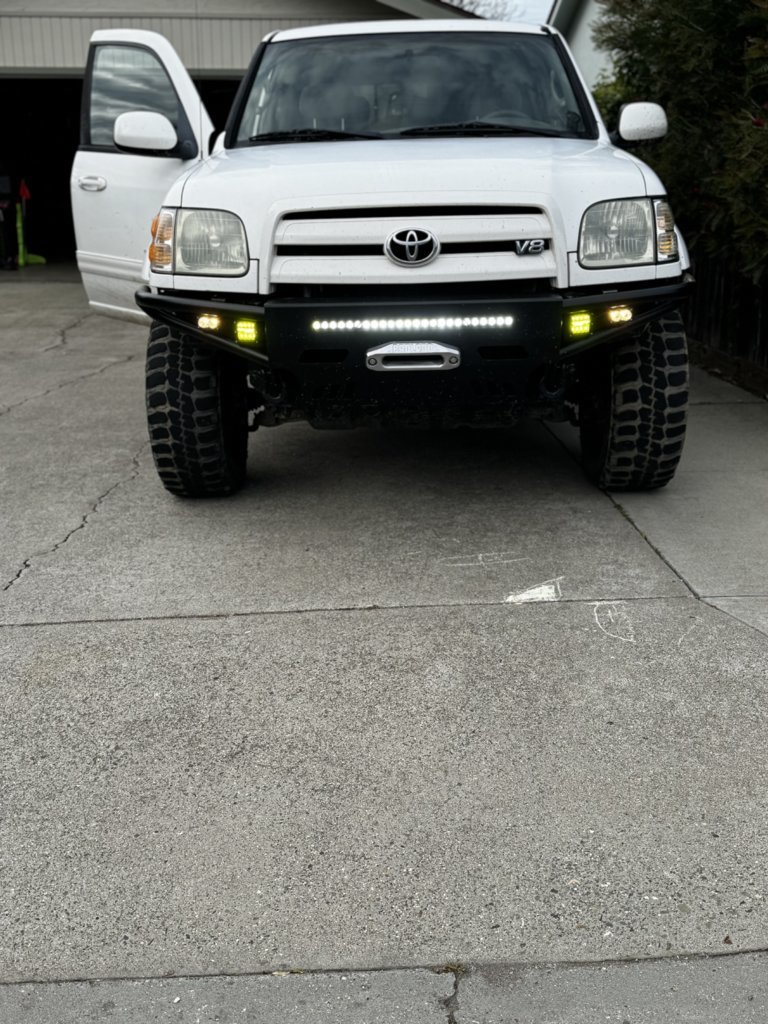

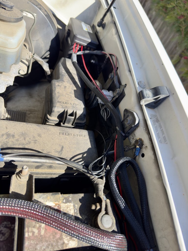

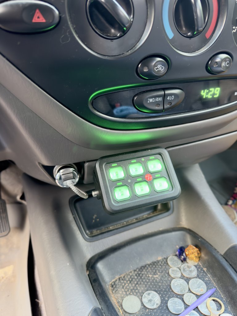

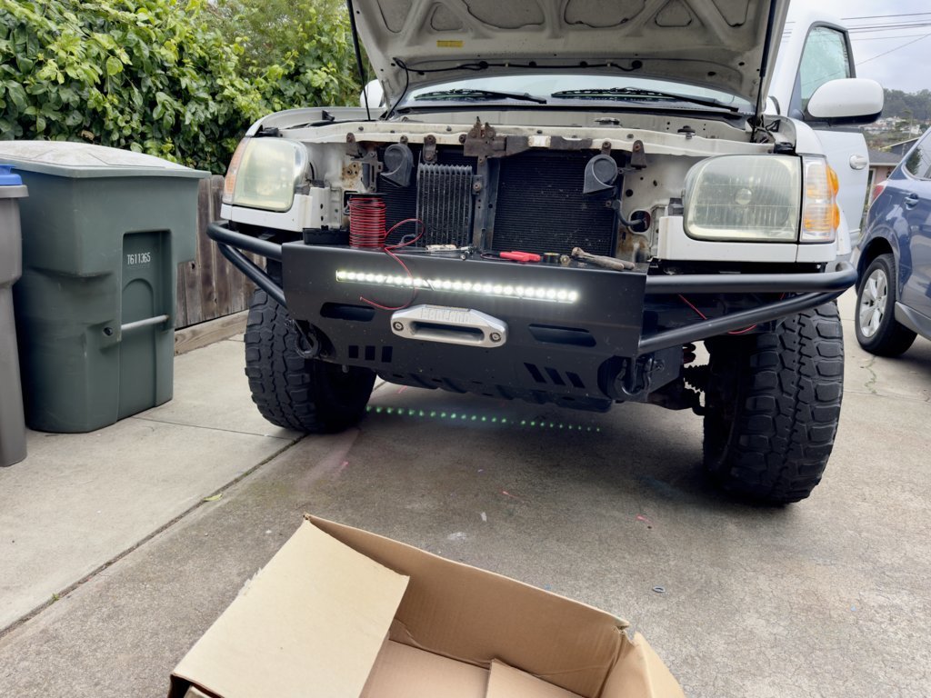

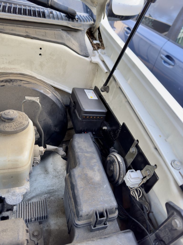

    Decided to give Nilight a try. Ordered their switch panel and lights. Seems very comparable to auxbeam. So far so good.
    built a custom bracket to mount the control box in the engine bay
    Wired up the switch panel and mounted it here
    Built and welded some tabs for the lights. Wired them all up

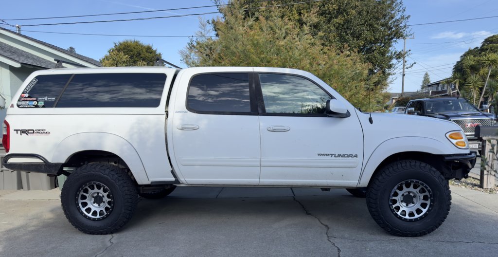

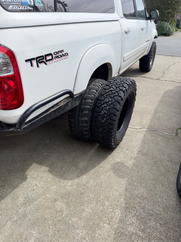

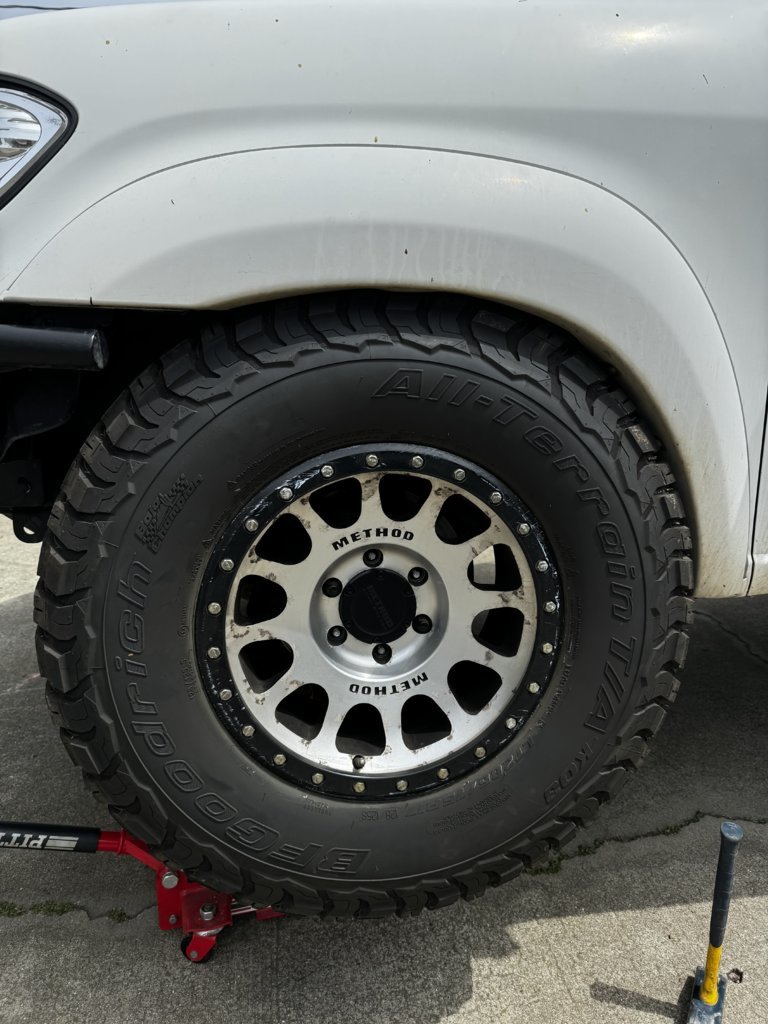

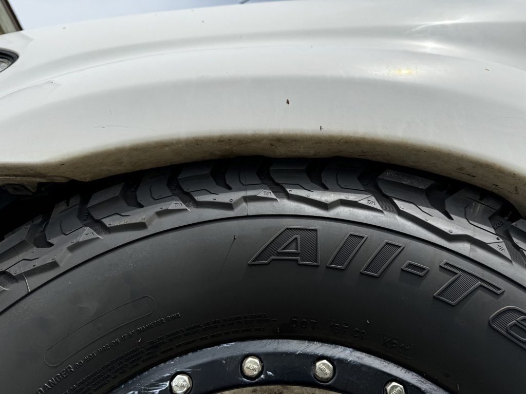

    Got some new shoes, went up in tire size.
    285/75/17 BFG KO3s

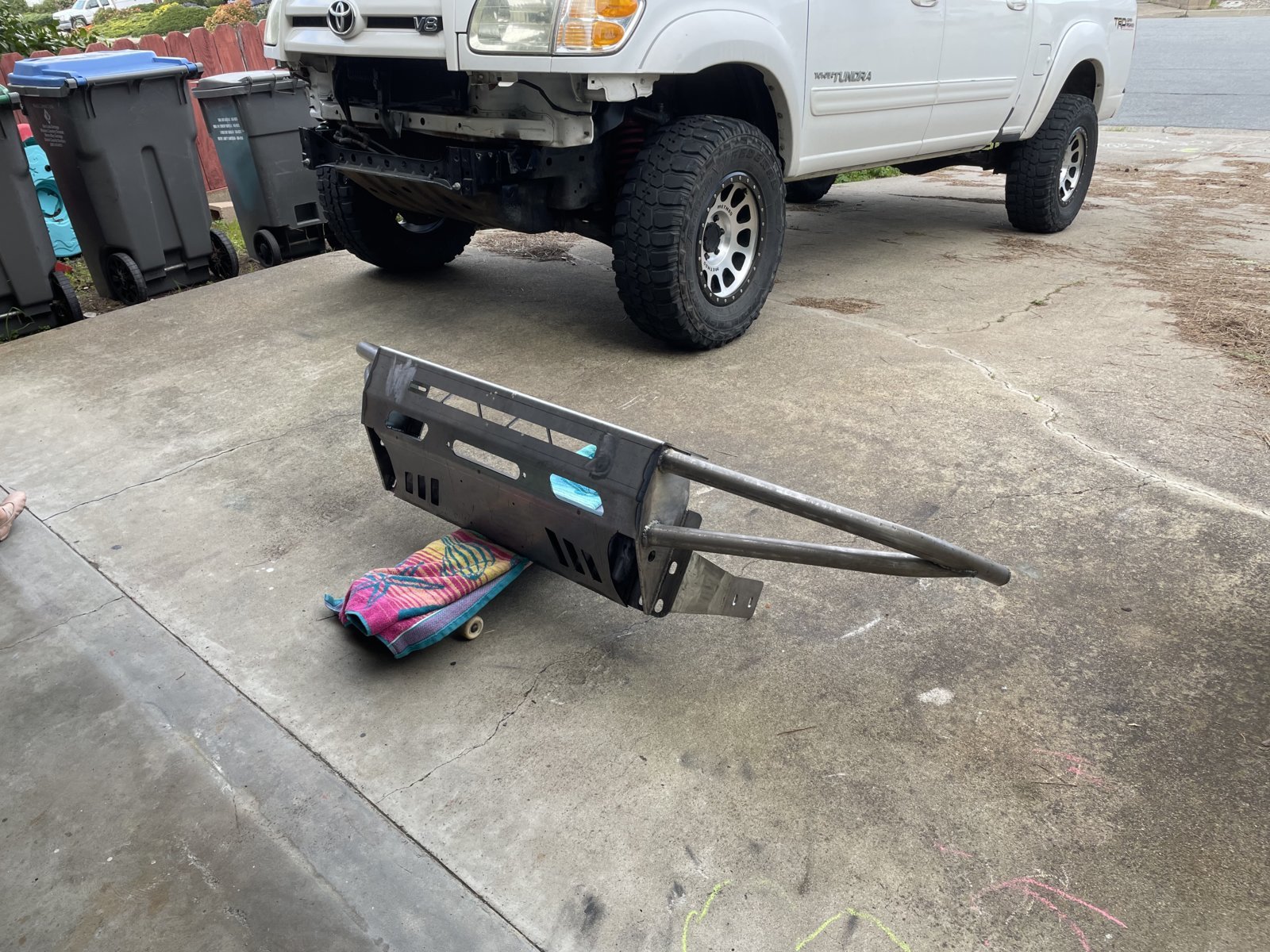

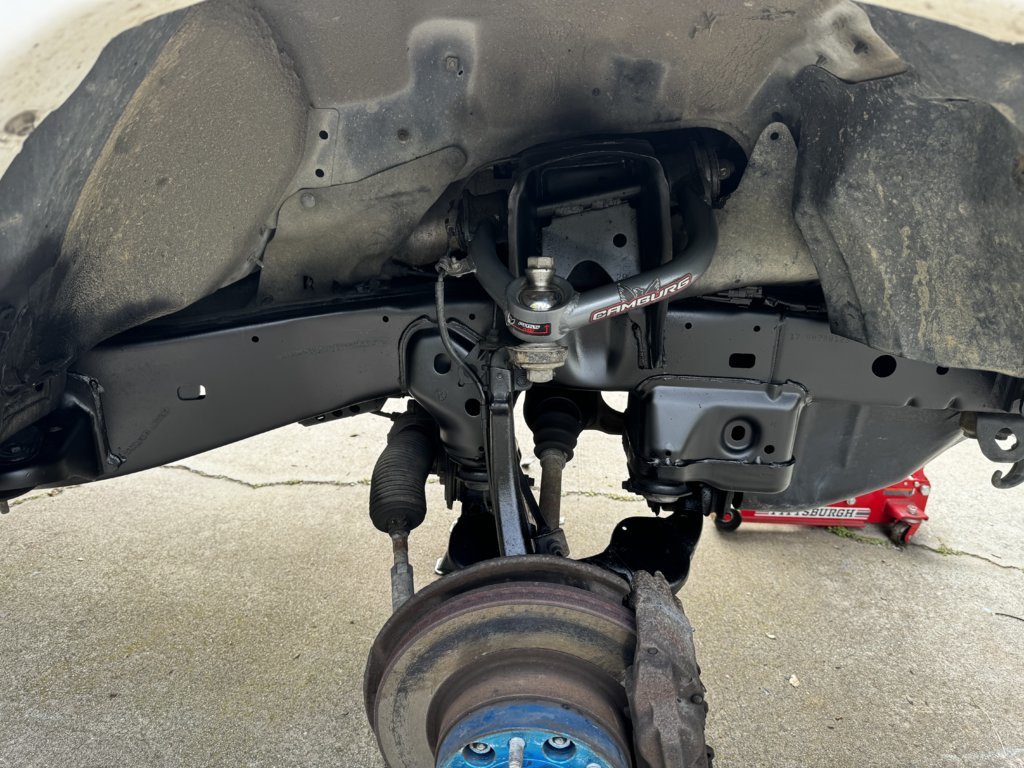

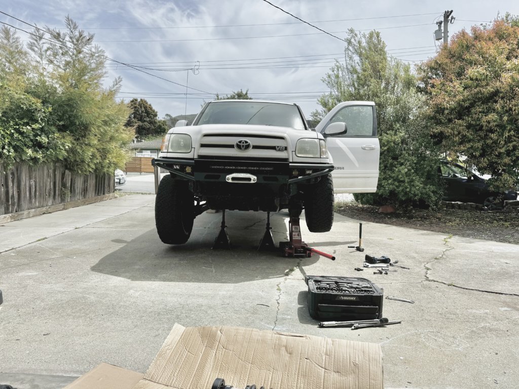

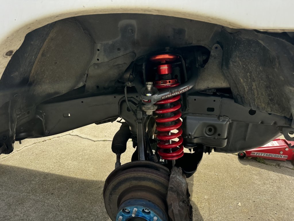

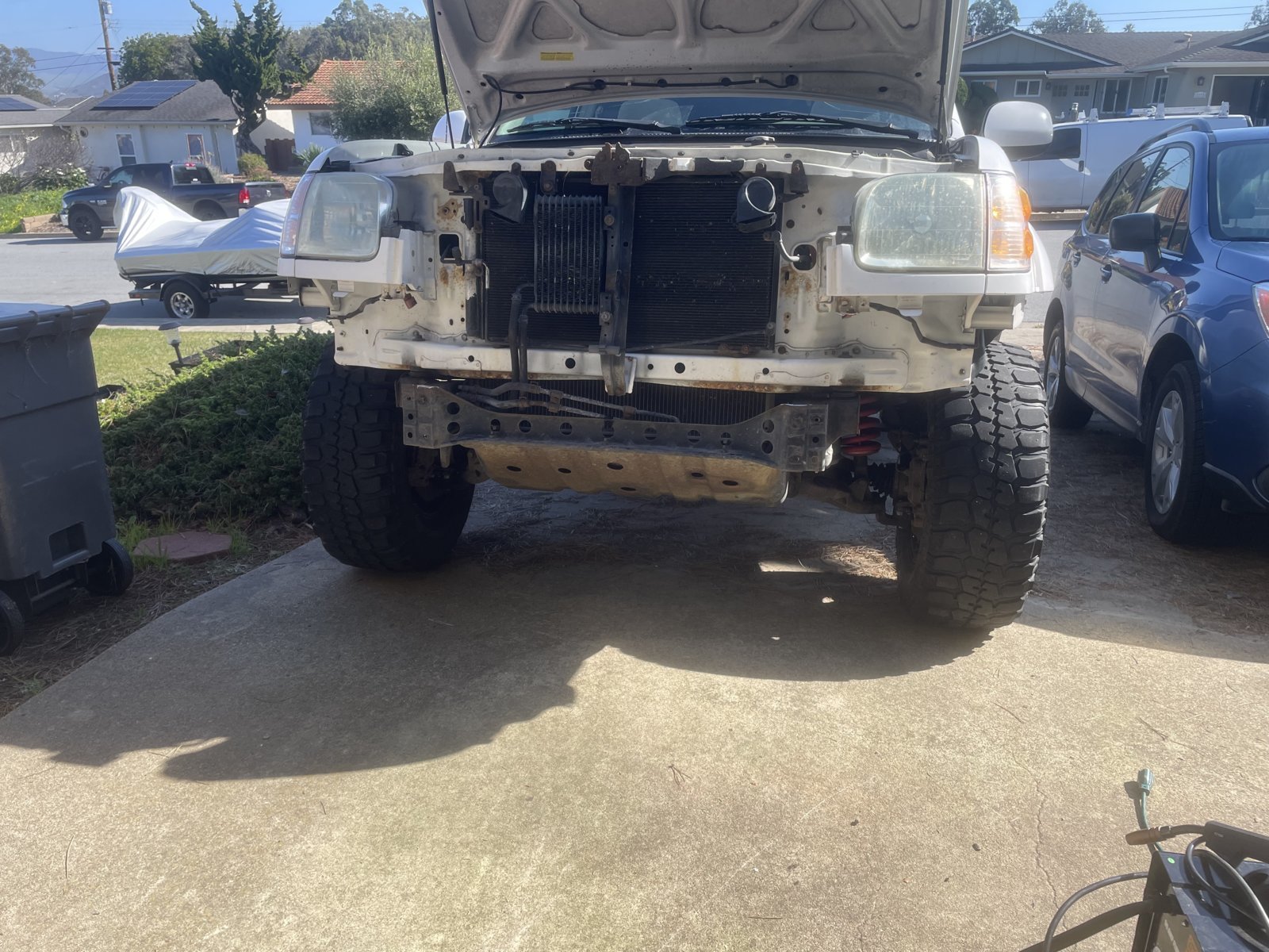

    Time to properly fit these tires, at full bump they rub pretty bad. Wheel spacers don’t help at all. Cleared as much as I could without having to modify the entire fender and firewall. Extending bumps about 1/4”. Decided to refresh the front end while having the suspension out
    IMG_3118.jpg IMG_3112.jpg IMG_3113.jpg IMG_3125.jpg IMG_3124.jpg IMG_3126.jpg

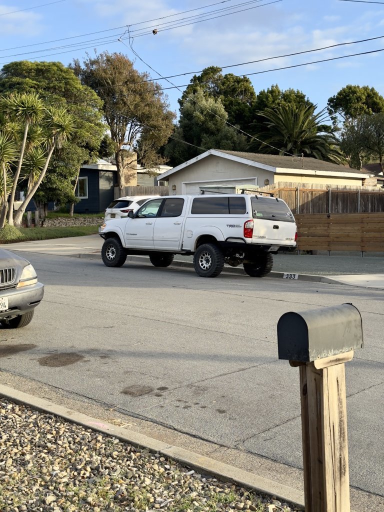

    Recognize Plaskett!!!

    yes sir! Such a cool campground, I go all the time since it’s only about a hour from my house

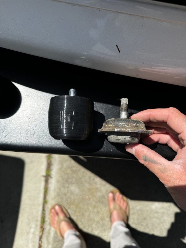

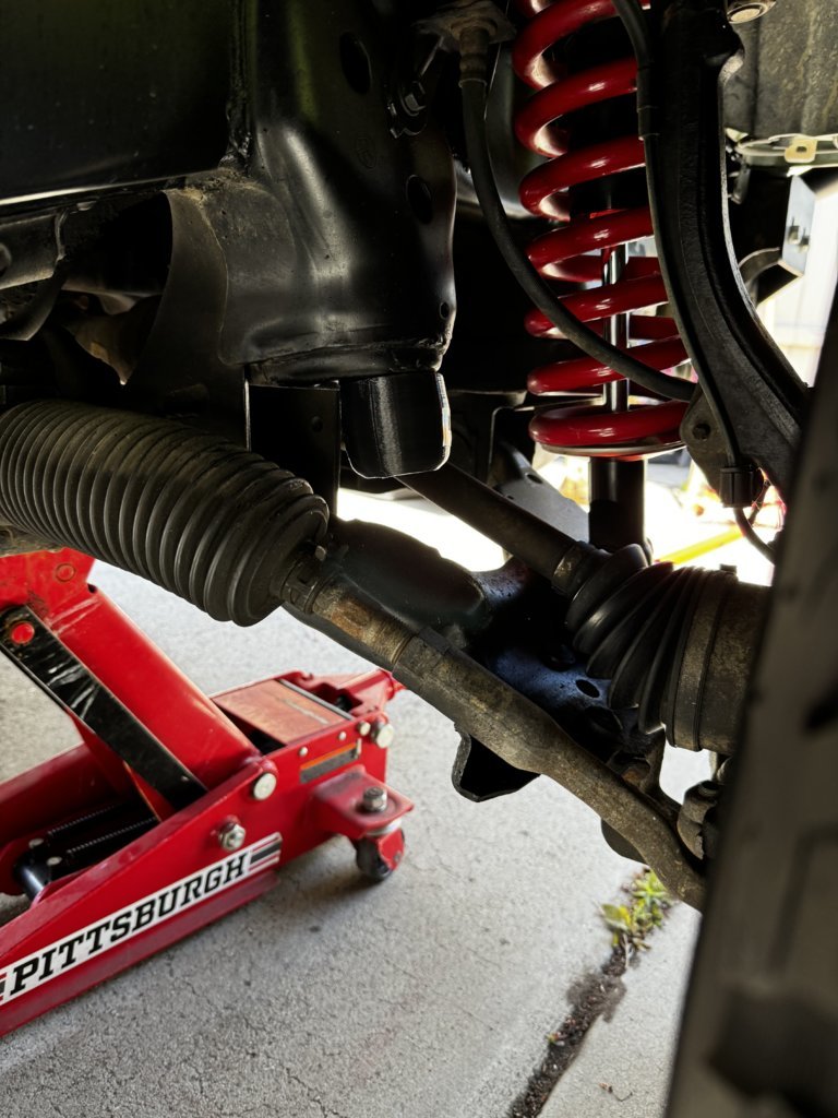

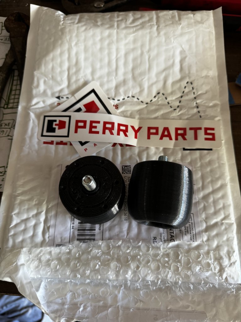

    Installed some Perryparts front bumpstops. Went with the larger of the two options since I’m running 34” tires.
