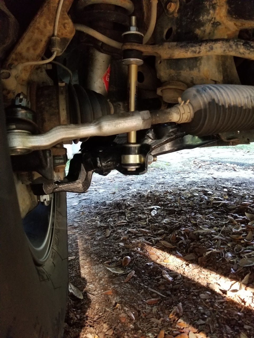

    Because everyone needs pictures I attached a couple of the items prior to installing. Slight miscommunication with my mechanic as I wanted to get the Icon coilovers and Camburg UCA's prior to installing the suspension components but he knocked everything out so I will get those in the near future.
    Next steps:
    • Icon Coilovers upfront
    • Icon Shocks in the rear
    • Camburg UCA's
    • Toytec's Roof rack
    • Brute Force Bumper - after studying this, it has one more angle that the Coastal doesn't which fits our body line a bit better so changed my mind here
    • Pinch weld mod
    • Remove the crappy interior led lights I bought - swap back to warm lights or better LEDs - Recommendations appreciated!
    I will get some updated pics once I pick the truck up!Suspension.jpg suspensionmaxx.jpg

  30. Oct 13, 2019 at 11:36 AM
    #30
    imDementeD
    imDementeD [OP] New Member
    May 30, 2019
    #31182
    694
    2003 Tundra Limited 4x4 Trd Supercharger
    Washed her up today and took some pics of the parts installed. The truck has been running MUCH better than last time.
