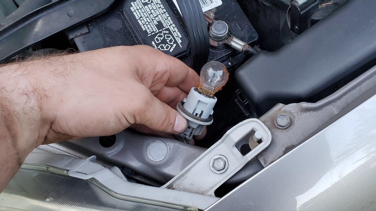

    Changed front turns to 1157, and LED using "old" bulbs from the Sequoia. Below is a shot of the old, crusty Drivers side, but both bulbs were like this.
    In the below picture the passengers side is the only one changed.
    NUDRAT likes this.
