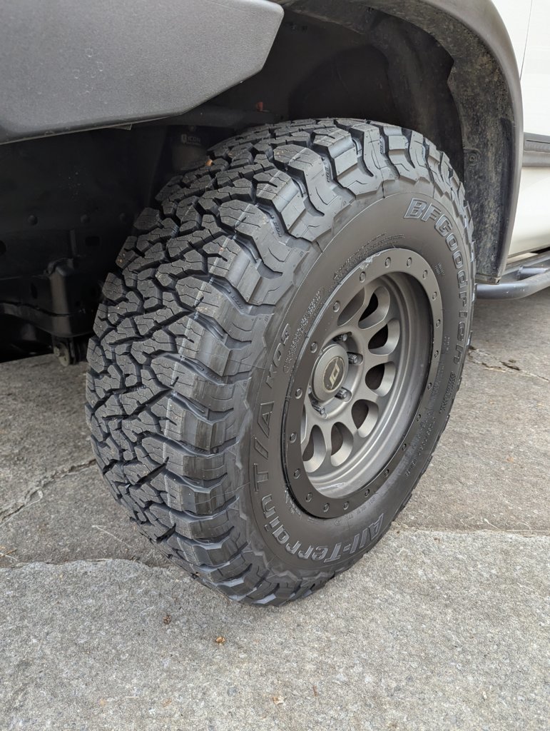

    Half worn out 265/75-16 bfg at tires rub on my frame. A 265/75-17 tire is 1” taller than my half worn bfg’s…which might make them closer to 1.5” taller than my existing tires. Undoubtedly your suggested tire size choice will rub on the frame.
    Keep in mind that the base model v8 tundra came with 245/70-16 tires and 3.9 R&P. The optional 265/70-16 tires with the 3.9 gearing made the truck slower and get worst fuel economy. If you were to tow or haul anything with the original little 245/70-16 tires, the 3.9 gears were barely adequate. The simple fix was to swap in 4.10 gears. If i had the taller 265/70-16 tires, i’d swap in 4.3 gears. If i were to swap in 265/75-16 tires i would either steer towards a 4.3 or 4.56. A 33” tire and i’d probably be looking at 4.88.
    I normally run a fairly small and skinny 215/85-16 tire in my 2004 4wd access cab. I also swapped in 4.10 gears. I’d actually like to drop my gearing a little bit lower to a 4.30, but i only paid $64 total for both my front and rear 4.10 3rd members. I also have a second set of tires and wheels that are the half worn 265/75-16 bfg’s. The only reason i have a tire that large is because i found them in the back of my shop and they weren’t being used on any of my other trucks. Pretty much the only time i use the larger 265 tires is when i need a deeper traction tire. And my truck does see quite a bit off offroad work abuse.
