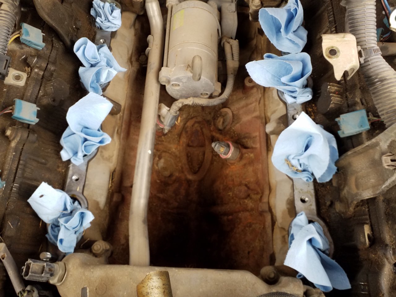

    Ok I've got it apart and I'm to the starter. How in the world do I get to the bolts on the back of it? Do I have to get under the truck and go through to them or what?

    I have no idea. You're only the 2nd person I've seen mention the repair. They put the starter in a horrible spot but they apparently don't fail very often. Let us know how it goes. Sorry I can't help.

    Up top. 14mm bolt head. If you find a rodent nest in there, check for chewed wires while your at it. Mice love knock sensor wires!
