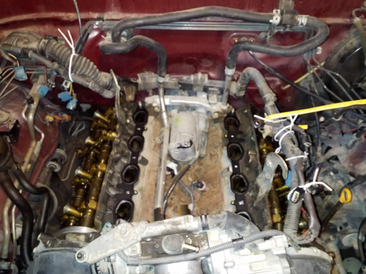

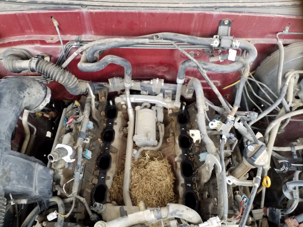

    If it is the starter it's not to hard to get to. I've pulled my intake twice and can do it in about 45 min now. As for replacing the starter I'm not sure.
    With power adding rats nest
