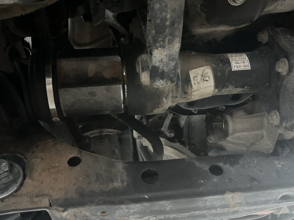

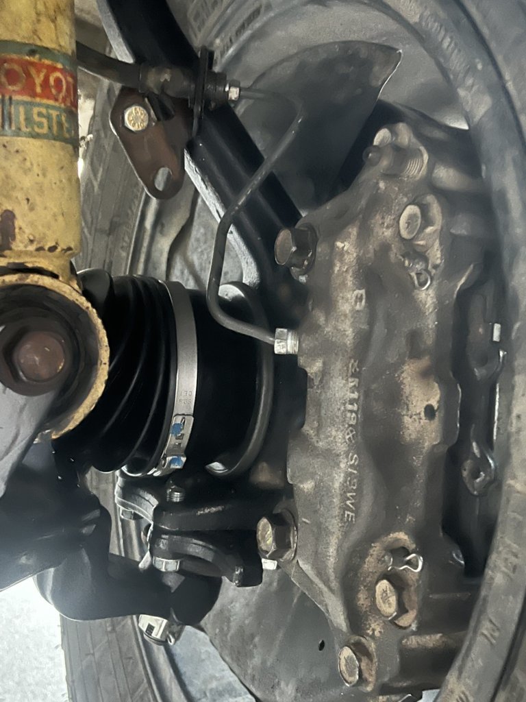

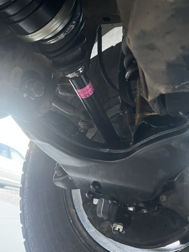

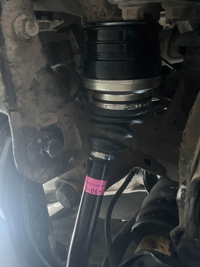

    I just did wheel bearings for the second time and am positive they were installed correctly. The wheel bearings are oem. Also installed a new axle from Toyota oem with the pink stickers.
    After putting the new axle one the one side, the wheel will not spin when the axle nut is torqued. I have been tightening to 170 ft/lbs.
    The axle will spin when I use my hand to spin the rotor when the axle nut is loose, however once I tighten it, it will not spin at all.
    The other side has an unknown axle on it and is not oem, but it's the one that's been on the truck since I bought it, and that side spins fine with everything tight.
    What am I missing!!?? I am not going to drive it till I figure it out because I am worried It will blow up the brand new wheel bearing for the second time.

    Let's see some pictures.

    Here are photos of each side
