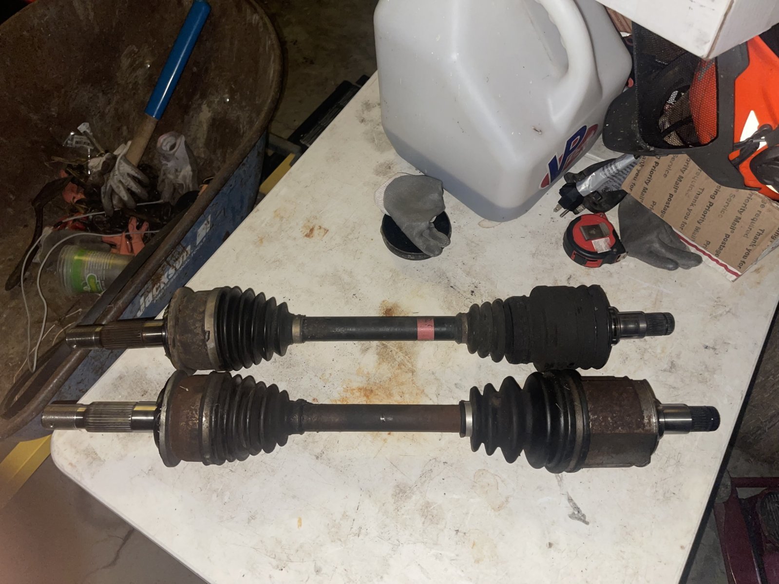

    Here is a picture of the two axles I removed, there seems to be an obvious difference in length. The oem remaned ones I got are both the length of the shorter axle. WTH..

    Thank you for pictures, that helps a lot. Top axle is OEM. Bottom one is an aftermarket axle. It looks like the aftermarket may be longer to me... Since the axles are being rebuilt anyways, I would cut the boot and fully extend the plunge joints on both and get a measurement to verify.
    Dealer won't take the aftermarket one for a rebuild core even if it was the right one. If you're using someone else to rebuild or reboot them, I'd try to find a used one that looks exactly like your OEM one.
    Get the correct CV axle, re-do the bearing work, and I bet you'll be having a better time.

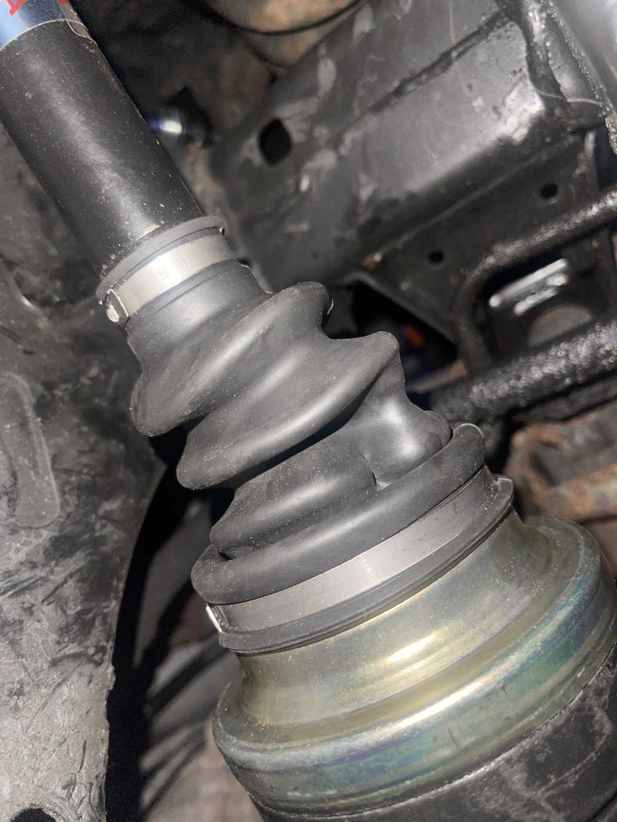

    This is what the passenger side drive axle boot looks like on the diff side. Is this normal? Could this have something to do with over loading the bearing?

    The boot is just spun (twisted?). Grab it by the Oetiker clamp and rotate at the clamp to get it straight. As-pictured, the overhang of the clamp should be mid-shaft as currently positioned.

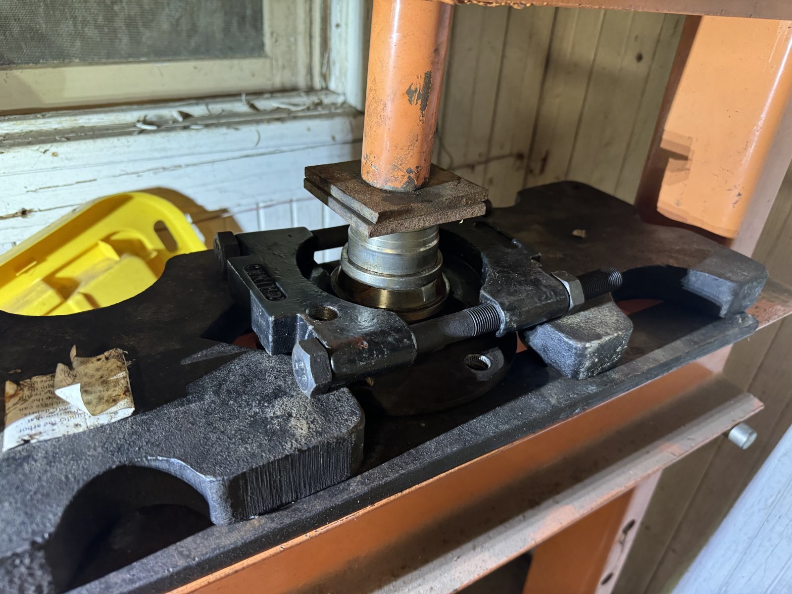

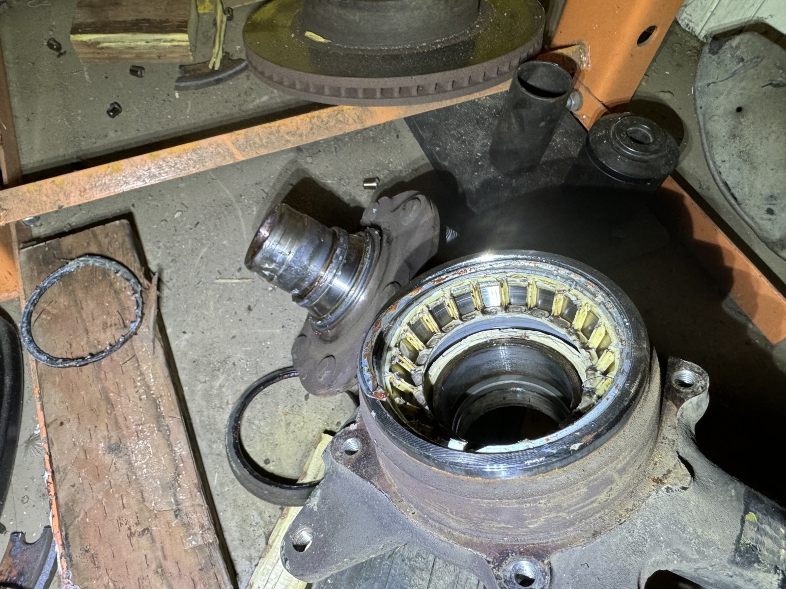

    Don’t wait too long, mine got hot and almost welded itself to the spindle. My bearing exploded when pressing it off then I had to use a bearing separator to get the seized piece off, and I bent the bearing separator.
    I didn’t want to buy a new one from Toyota for like $300, and I ordered one from Dorman, but returned it when I was able to get the bearing off.
    Blew the snap ring off.
    Bearing Separator pretty much maxed out the 20ton press. I was hiding behind a piece UHMW.
