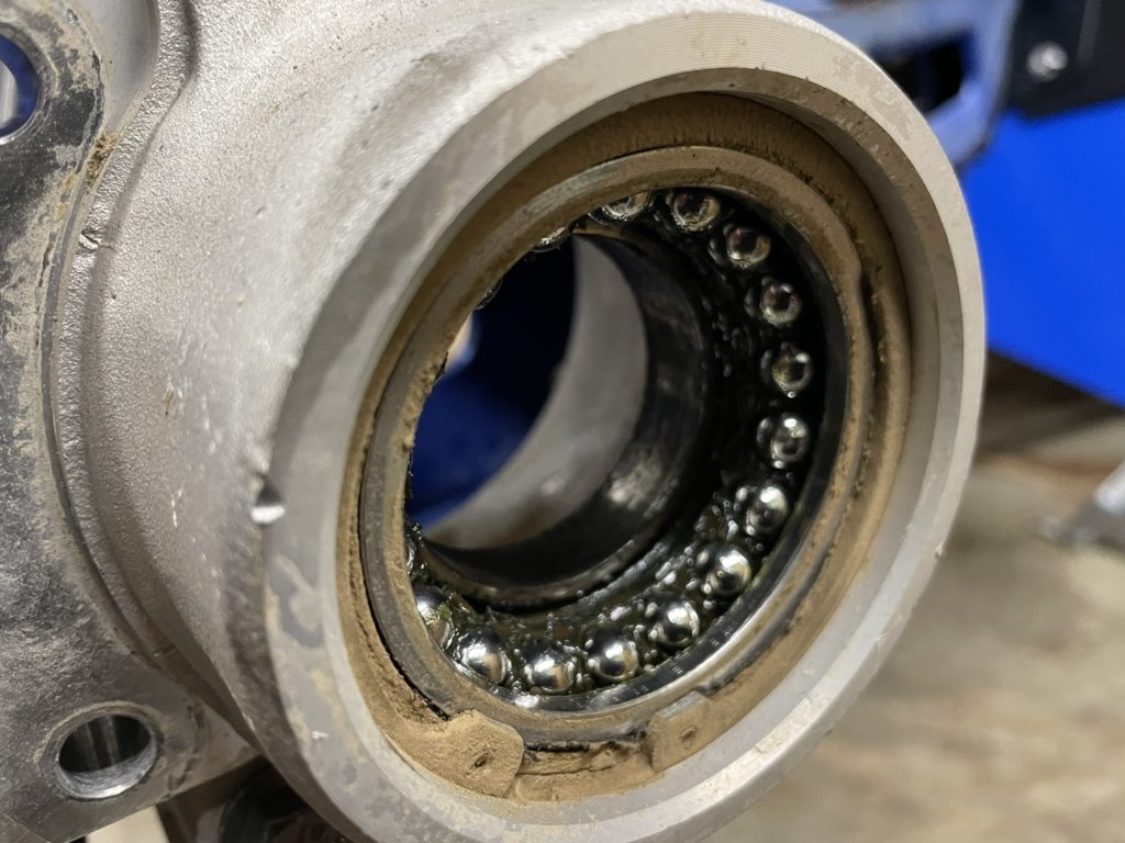

    Not sure if this is helpful or not, but when I installed the hubs back into my wheel bearings, I put an old brake rotor on the press, set the studs from the hub through the holes in the rotor, then set the bearing (that I had already pressed into the knuckle) on the hub and pressed it in. I had a spacer on the back of the inner race for the bearing that the ram of the press pressed against. Doing it that way allowed me to easily see everything I was doing, making sure everything was lined up, and making sure everything was supported through the whole process.

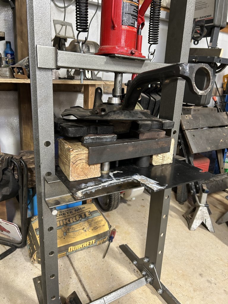

    Thanks for the advice. First bearing I blew I thought it was an error I made during the pressing process, so I took the precautions you mentioned in order to make sure the bearing was supported while pressing the hub in. Everything was fine, and the hub spinned perfectly, I was able to verify the bearing was seated properly as well. The problem came when i installed everything back, I’ve called several shops around my area and they all point me towards the cv axle. Either is not the correct length or it was over torqued. The hub spinned smoothly after I pressed it but when I assembled everything the wheel was hard to turn, in my inexperience, I thought it would loosen it up when I start driving her and ended up blowing up the bearing. It wasn’t suppose to be that tight, it should have a spinned freely after I torqued her to 173lbs. Fun times!!

    Do not do this. My rotor exploded into a million pieces my bearing was so seized on. Most catastrophic failure on my press yet lol :rofl:Edit: Nevermind, you’re talking install not removal :frusty:
    Also, I’m almost positive you cannot over tighten the spindle nut, there is a groove right where the tone ring is that will not allow it to go further.

    I blew up an old brake rotor when I did mine too. It survived the first bearing, then exploded on the second. Ended up using angle iron and 4x4 posts. That combo worked amazingly well.

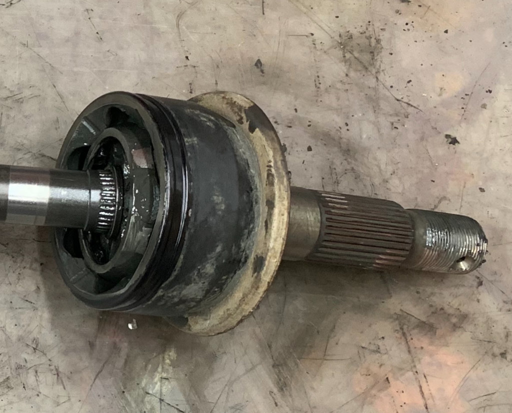

    Indeed, the two axles I got a remans from Toyota. The longer axle I took off seems to be aftermarket. The suspension is stocked. You raise all good questions, I intend to look everything over more closely this time around.

    You have to be compressing the bearing races together and not allowing them to rotate freely. Mine rotated easily after torquing the hub nut. The tone ring and spacer are both reinstalled?

    Yes, the press work I did was fine, the problem happened when I torqued everything back on the truck. I did the passenger side, no issues works fine, the driver side is giving me problems.

    The axle I took off from the passenger side was longer than the drivers side. I bought two remanufactured axles from Toyota both have the same part number., and seemed identical. I’m only going by what I’ve been told, both shops I called seem to think there is something with the axles or the torque. I’m hoping I can find the problem this time around, this is the third bearing I buy and they are not cheap.

    Well good news the culprit is the reman axle from Toyota, the bad news is I think is been over a year since I bought it, so there is no warranty. I sat on this axle for over a year, I just put it on.
    Ok so let me go over everything one more time so we are all on the same page and hopefully this post can be of help to someone in the future.
    I’m doing a restoration/modification to my Tundra, so I decided to get new steering knuckles and have Chaos gussets welded on them, new brake calipers, rotors, seals, bearing brake hoses, brake lines and reman cv axles. Everything but the Rotors and brakes shoes where from Toyota. I did the front but for some odd reason I blew out the passenger side bearing while test driving it. I thought I made a mistake during the press work but found it odd since I did the drivers side without issues. I got a second bearing, redid all the press work and again during the test drive blew it out. I called around a couple shops and posted my problem here from all I was able to gather I knew this time around I needed to take out that Toyota reman axle and inspect it closely. The two shops I called insisted on the cv axle being the problem.I took everything apart and removed the cv axle, I found that the inner joint had way too much in and out play. I checked it against the old one, and the old one felt tight with maybe an inch of pull on the inner joint but the reman had probably over 3 inches of pull. I pressed in the new bearing and put the old cv axle back on and no problems whatsoever. The boot on the axle is all deformed from the amount of pull/slop the axle has, lesson learned, cost me a bit of money but I knew what i signed up for, is all part of the journey.
    Lesson learned, a bad cv axle can blow out a bearing pretty fast depending on the amount of play it has.
    Update: Called my local Toyota dealer, the axle is still under warranty, they were able to pull it up. They ordered another reman axle and will call me when it arrives. The old axle is in great shape but it will be needing new boots soon.

    The first time I did my press work, after pressing in the bearing, I didn’t support the bearing underneath while pressing in the hub, and I over pressed the hub slightly. I caught my mistake and was able to fix the problem without damaging the bearing. The reason I knew something was wrong was because the hub had a bit of resistance when trying to spin it while the second side I did spinned freely.

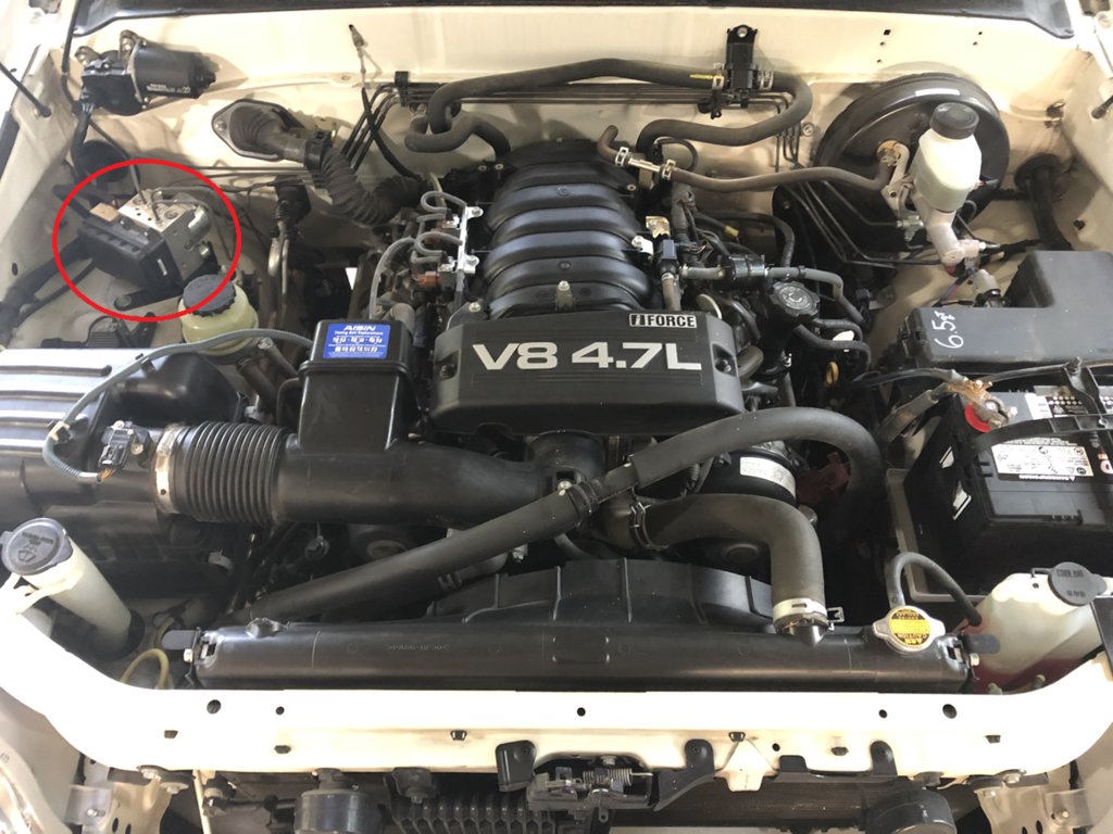

    ABS was optional on the 2000-2002 trucks. So if you don't have ABS then there won't be any tone rings.

    And if you don't know what to look for, if you have ABS, your truck will have this cube under the hood with hard brake lines coming out the top, passenger side, the "ABS squid".
