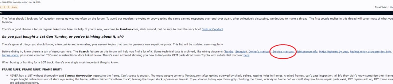

    Service manual. Not exactly. I work at O'Reillys so I have access to their diagnostic site. The three major players that it comes up with for my symptoms are. Crank sensor, ecu, and tcm. Gotta admit this site of theirs is not the most helpful. I've gotten most of my better info from this forum site. But as is I've crossed off crank and cam sensors. Tcm would have went I would've noticed something before hand (hard shifts, high revving, ect) and I was hesitant on ecu as when I unplug shit it recieves the correct codes and displays them. So it's getting info. Maybe just not correctly relaying it back? Hell if I know.
