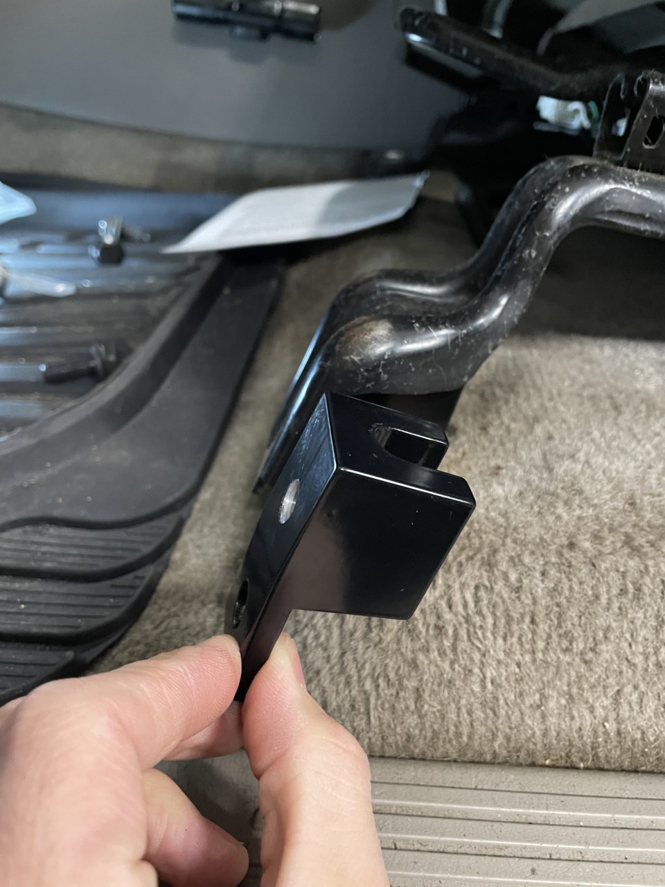

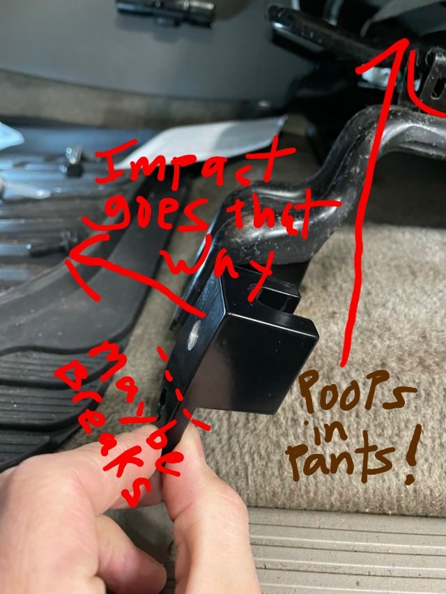

    It's good
    The way the seats are deigned, the front bolts hold vertical sheer. The rear bolts hold horizontal sheer. Adding a spacer like this does weaken the integrity of the whole thing. But enough to matter in a crash? I doubt that unless it's a crash you aren't walking away from anyway. I would be more concerned if the seatbelts came out of the top of the seat like on a Tahoe.

    Well shit, everything we've been doing the last two days has been in vain then...

    It's good
    That said "spring height" at some point. Must be an Android phone conspiracy.

    I'm not a fan of spacers for lift or even level side to side. But, if you understand their limitations, no reason you can't use them. Several have used them and are happy with the result. Depending on size, a spacer on top of a shock will allow a shock to bottom out before the bump stop does it's job. A taller spring on a stock or stock replacement shock body will limit droop to gain lift and top out the shock for degraded ride quality. I had the latter setup for years and it was fine for street only but a fairly stiff ride. Cornered great.

    Perfect. Will not level the front to rear, but it will help and it will level left to right as long as you've measured it all correctly. Or at least help. Either way I say go for it.
