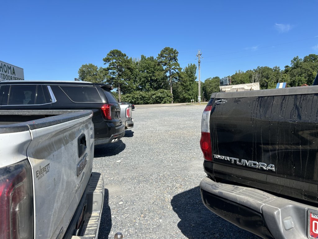

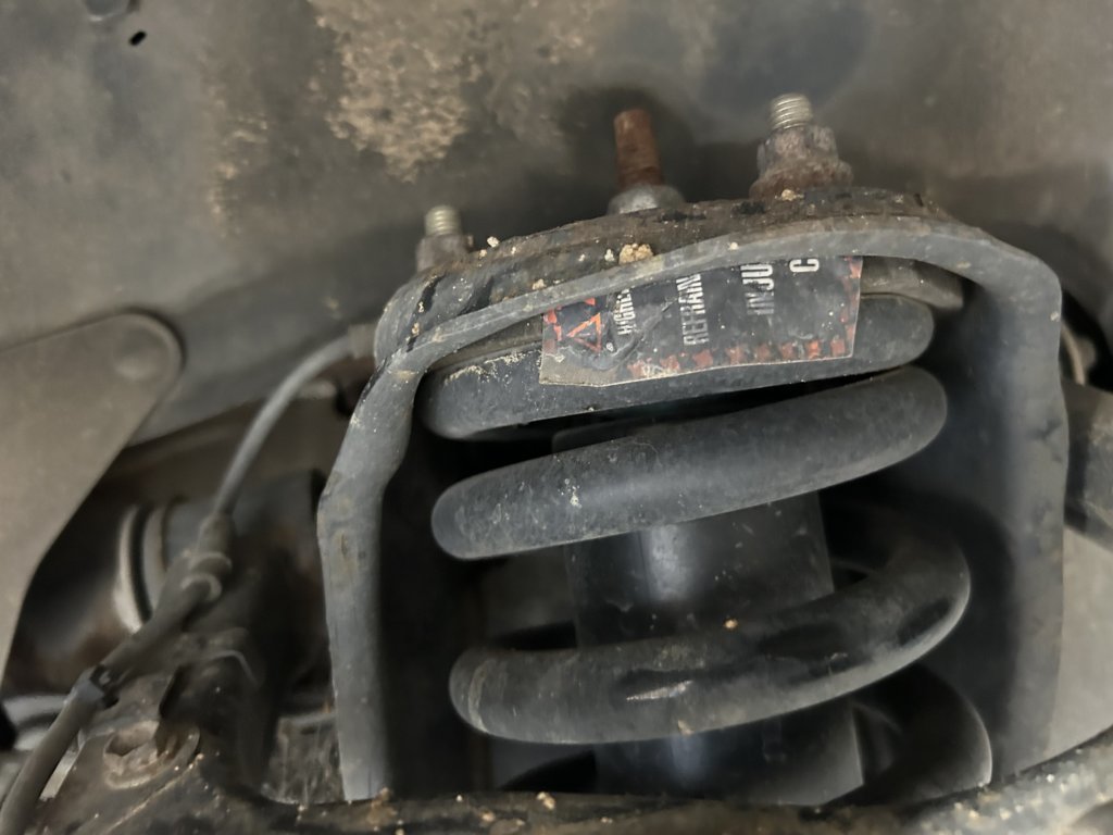

    Here’s picture of my suspension. The front to rear, and although backed up to a 4x4 GMC same height difference over Friends 2wd double cab sr5.
    Is it because it’s limited edition?
    Or has someone added something after market?
    My tires are 1” taller than OE, but that doesn’t explain that much height difference, or the greater rake.

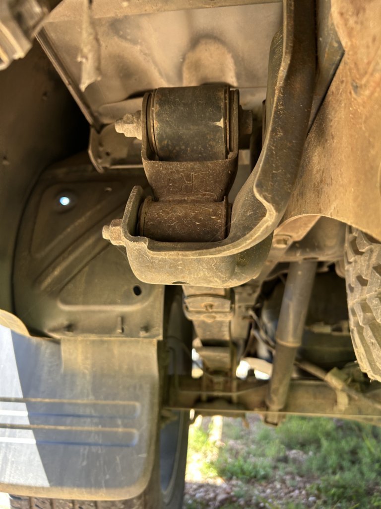

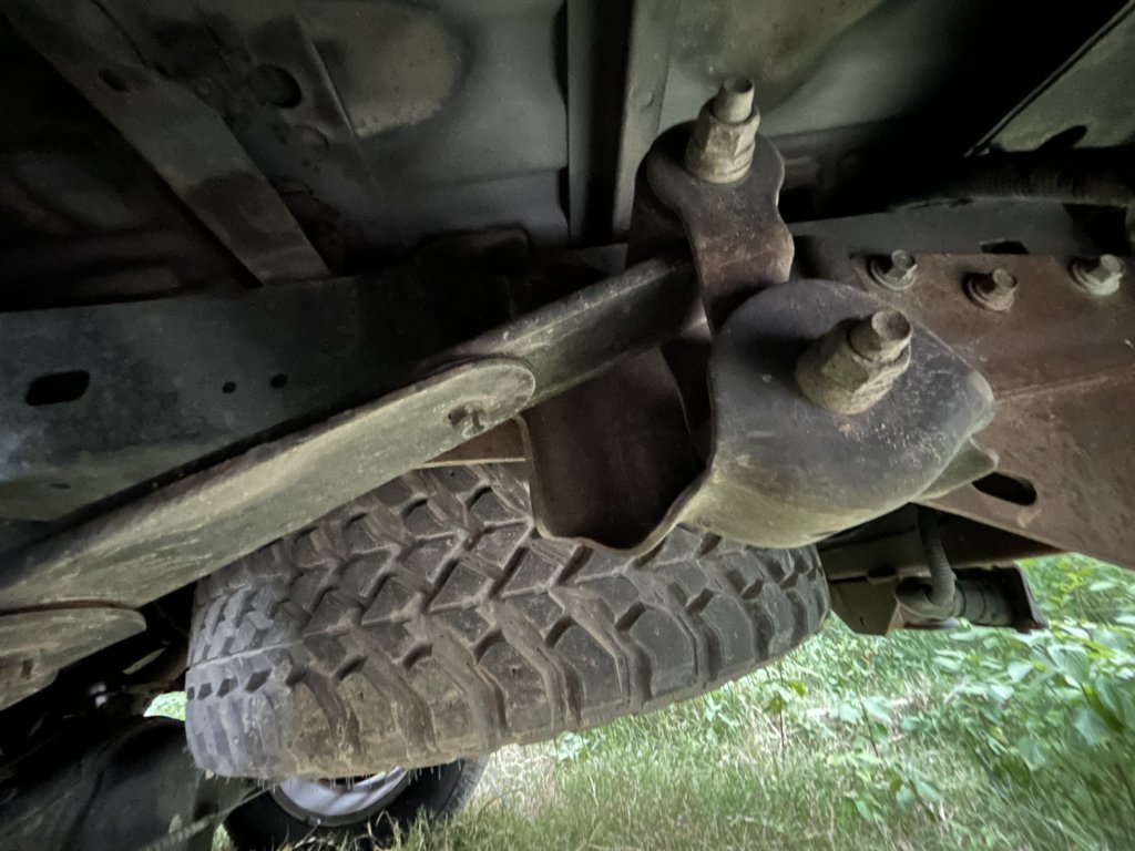

    Is that a right-hand (passenger) shackle on the left-hand (driver) side of your truck?

    Maybe your buddy's truck is higher mileage and the suspension is just worn out?

    They aren't identical?

    15.12 mpg with a/c running and crappy tires.
    New Michelin shoes today.
    about same mileage I think.
    Mine is taller than most I run across and is what got me asking questions.

    How many miles we talking?
    Yours might've just been pampered more :)
    Some first gens live rough lives. My 03 had a rough life before I came along. Conversely, my 06 was pampered til I came along. :laugh:

    Finally got the right search words and found why mine is taller.
    The limited is the tallest of all I found listed.
    • 2006 Tundra SR5 (Double Cab, 2WD): Has a ground clearance of 10.9 inches.
    • 2006 Tundra Limited (Double Cab, 4WD): Has a ground clearance of 12.3 inches.

    One is stamped with an "R" and one with an "L", I'm pretty sure.

    Pretty sure me and Casey swapped mine when we did the AALs on Penelope a few months ago ago.
    We wanted to swap the leaf springs from left to right in an effort to even put lean. I just recall swapping the shackles then possibly swapping em back once we swapped the leaves... It got confusing... Beer might've been flowing on that hot day. :anonymous:

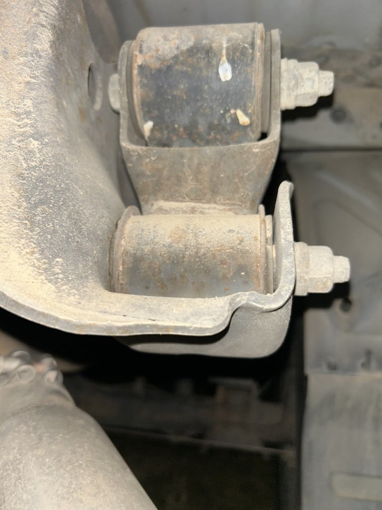

    I cleaned my glasses now I know what you're referring to.
    Both of mine have an R on them.
    This is passenger side.

    Passenger side should be R. It's possible both have the R stamped in them. Maybe the "R" is for REAR, as in, that's the side that should face the REAR of the truck, so it's correct?

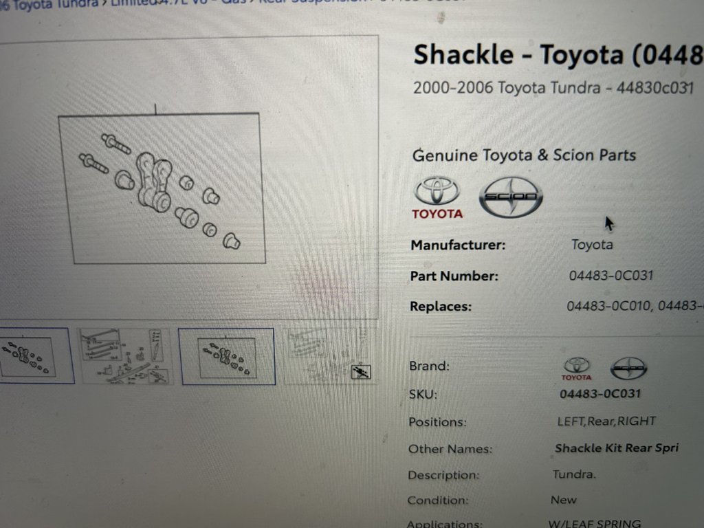

    Ourisman, and Serra shows the mount bracket to be different, but the shackle to be the same.
    If I can remember in the morning I’ll see if buddy has same markings on his.

    @shifty` looked at buddys this morning and his have the R on both sides as well so seems it may mean rear.

    Makes sense, thanks for checking! It dawned on me as I was writing that last night, I know you can get the shackle/hanger backwards, so I guess it's important to mark one side to make it obvious. I'm not sure if "R" was the correct letter, though. maybe "T" for tail or "B" for back?

    That's funny - I think I had a panic moment about this when I was doing my rear leafs because of the R/L confusion.

    if both leafs are off, flip em over, and put the taller one on the driver side.

    I was mistaken on mileage he has on his.
    ~300K total on his. I guess it was motor he got after timing belt break destroyed his first motor that had close to same mileage as mine.
    Having found the limited has more ground clearance to begin with, and fact I have 1” taller tires than stock explain it.
    At least I’m not pulling my hair out now trying to figure out why with no signs of lift spacers it’s so much taller than other FGT’s I run across.
    Also didn’t realize the limited had more front rake.
