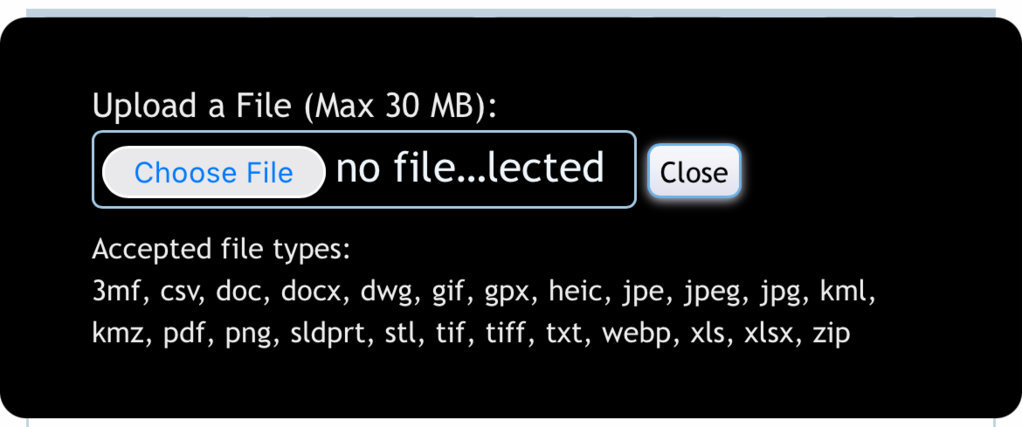

    Seems to be working for me, but i just know how to use the ‘upload a file’ button. I know TS has a limit of 9 pics per post, but i dont know about here.

    As long as you’re adhering to Max file size and File type, there should not be an issue.

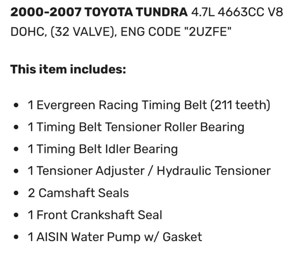

    IMG_5116.jpg I’m looking to do a timing belt kit install…how’s this list look?

    Booo on the non Aisin timing belt. Who knows what tensioners those are. I wouldn't trust it.

    I did read the big thread, and actually googled OEM AISIN kit and this is what came up, I’ll look more into into it and definitely use AISIN PARTS

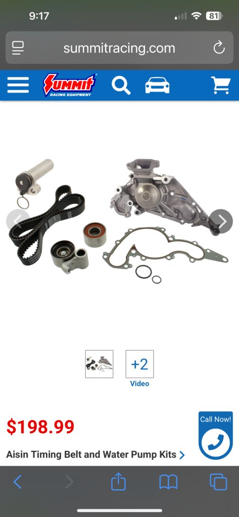

    Summit and Rockauto have the legit Aisin kits. They are not expensive, and they come with the necessary hardware that is also OEM equivalent for the tensioners and bearings. Be sure to order the kit with all the tensioners and bearings.

    It looks right, if the part number starts with TKT (Timing KIt), and ends with -021, then it's the right kit for the 2UZ-FE/V8. They also make a kit that ends with -001 which contains a bit less stuff, for slightly less money.

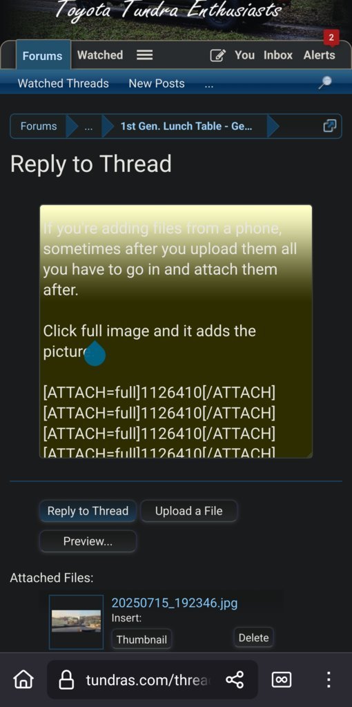

    If you're adding files from a phone, sometimes after you upload them all you have to go and click more options to get the choice to attach them, like this:

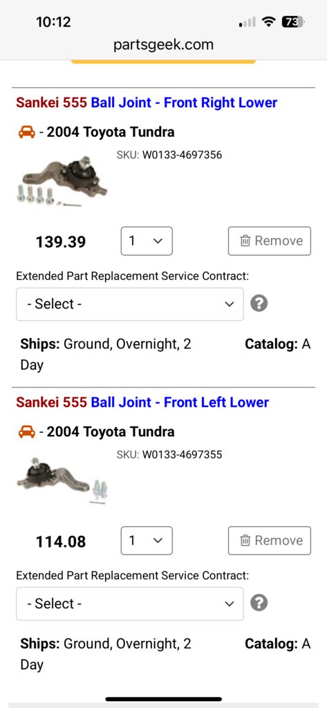

    So you're basically saying you've opted to ignore everything we put into the megathread without outright telling us you ignored the megathread, eh? And now you're asking for parts advice, on something that's warned about in the megathread.
    Posting a picture of anything other than OEM LBJ is a great way to tell me you're ignoring all of our critical community input in the megathread. Dude. Go read it.
    And FYI, I know there are a lot of stupidshits out there saying "Sankei 555 is OEM". Let's be real. They got caught up in the in NHTSA mandatory recall for aftermarket lower balljoints a couple years ago too. Over 15,000 LBJ parts affected, along with several other brand names: NAPA, AC Delco, MOOG, Sankei, Tenneco. Why? They sourced some or all of the parts from the same freaking place. SAME SHIT DIFFERENT PILE. 555 IS NOT THE SAME AS OEM.
    OEM LBJ. Always. This isn't something people are just telling because they're elitist, we've just seen dozens and dozens of 1st gens killed by LBJ failures (so much an entire 20+ page thread exists on the subject, which again, is linked in the megathread!)
