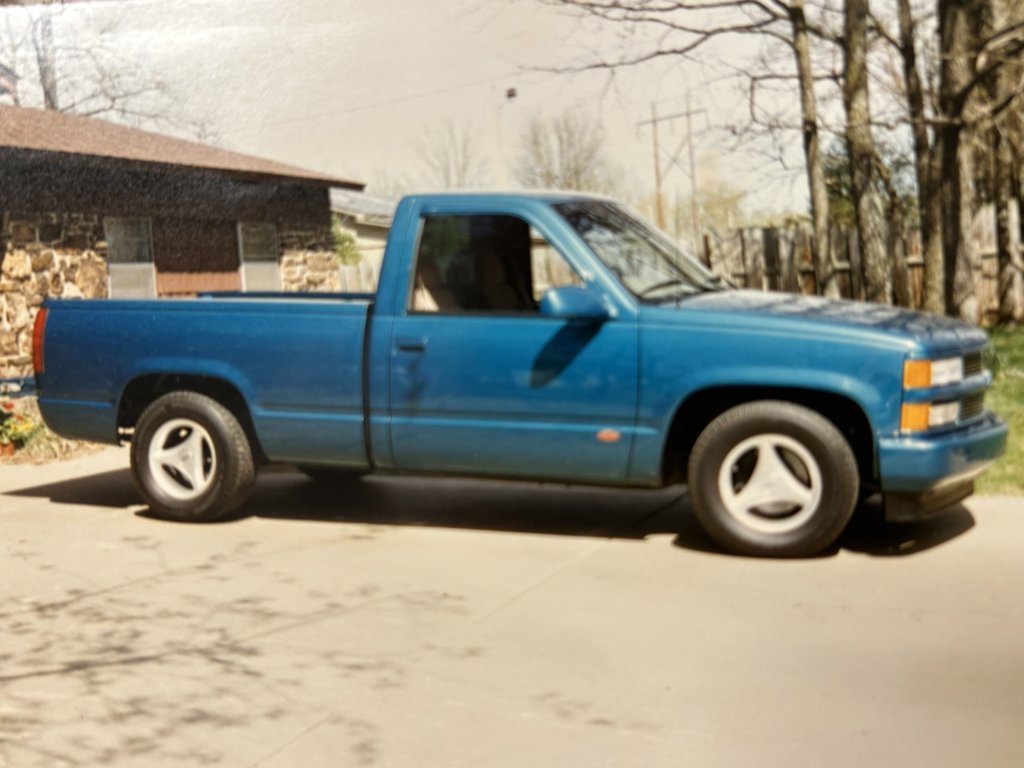

    The 90s was a tough year for GM and Ford on their trucks. They still didn’t quite have the plastic formulations down in a way they survived in ultra cold and ultra hot weather, so they’d crack to bits. I posted pics of that specific Sierra on here, the dash had a hole so big in it that you could put a full palm the top of the radio. It was cracked mildly when I bought it, driving down ATL’s pothole riddled roads, I wound up with a new crack or two every year.

    That's exactly how his was. Holes all in the top of the dash and cracks even further down. It was pretty bad.

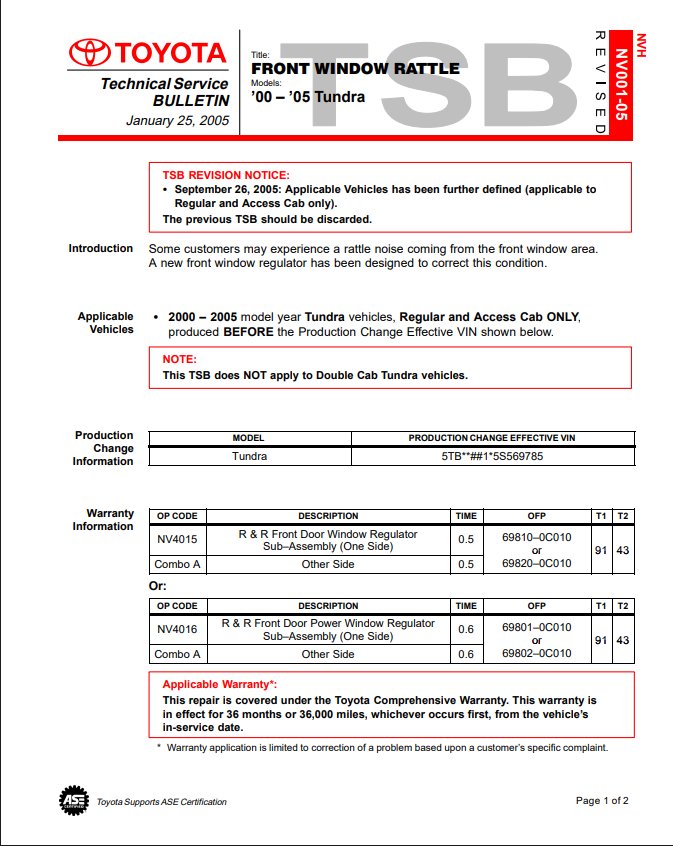

    I agree. I think that it's the worn out weatherstripping / run channels that are causing the rattle. When we replace a door on a vehicle and put on a new weatherstrip it makes the door a bit hard to close at first. This settles over time once it sits out in the sun a bit with the doors closed.
    I did find an interesting TSB on a door rattle that was shown to be caused by the window regulator. Toyota apparently redesigned the regulator to correct this. (AC only)

    Looks like it only covers 2000-2005 though; guess they corrected in 2006 but I still have the issue :(

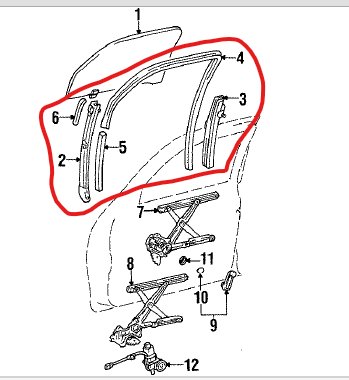

    Probably one of these items here. I'd put my money on the guide channels being worn out.
    (Access cab diagram)
    #2= Guide channel front. RT side part number 674010C010 / LT side part number 674020C010
    #3= Guide channel rear. RT side part number 674030C010 / LT side part number 674040C010
    #4= Glass run upper. RT side part number 681410C010 / LT side part number 681510C010
    #5= Glass run lower. RT side part number 681430C010 / LT side part number 681430C010

    I think it’s probably #4, honestly. Last time I checked it was like $175 or something absurd like that though. Enough it wasn’t worth the risk to buy it without knowing 100%.
    But I think my AC cab is different because I thought there were 3 total pieces.
