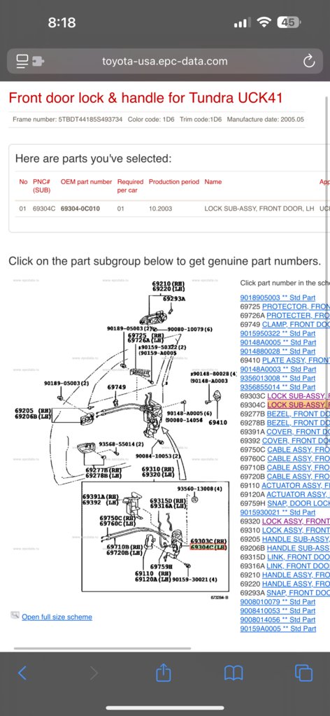

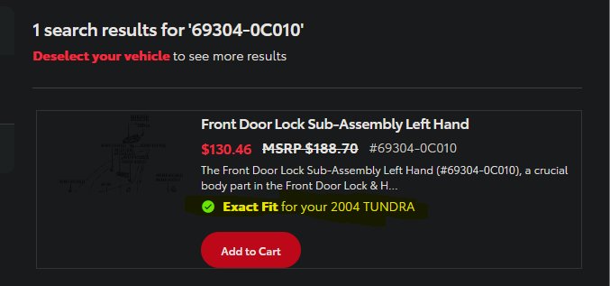

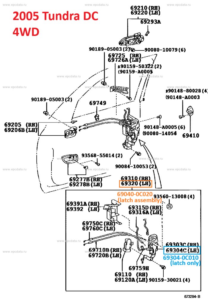

    I paid $131 shipped to get the part circled in blue, complete with cables and everything. The only thing I had to transfer over from my original latch assembly was the part in green.

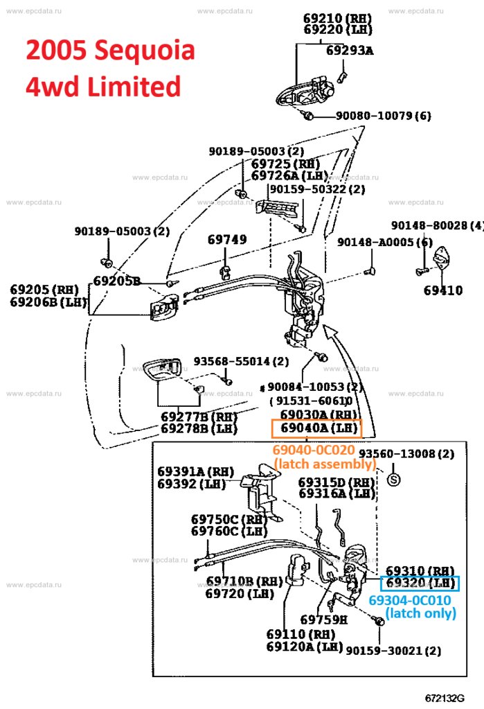

    Inside the EPC, the Sequoia uses different INDEX numbers than the DC, but the part numbers are technically the same.
    Here is the difference for an '05 DC versus an '05 Sequoia, notice the part index numbers (in the colored boxes) are different, but the physical part numbers are identical - once again, you may only need the LATCH, not the ASSEMBLY, one is 3x more $$ than the other:

    #40572

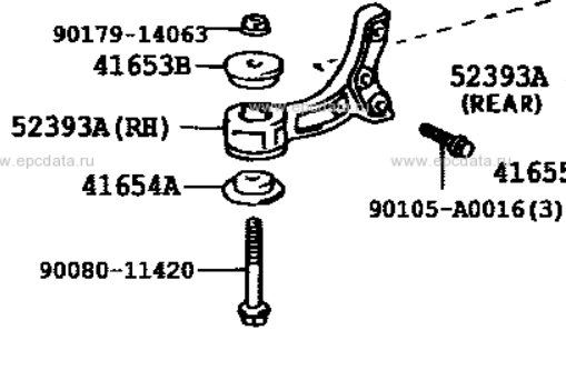

    Hey I’m looking to remove my differential drop, if any has the part numbers to the shorter bolts or point me in a direction I could find them.

    That's the exact part number that I bought from a different dealer for my driver's door. When I search on Lewis Toyota it says this:
    What came when I used that P/N is exactly what I was referring to in this post:
    2x 90080-11420 Bolt with Washer
    2x 90179-14063 Nut
