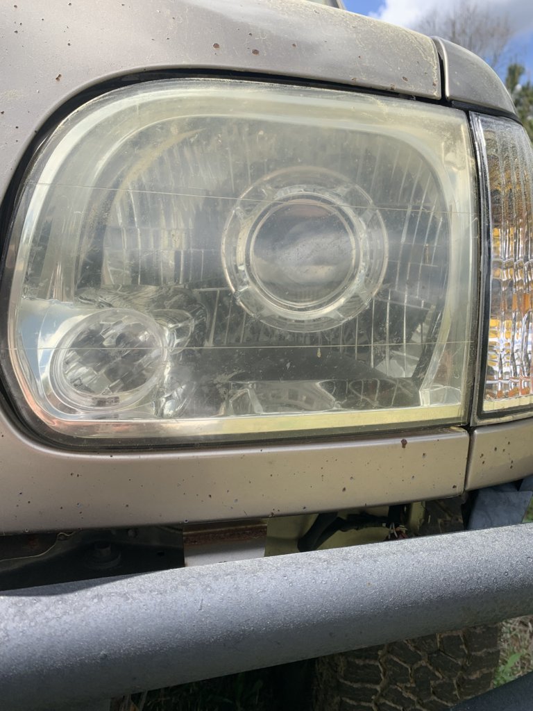

    I've got them retrofits dawg. Depo CAPA housings, Morrimoto Mini D2s Bi-Xenon projectors, Morimoto 50w ballasts, 5800k 55w bulbs, etc etc.
    I'm about as blind as a welders dog, and I really don't see well at night. If I'm out after dark the tundra is mandatory.
    The Morimoto mini d2s projectors are 78mm or roughly 3". I think a guy could go even bigger if he wanted to, depending on the projector shroud you wanted to run. Maybe a little different packaging in the DC housing though.

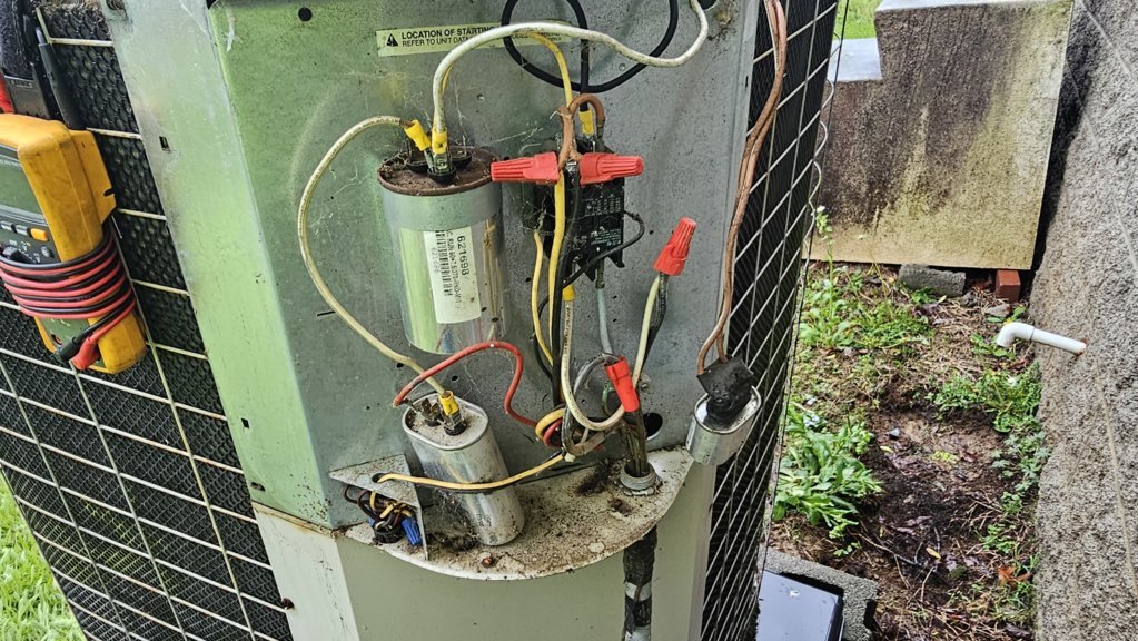

    @hvac and Sparkies, I need some help
    Why does my AC unit have 3 caps? One is a motor run cap, that's easy enough (far right)
    Also, how do you test caps? Continuity? Any reading is a good reading?

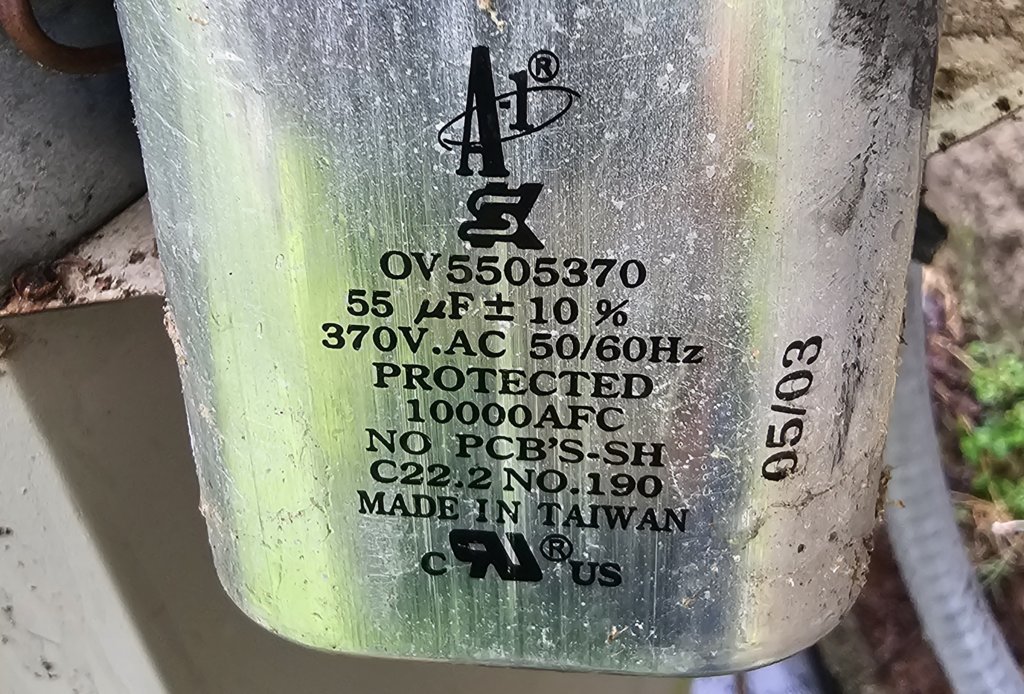

    This 55 microfarad reads 53 ohms. Is this correct? This is new for me.
    @FrenchToasty
    FrenchToasty likes this.

    You should have a capacitance reading on your Fluke. Just need to isolate the circuit by first unpowering it, discharging the caps with a screwdriver by shorting them and then measuring capacitance with at least one leg of the cap disconnected from the circuit.
    JakeJake, Tundra2 and FrenchToasty like this.

    You need a meter than can read microfarads(uf) looks like they are using two in series to bump the MFs for the compressor, try to get a number off the compressor and look up what it should use.
    edit; looks like whoever put that on shouldn’t be touching electrical, they’re just using the upper left cap as a jumper down to the lower left.
    shifty` and Tundra2[QUOTED] like this.
