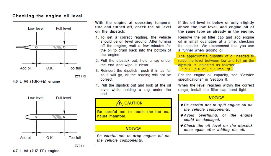

    On another note, I’m trying to limp my VC gaskets to the finish line at my next oil change. Do we know the volume of oil it takes to get from the min dot to the max dot on the dipstick? I need to add some…
  24. Feb 14, 2025 at 11:28 AM
    Jack McCarthy
    Nov 2, 2020
    #54409
    10,837
    Bill
    North of Boston
    02 Tundra AC SR5 V8 4x4
    I believe it’s a quart but I’d play it safe and do 1/2 quart at a time.
  25. Feb 14, 2025 at 12:08 PM
    Fragman
    Fragman New Member
    Nov 28, 2024
    #126540
    353
    TX
    2006 Tundra DC SR5 2WD V8
    Owners manual actually says 1.6 quarts, but as @Jack McCarthy said, better to start at half a quart, see what that looks like and go from there, particularly as my manual is for the 2006, which is VVTI version of the 4.7, so may be slightly different.
