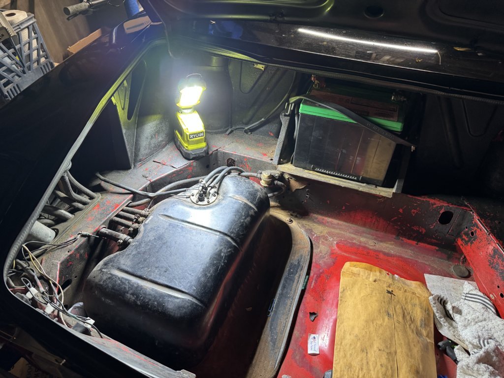

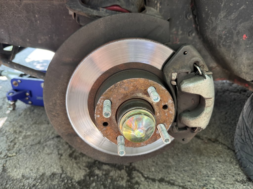

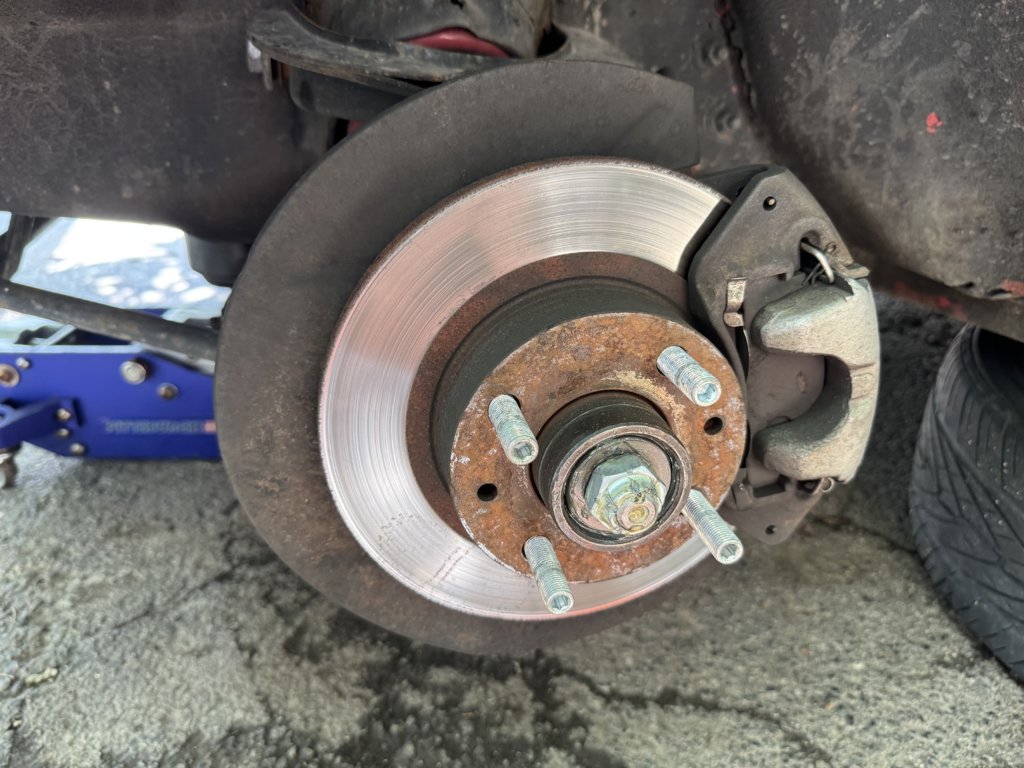

    Later that spring I started having issues with the brakes. I was having lots of issues with calipers sticking, or the brakes getting hot. I started by replacing the soft brake lines, which was a major pain since the hard lines were original and pretty stripped out.
    That didn’t work, so I ended up rebuilding the calipers. Super super easy, and I think it cost me $22 to rebuild all four calipers.
    I still was having trouble getting the handbrake to work though, so I ended up buying two reman rear calipers which fixed the issue I think they were like $120 total? Super cheap to fix this car. New handbrake cable too.

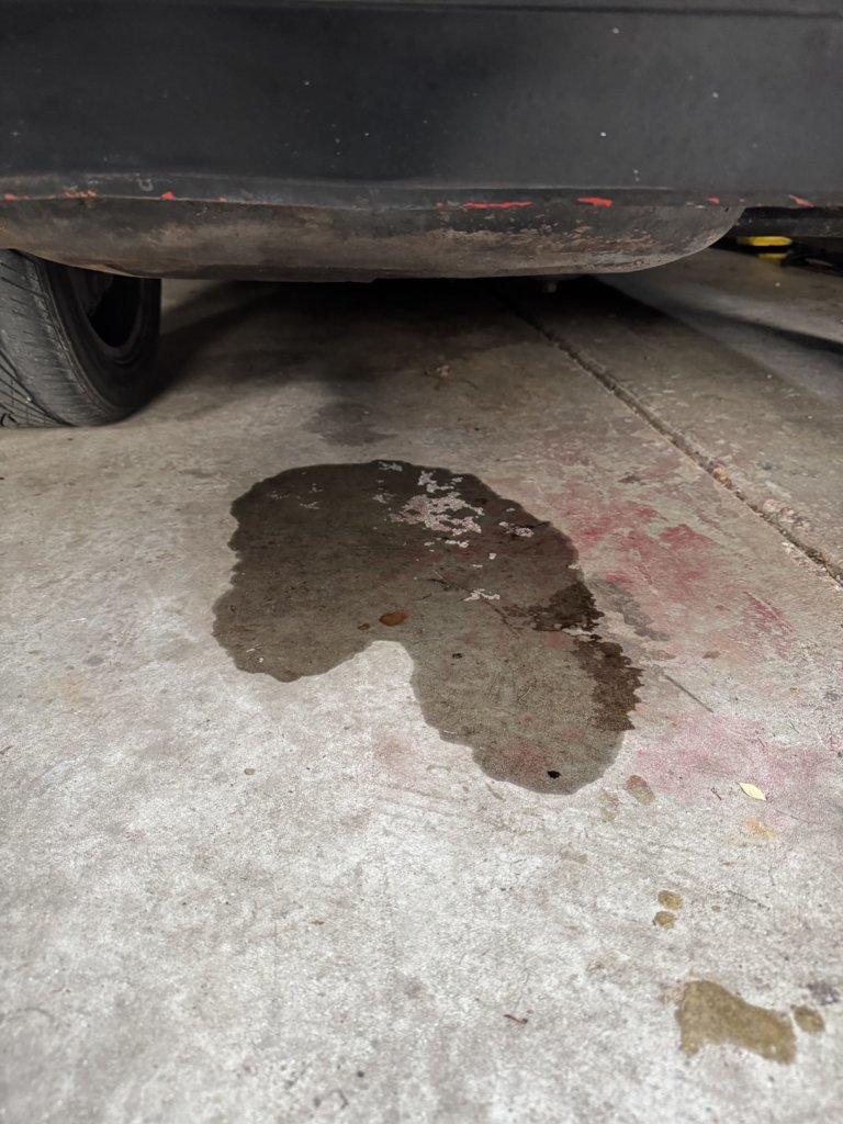

    Home for the weekend, did an oil change. Been about 18 months, pretty overdue.
    I started it up to get the oil warm, and it had a dead miss on one cylinder. Immediately identified it as cylinder 4- as there was a pool of water around the #4 plug. Turns out that there’s supposed to be a seal at the front of the cowl, and mine is missing. The car sat outside in the rain a couple days ago, and I pushed it back into the garage as I didn’t have the keys on me. That water sitting on the spark plug must’ve killed it.
    Red line is the seal, blue is where the water pools. New seal is on the way.
    The rest of the oil change went smoothly. I run 20W-50, and it gets pretty thick after sitting in the garage all winter. Warmed it up with the space heater.

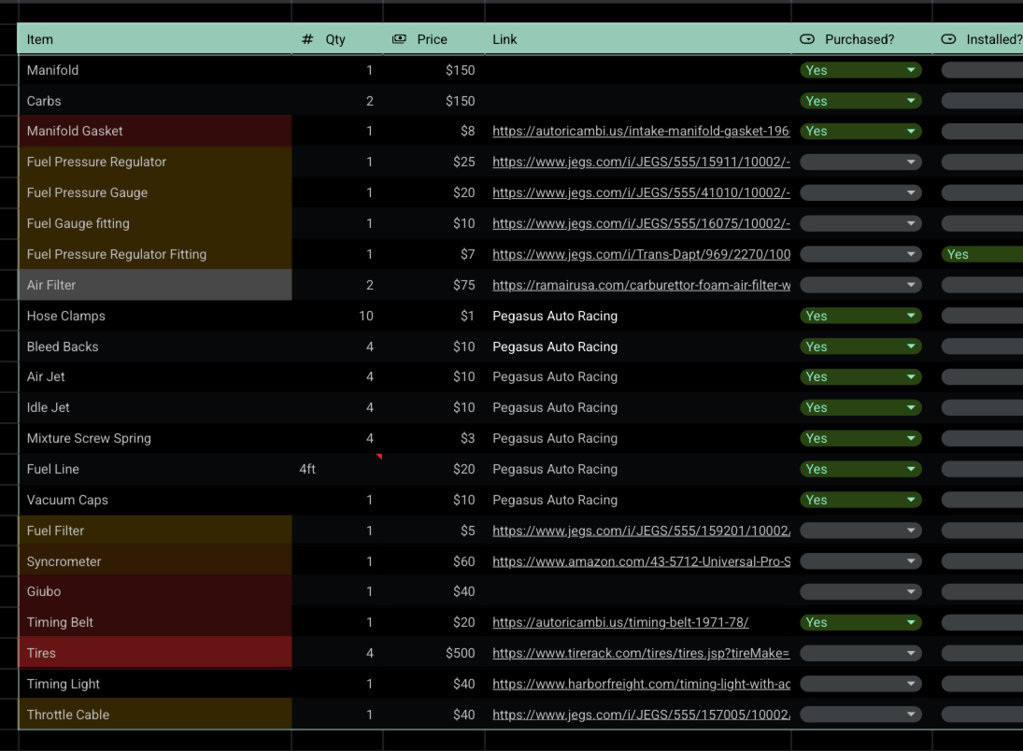

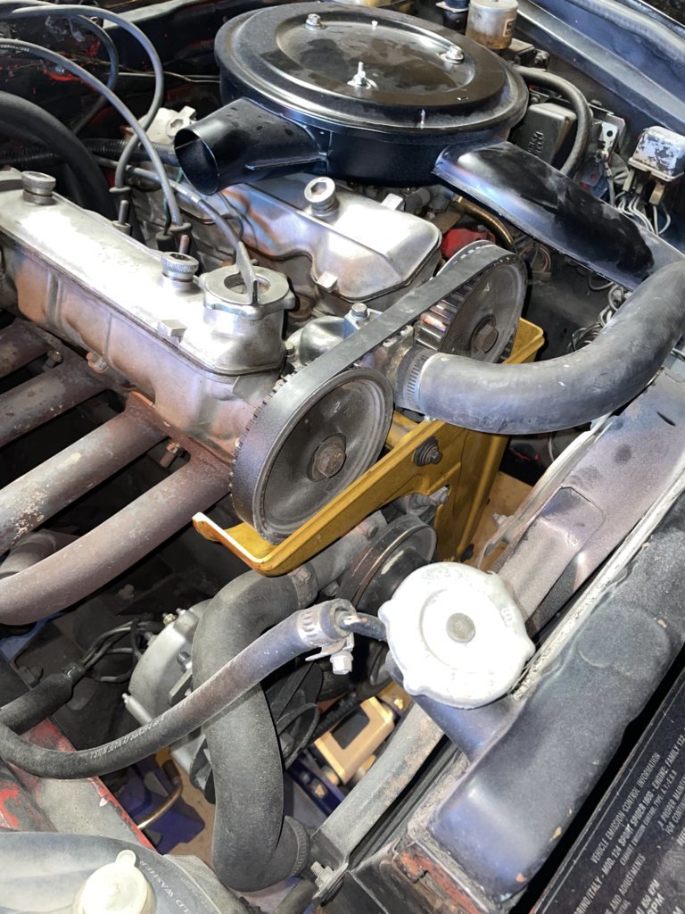

    Over the past few months I’ve been slowly accumulating parts for this car. This summer it’s finally going to receive a lot of attention that it’s needed for a long time.
    First up is a new timing belt. This engine, designed in 1966, was actually the first mass produced car engine to have a timing belt.
    However, it is of an unknown age, and it’s supposed to be changed out every 5 years. It’s probably been closer to 15… so definitely due. Supposedly it only takes 30min.

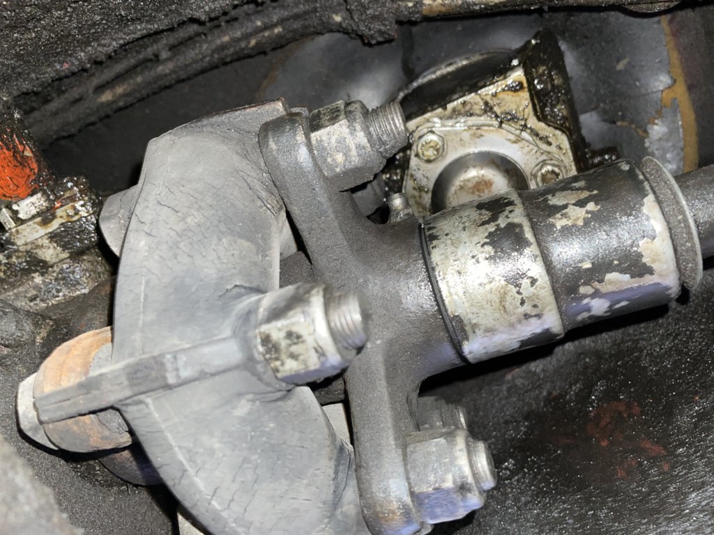

    Next is the rubber flex joint that connects the driveshaft to the output flange on the gearbox. I didn’t worry about this much recently, until a member of the Fiat forum had his explode while he was on the highway. The driveshaft fell down onto the ground, got caught on a seam in the pavement, and lifted the whole car in the air. Damage to the unibody caused by the driveshaft totaled the car. Not good! Based on my photos from when I diagnosed a gear oil leak, my flex joint has been cracked since late 2021:
    Definitely going to replace it before I take the car on the highway. That driveshaft is spinning close to 5000rpm at 70mph, and is probably 4” from your ass in the seat. I do not want to experience it breaking apart.
    I’d also like to get new tires. I’ve patched two different holes in the current set, and they’re 8 or 9 years old. They aren’t dry rotted or cracked, and they have lots of tread left, but they’re due. The car has aftermarket 15” wheels, which makes tires easier to find. I’m thinking about the Nitto Neo Gen, anyone have a suggestion?
    But none of that is the cool part. See, I’ve done some research and based on the cylinder head and engine block numbers, the engine in the car is a 1608cc Euro-spec engine that came out of a 1973 Fiat 124 Coupe. This is great, as Euro spec motors had more compression, and a square bore and stroke. They also came with more aggressive cams than the US-spec engines, and my car has an aftermarket longtube 4-2-1 exhaust header and full Ansa “performance” exhaust. It should make roughly 120hp, peak power should be around 6000rpm, and it should pull deep into the 7000rpm range.
    However, this is not currently the case. It makes great power and torque at low revs, and pulls strong to 4500ish, but it really falls on it’s face above that. The carburetor that it has on it is a double barrel Weber, and it would’ve been stock for a 1973 USA-spec car, not a Euro spec car. I think it is really restricting the engine at higher RPMs, and it’s a bit finicky in general. It doesn’t idle very strong, the choke makes it too rich, and the vacuum operated secondary doesn’t always work as it should.

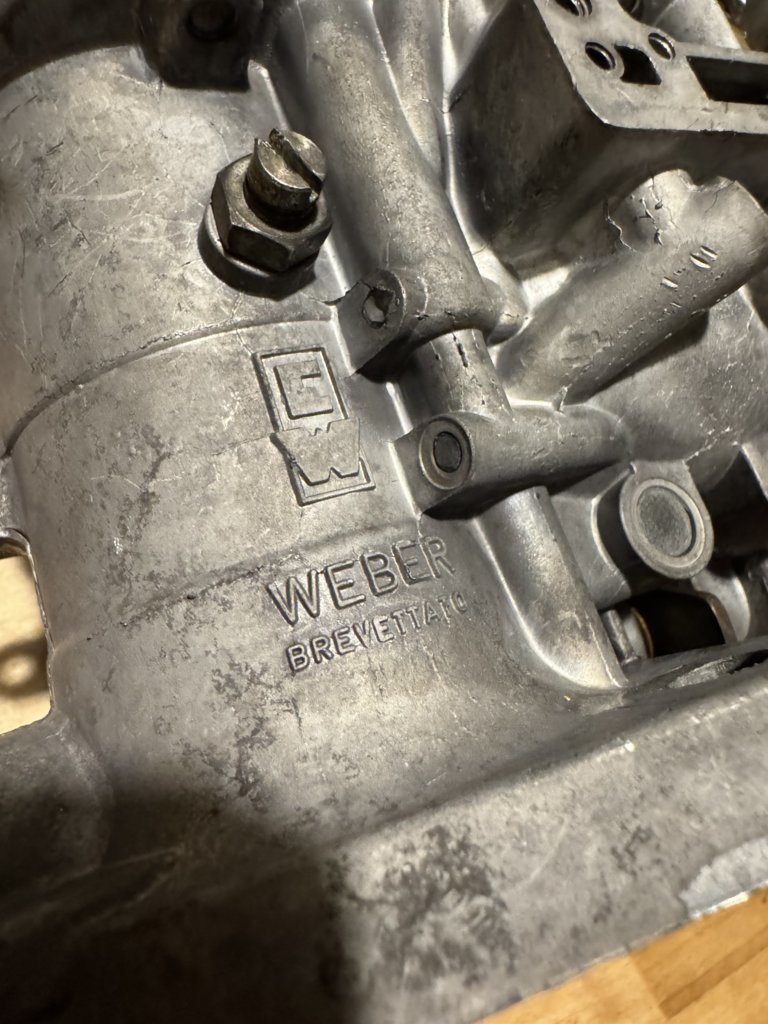

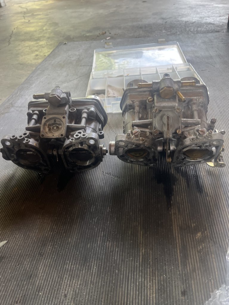

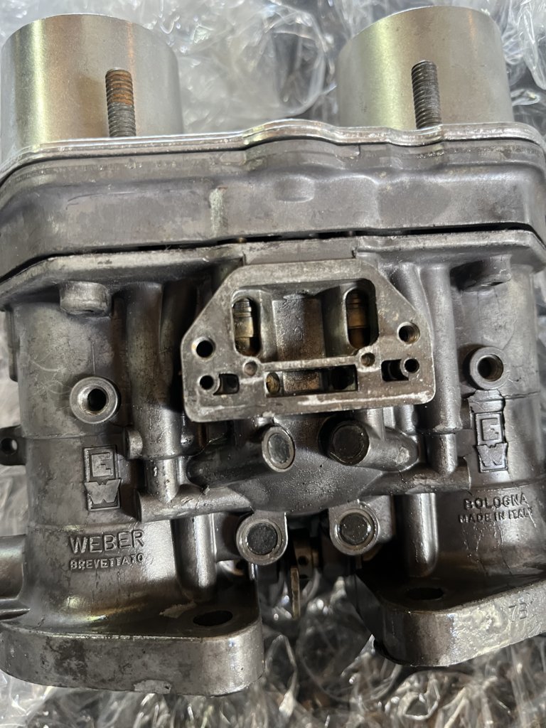

    So, I’ve purchased a numbers-matching set of dual Weber IDF carburetors, which would’ve originally came on a Euro-spec car (or a factory rally car!).
    I got them as well as an intake manifold for super cheap from a forum member, as they haven’t been on a running car in decades. They’re going to need a good cleaning and rebuild, but with a harbor freight ultrasonic cleaner, I can do that easily.
    Swapping dual Webers onto these Fiats is a super popular modification, and there is tons of information on them out there. They’re also very popular with the VW beetle/bus community. I’ll be able to get the engine tuned very well, much better than the current setup.
    I’ve spent a ton of time compiling a list of every single little part I’ll need. All in all it’s going to cost around $1000, which is a pretty good deal to me, considering how much the driving experience is going to improve.
    It’s going to make slightly more power, be much more responsive, start easier in both hot and cold weather, sound way cooler, and be infinitely more tunable than the current setup. It’ll also delete the hodgepodge of emissions stuff, which will clear up some space in the engine bay.
    I’ve already bought a ton of parts. Rebuild kits, gaskets, jets, venturis, all sorts of stuff, and I still need a lot more.

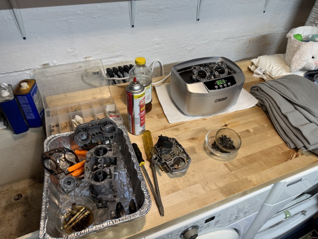

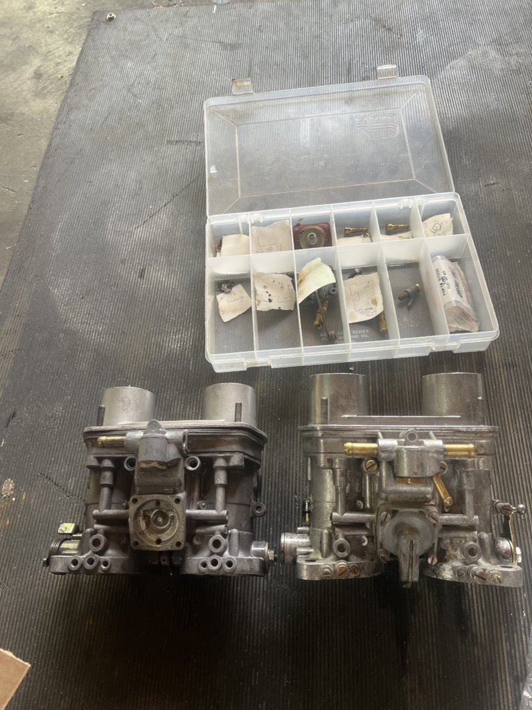

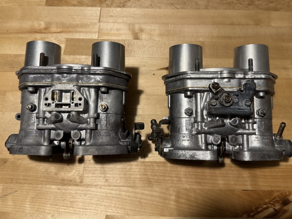

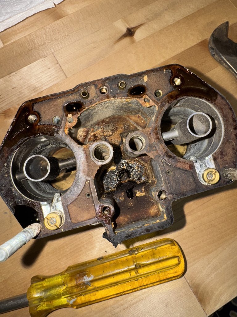

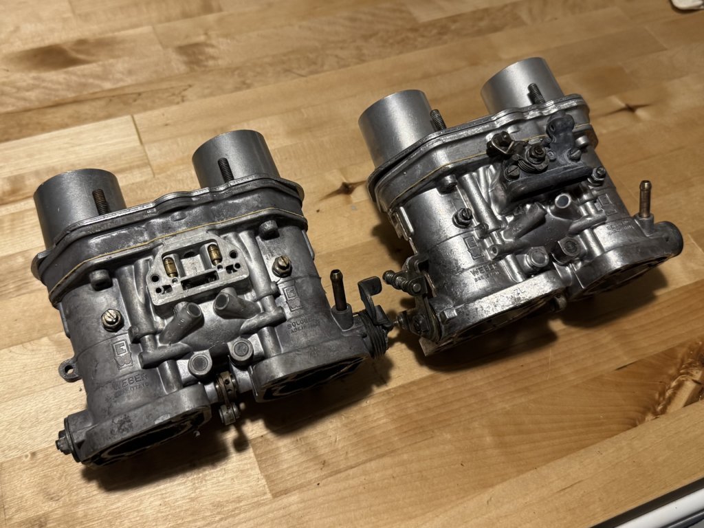

    Got to spend a few hours at home this weekend cleaning and rebuilding the new dual carbs.
    It was obvious that they hadn’t been run in decades:
    The ultrasonic cleaner I got from harbor freight worked really well. This was after just one 10 minute cycle:
    I used warm water and some pine sol, and I didn’t run them for too long. I know that I could’ve kept them in there a bit longer and made them squeaky clean, but that would make the rest of the engine bay look bad! I think they still turned out pretty nice though.
    Rebuilding them was really pretty easy. They got new needles and seats, gaskets, floats, diaphragms, and all sorts of different jets. Lots of good youtube tutorials. The left (rear) carb is missing the lever for the cold start enrichment system, which might be a bit pricey to find on its own. Most people block off that system, but most people with dual carbs only use them during warm weather.

    Noticed a squeak from one of the brakes when turning left. Found the drivers front wheel bearing to be a tad loose.
    Just tightened it up a bit. I redid these bearings sometime last year and they must’ve worn in.
    Put on a new dust cap because I had a spare. Took 20 minutes and now I have confidence that the front wheel bearings won’t come apart while I’m driving. (Which has happened to me before)

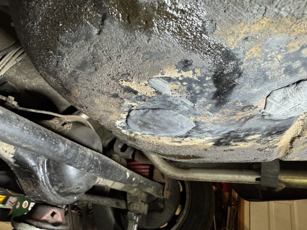

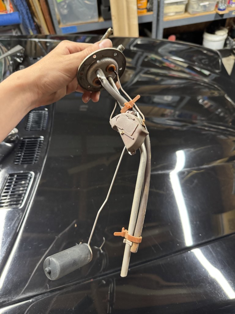

    The gas tank started leaking again, this time really bad. I filled it up yesterday morning, and it probably leaked out a gallon by the afternoon.
    I’ve patched the gas tank before, there were two pinholes, and I patched it with JB weld TankWeld. It worked for one of them, but not the other. So this time I scraped off the JB weld and stuck a sheetmetal screw in the pinhole. Then I put more JB weld on it.

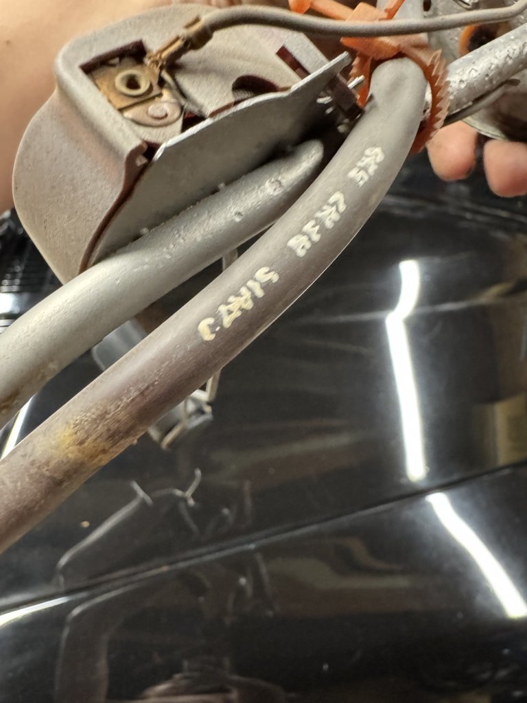

    I also discovered that the gauge sender is original. This script on the rubber hose means it’s from the factory. I siphoned out the gas via the hole for the sender.
    A new tank is $220, but I don’t feel like spending that. I think that if I have to patch it one more time, I’ll replace it. It wouldn’t even take that long to

    Bassani cat-back
    Why so many hoses?
    FiatRunner[OP] likes this.
  30. Jun 10, 2025 at 9:16 AM
    #30
    bfunke
    bfunke Tundra Curmudgeon
    Oct 13, 2019
    #37321
    2,460
    South Carolina
    2018 SR-5 CM 5.7, 2000 SR-5 AC 4.7L
    Looks like the Rock sells gas tanks for it
