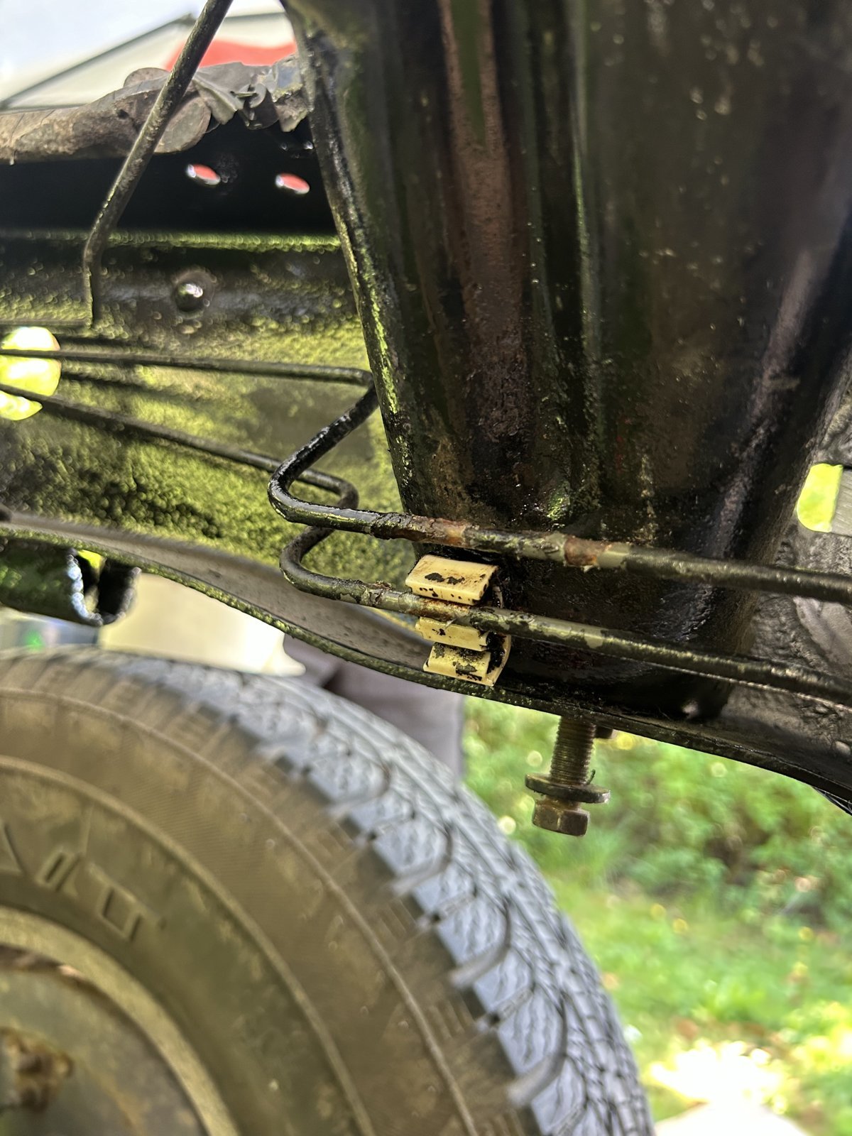

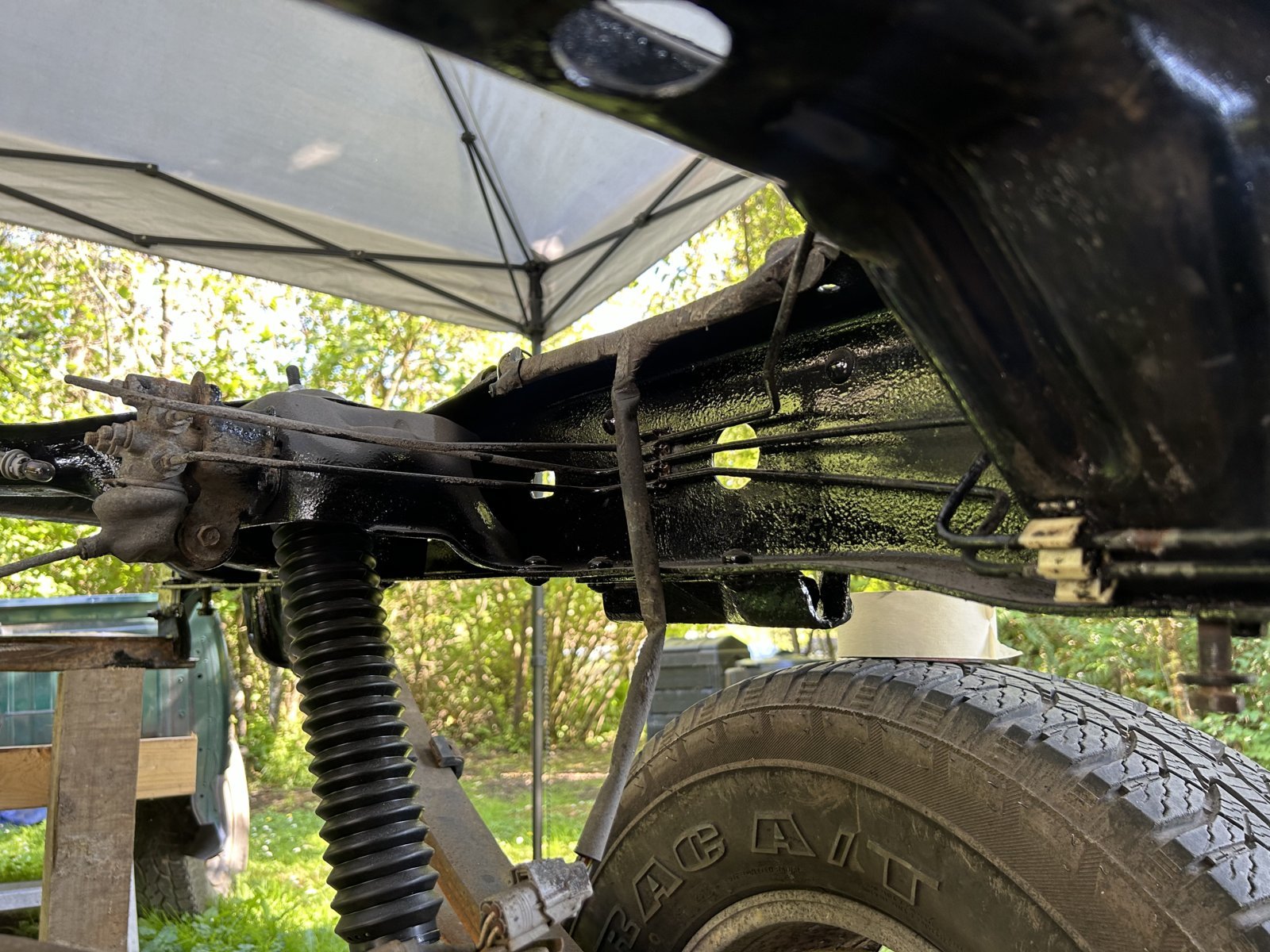

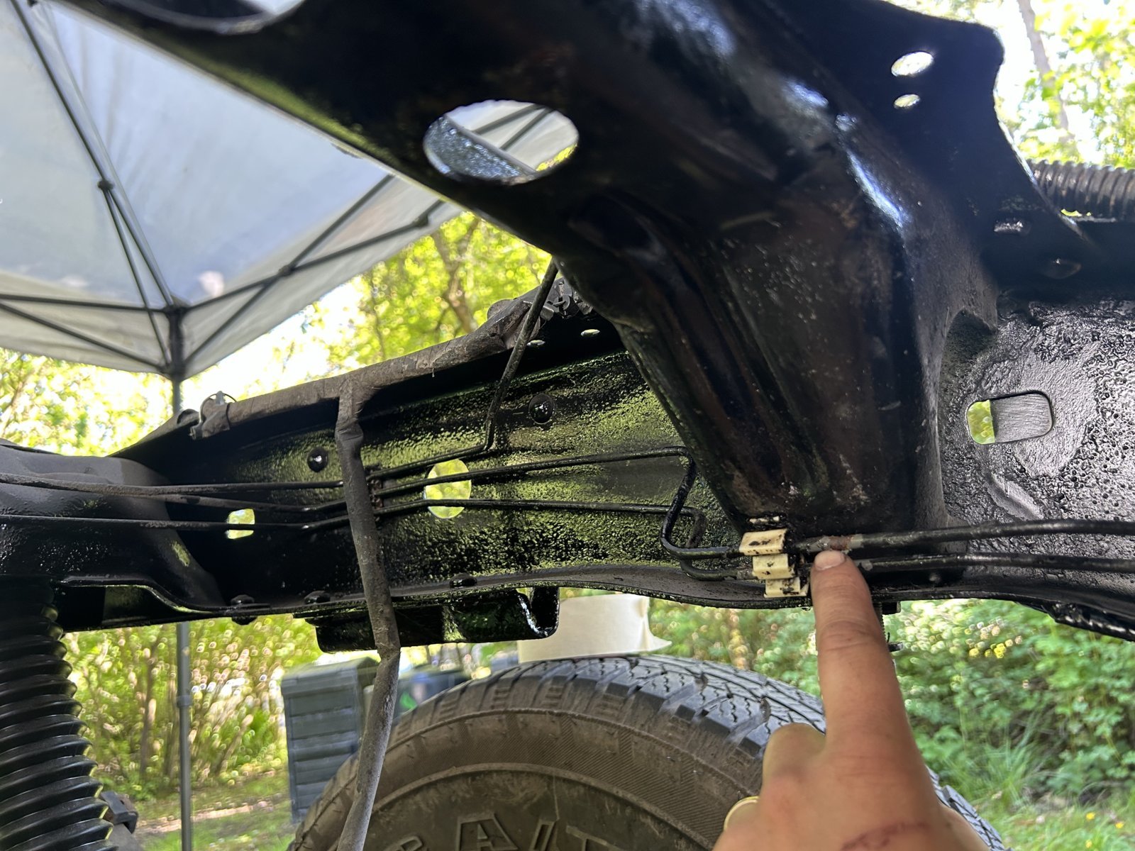

    Had a piece of cardboard under a section of hard brake tubing where I was working and noticed a leak… Brake line rusted through. I’m having a hard time finding a part # for it, maybe I should just replace them all, could someone point me in the right direction?

    You may find it here in this thread that talks about looking up parts:
    https://www.tundras.com/threads/so-you-wanna-buy-just-bought-a-1st-gen-tundra-eh.115928/
    Word of advice; If you do find a replacement, don’t pull the existing line out of the bracket or you may break it since it gets brittle with age (so I’ve been told by the guy who broke all the brackets holding my leaking fuel line). They’ll go in but they don’t come out easy. Best thing is to just cut it and slide it out.

    The top line is the pressure side from the master, the bottom is the return line.

    Leaks coming from the top line, bottom isn’t far off from rusting out either. Appreciate the info!

    Buying a roll of copper/nickel brake line tubing may be my best option

    Steel. And flaring is an art. Just know what flare is required for each connection. I have all the tools. I've learned only to use them in an emergency because it's a FPITA to deal with, especially when you need to double-flare. If you've never double-flared lines, check a reference.
    bmf4069 and Hutcheson[QUOTED] like this.

    Is there a reason you’d go steel over copper/nickel? Yeah it truly is, I’m a gas fitter by trade and the one thing that’s gotten me is forgetting to add the flare nut before flaring the copper haha

    As long as it's not straight Cu, I think you're OK (i.e. CuNi is fine). I'd personally go steel, you choose whether stainless or not based on your need. This is just my 2¢. I don't think stainless is worth the extra $$, but I don't live in the rust belt, so I'm biased. I also know stainless doesn't == "rustless".
    I also haven't had to work with nickel. Only aluminum and steel. So maybe it's easier to flare? I dunno.

    Ahh that was my bad, I meant CuNi. I appreciate the feedback, I’ll report back after it’s finished.
