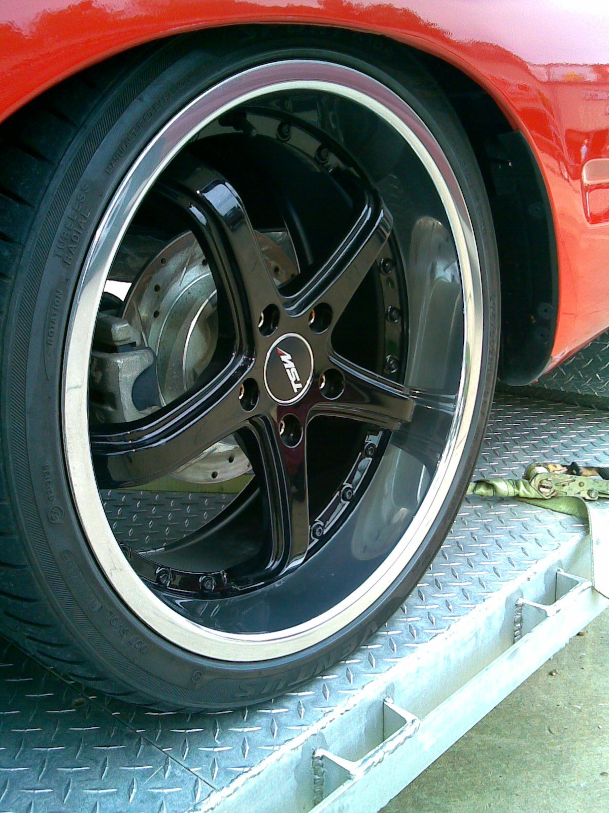

    You have to disconnect the brake lines, and parking brake stuff, remove 4 bolts from the housing flange, to pull the outer brake assembly and splined axle that fits into the ring gear in the center section.
    Yes you have to pull the axles to do a re-gear anyway, because the axles have to come out before you can unbolt the 3rd member and pull it out the front.
    Doing rear disc isnt hard, you remove the rear brake and axle assembly, remove the brakes and backing plate, and reinstall the axle assembly. There is a 4 bolt flange on the rear axle and there will be a bracket that mounts to these bolts in some fashion that will hold your new caliper. The brake discs will float on the studs and bore of the axle just like the front discs do. The caliper will mount to the bracket just like your front calipers bolt to the spindle. Physically mounting everything is not hard the hardest and trickiest part is the brake fluid.
    I studied this 15 years ago when i did my own rear disc conversion on a tacoma, so i am going off memory but someone here might be able to back me up with correct numbers.
    >In a front disc, rear drum configuration the front discs are getting +/- 1200psi of pressure to squeeze the calipers, yet the master cylinder is only sending +/- 500psi to the rear cylinder for the rear drums.
    >In a front disc, rear disc configuration the master cylinder is sending +/- 1200psi of pressure to the front and back calipers.
    When you have the master cylinder from a front disc, rear drum setup and you install rear discs, the rear calipers are simply not getting enough fluid flow to effectively squeeze the calipers to make them stop as effectively as it would if you had a vehicle with OEM disc front and rear and the master cylinder that flowed properly. This seems to be the most difficult swallow and to get right, spending $2500+ on rear disc conversion and they operate just barely better than stock drums.
    I had rear disc on my old truck, i used Honda Accord rear disc and calipers and a proportioning valve. It was a 2003 with ABS and i ended up hating all that crap under the hood so i switched out to an older master cylinder without ABS and ditched the ABS and split the front lines and used a proportioning valve to the rear.

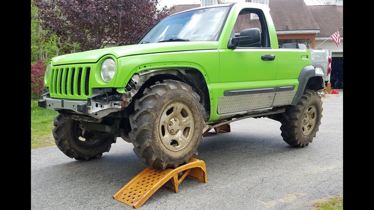

    For $106.01 I own a jeep liberty, woohoo pentastar

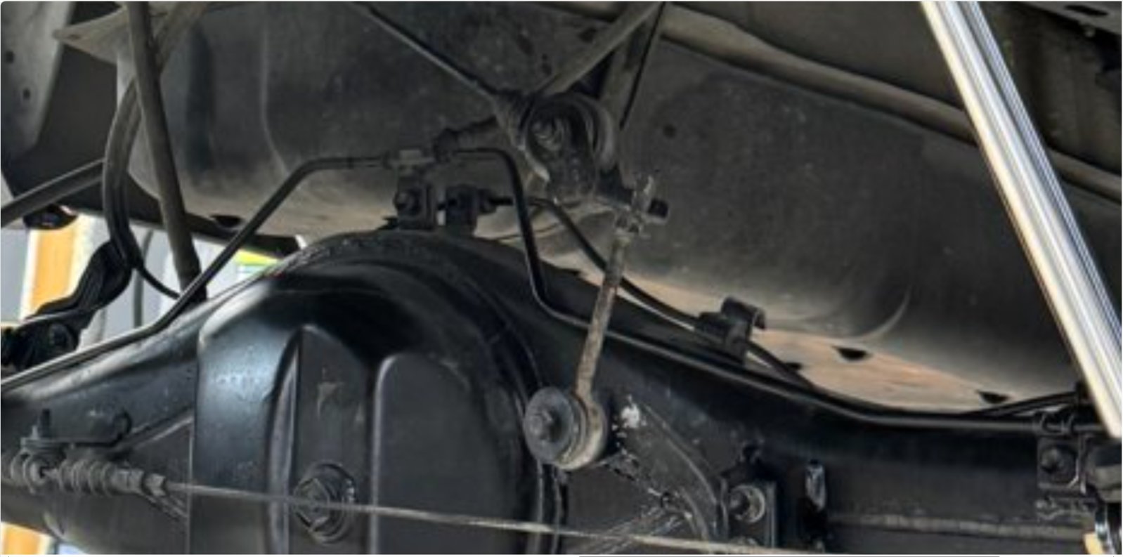

    Pretty sure the Sequoia and later model DC both have the wider rear axle, IIRC its 1" wider per side, so 2" wider overall.
    Also like i stated above, the master cylinder on rear disc vehicles is different, and sends more pressure to the rears and acts as a proportioning valve on its own. I think the rear is getting less pressure than the front, but its still like more than double of what a rear drum setup sees.

    My sister can attest to this bad rating although she was broadsided in my nephew’s Liberty at an intersection. It fucked up her leg with multiple fractures and lacerations. Luckily, she’s recuperated and is back to normal.

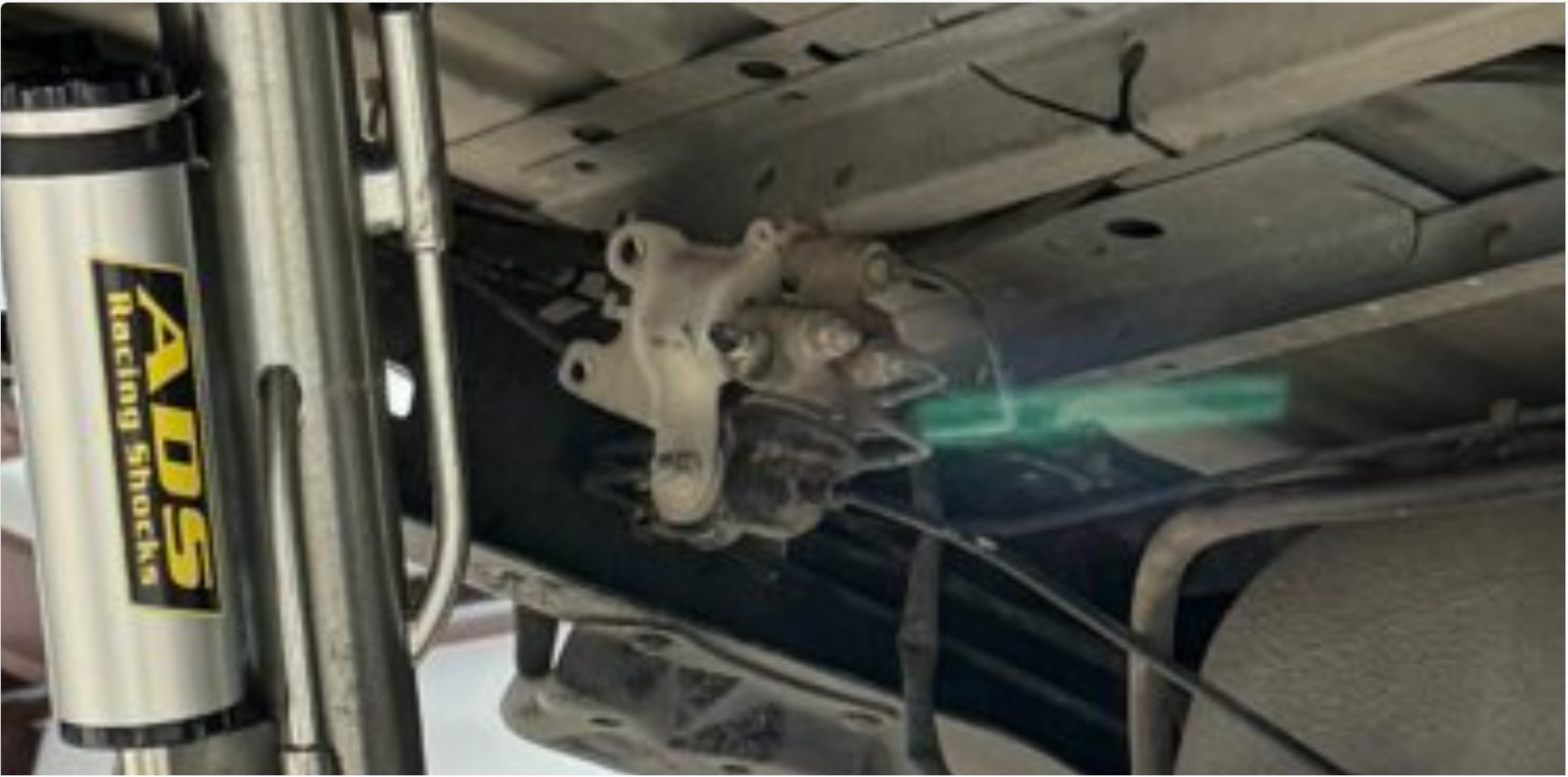

    So the primary headache with rear disk conversion is fluid, correct? Not the mechanics of the parts swapping, one adapter bracket and some wrenching and it’s done, then a lifetime of headache getting the fluid working right because it’s not designed that way?
    And, there is no way to say, have an inline hydraulic booster? Something like a relay that can double fluid movement via mechanical or electromechanical methods?

    2 motorcycle MC's: one with electric power & capable of an abs sensor, and the other for the rear axle, separately adjustable. And a small oil bathed ?puck brake? (Like riding mowers use) mounted to the tcase or axle pinion for a parking brake.

    swap out the master cylinder from a vehicle with rear discs like the Lexus GX or 4runner or sequoia

    So if it’s bolt on and this MC solves, why does everyone say it’s not worth it?

    I'm running a Sequoia MC with my rear discs; if I ever go to bigger brakes and the Sequoia MC seems to lack, I'd be interested in swapping over to a hydroboost setup.
    This website sells a hydroboost conversion for our trucks that taps into the power steering. The booster can be paired with either a rear disc or drum 1" Wilwood MC. Good info on the website in general. https://www.powerbrakeservice.net/hybrsyfor20t.html

    if you do a disc conversion kit, and master cylinder swap, and brake lines, you are going to spend 20 hours of time, $2800+ and have brakes that are +/- 20% better than properly working drums that come on the vehicle. Some report worse brakes than stock, this could be due to setup, bleeding, or still using OEM master cylinder for rear drums ect. This all together is likely why the general consensus is that its not worth it.
    Me personally, i like the look, but i dont want to spend that much time for such little gain. I dont necessarily care about the amount of the kits, i would most likely build it all myself and have far less invested in the kits, but the amount of time it takes for the amount of gain that most report is the main reason i have not done it and likely wont do it.

    You are correct. Only some DCs have dual rear brake lines. My 2006 DC only has the 1 rear softline. The VSC trucks have 2 rear softlines.
